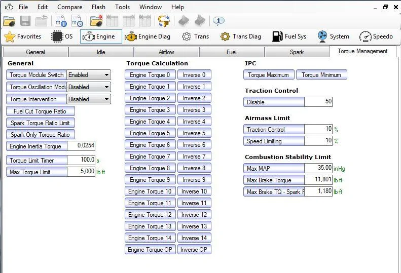

Are they able to make adjustments to the traction control?
In the 11-14's, there was an option in HPTuners to change it. The value of "50" was enabled. "0" was disabled. (pic below of a 2014)
In the S550's, this table isn't available. New programming and a lot of stuff is torque based. I am assuming that you need to really change a bunch of different tables.
I know reading a post somewhere that Lund has done it on their own shop S550's.

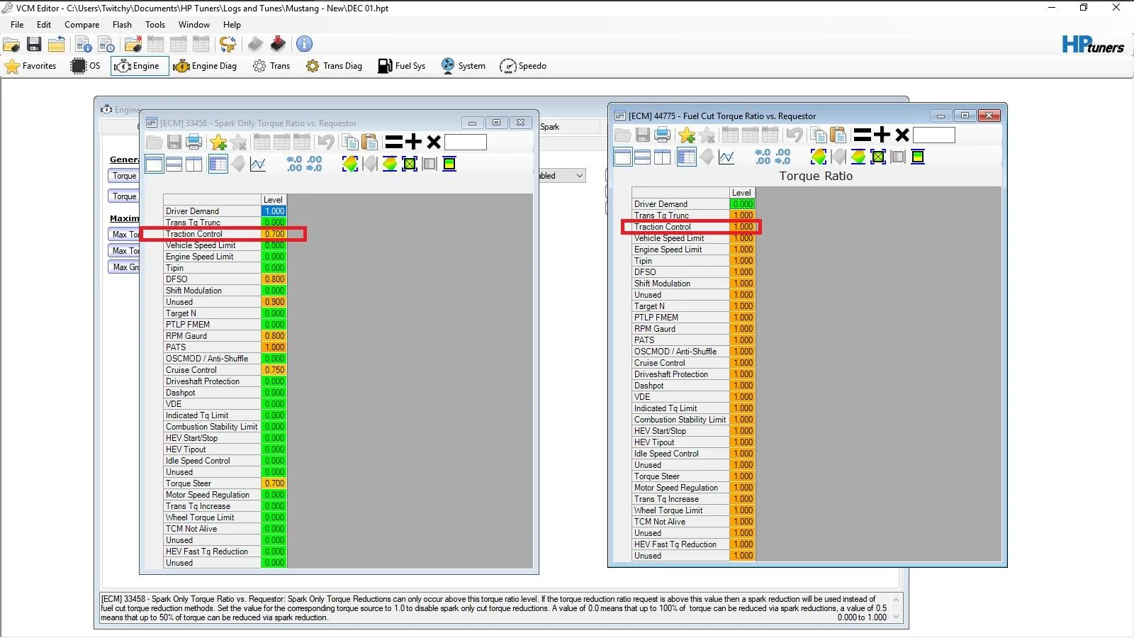

I bet the highlighted parts in the screenshot below are a great start to do some testing. I do believe that HP Tuners and SCT are able to unlock almost anything engine/transmission related that's written into the program by the Ford engineers. They continually add more tables as new things are unlocked.

I know there was a thread on this over at HPT, and if I remember right they did find that you could manipulate the traction control "effect" to an extent. I never tried it personally though.

I adjusted mine so a fuel cut would not lean out the engine, and aso gave it a bit less spark authority so it hits much softer. Before the car would fall on its face hard and it felt unsafe.
