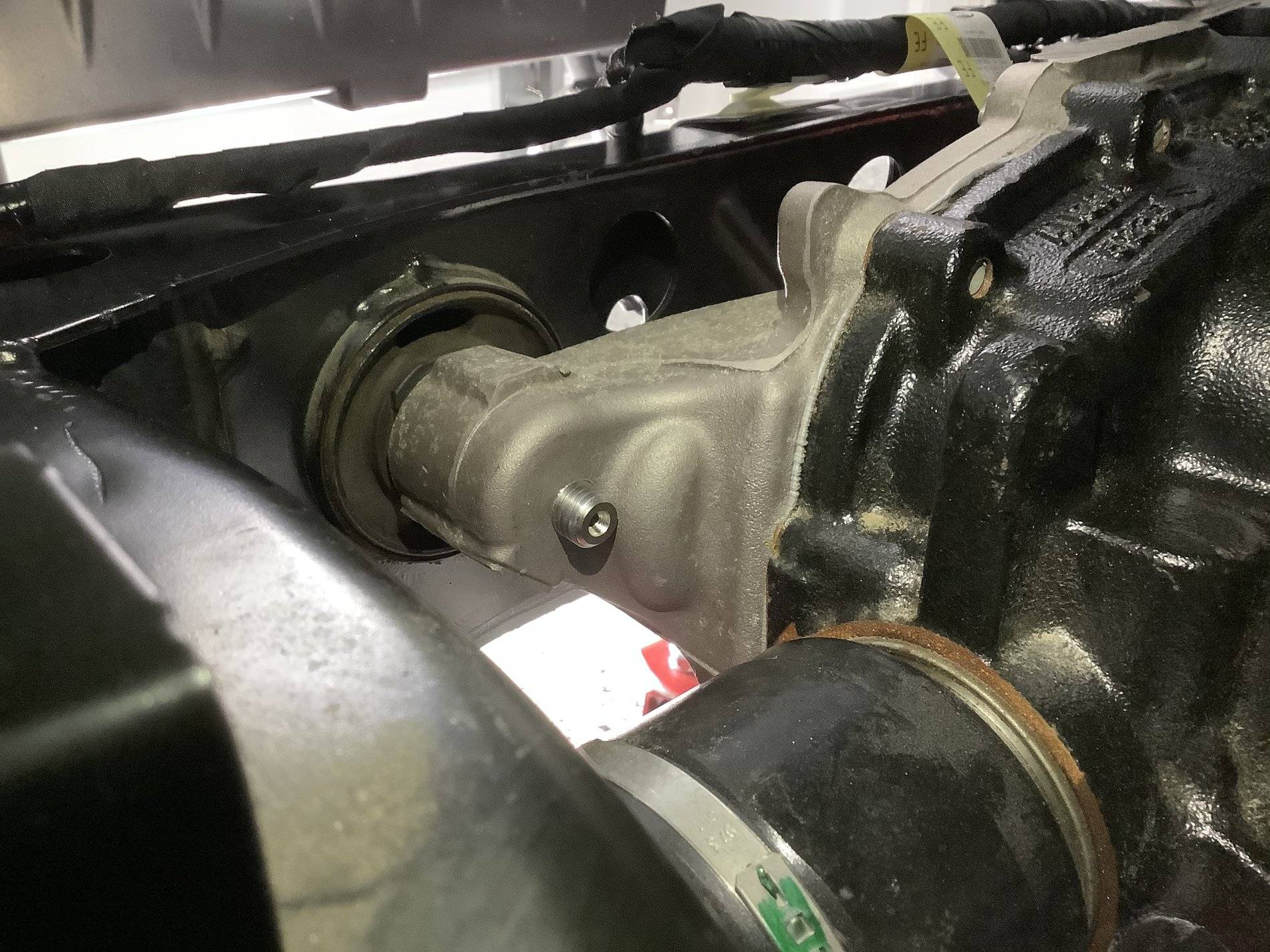

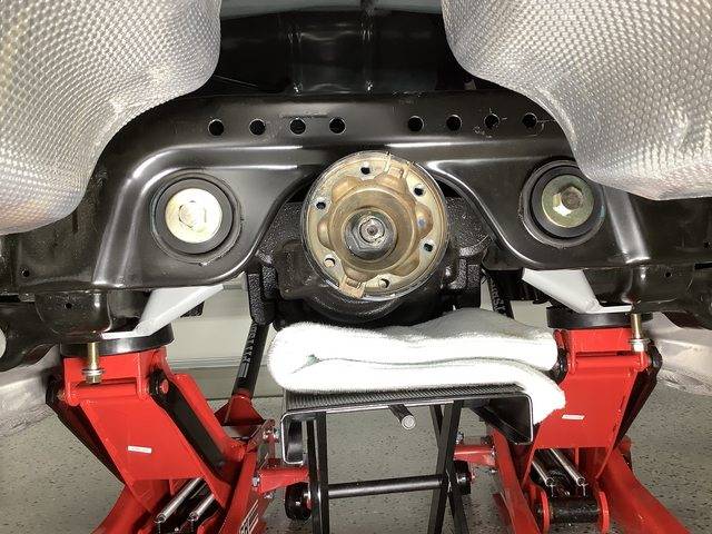

Looks like everyone here is recommending the puck-style inserts. Are you talking about full bushing replacements? I'm in the middle of that and I got the Steeda full differential bushings. After looking at pictures and the instructions, I suspect they are just the Whiteline KDT933's in a Steeda bag for a hefty markup. If you have the time to wait for a back-ordered part, I would suggest getting the Whitelines through another vendor since they are only around $60.

Time to drop the cradles for those installs, especially full replacement bushings Like the Whitelines. I dropped mine to do the puck style Steeda bushings. I couldn’t see any other way to get a proper torque on them without dropping it.
