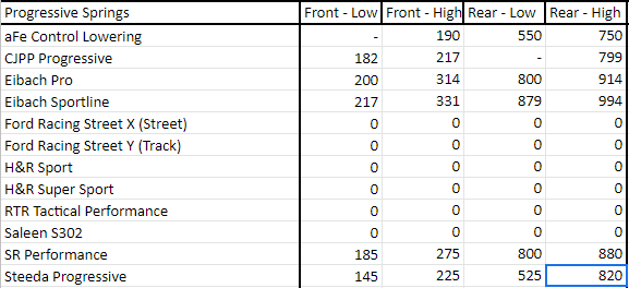

  • Spring type: Progressive? I assume this would allow some softness on lighter loads (street), but provide some extra support once you push it (spirited/track).
---Coilovers---
If I get just about any coilover, am I free to switch springs with any brand? Or am I more or less restricted to that brand?
For an idea of how I may like my springs, I do like the numbers for Steeda's Progressive Sport springs.

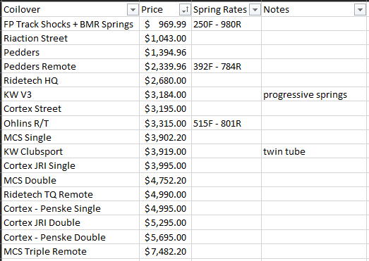

Funny, I had just put this list together the other day. Granted, I'm more focused on track use but it may still be of some use to you.
For reference, the first item is more or less identical to what comes on the GT350R.
If you want "softer" than OEM but still track-able, you're going to have a hard time. The OEM stuff feels like a boat. Perhaps magneride take-off parts could be an option for you. Otherwise, I would think Steeda coilovers might be a happy medium for you. Most of the items on my list above are going to be much stiffer than OEM.
Most of the higher price items are geared toward racing, so not what you want.
The cheaper kits are typically for folks wanting to get their cars as low as possible, so usually also very stiff. I think KW V3 would be decent for you, or Steeda, Ridetech, etc.
Or perhaps keep your OEM shocks and just get some stiffer sway bars. That way the suspension will still be soft over bumps but won't flop around like a wet noodle on track....though you'll still get horrendous nose dive under braking. Generally "comfy cruiser" and "track car" are on complete opposite ends of the spectrum.

Based on what you are looking for, I would definitely go with the Ohlins R&T and get them through Vorshlag or J&M as they will include camber plates as well as custom spring rates.
The Ohlins R&T kit uses an inverted shock for the front which is much stronger and stiffer. No other kit offers that besides the motorsport Penskes, DSC/Tractive and AST.
It is such a high quality damper for the money and you can get it to ride better than stock.

They seem too stiff. Looking for something a bit stiffer, if anything, over the 160 lb/in OEM. Maybe more in the 180~220 range, hence hoping for a progressive spring that may be able to handle that. I know some purchasing & "exterperimentation" would be needed on my part.
I know I need significantly rear softer springs in the rear as well. There are quite a lot of bumps I have to slow down for, only because the rear end feels like it kicked up like a horse (HAH) if I don't.

Been looking at the spring rates thread as well, and I've really been liking the SR Performance Fronts + Steeda Progressive rears. Are there any adjustable coilovers they can mix with? Hate there isn't some sort of standard.
If there truly are none, I may try to team with KW/ST, or some other brand out there that could help me design... "GT" suspension?
