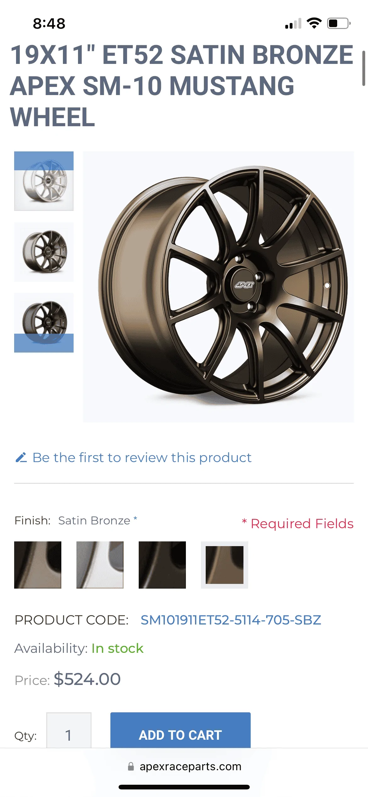

man, I remember when those wheels were 380. I would go 18". Cup2 don't last long and only reason to run them is if you're scoring them take-offs cheap.

No code needed for forum credit. And 19x11 SM-10 wheels were never $380 retail, maybe an intro sale price but they came out 4 years ago and were around $450-475 retail back when costs were normal. If things ever go back to that, we will lower retail prices. We've done it before.
