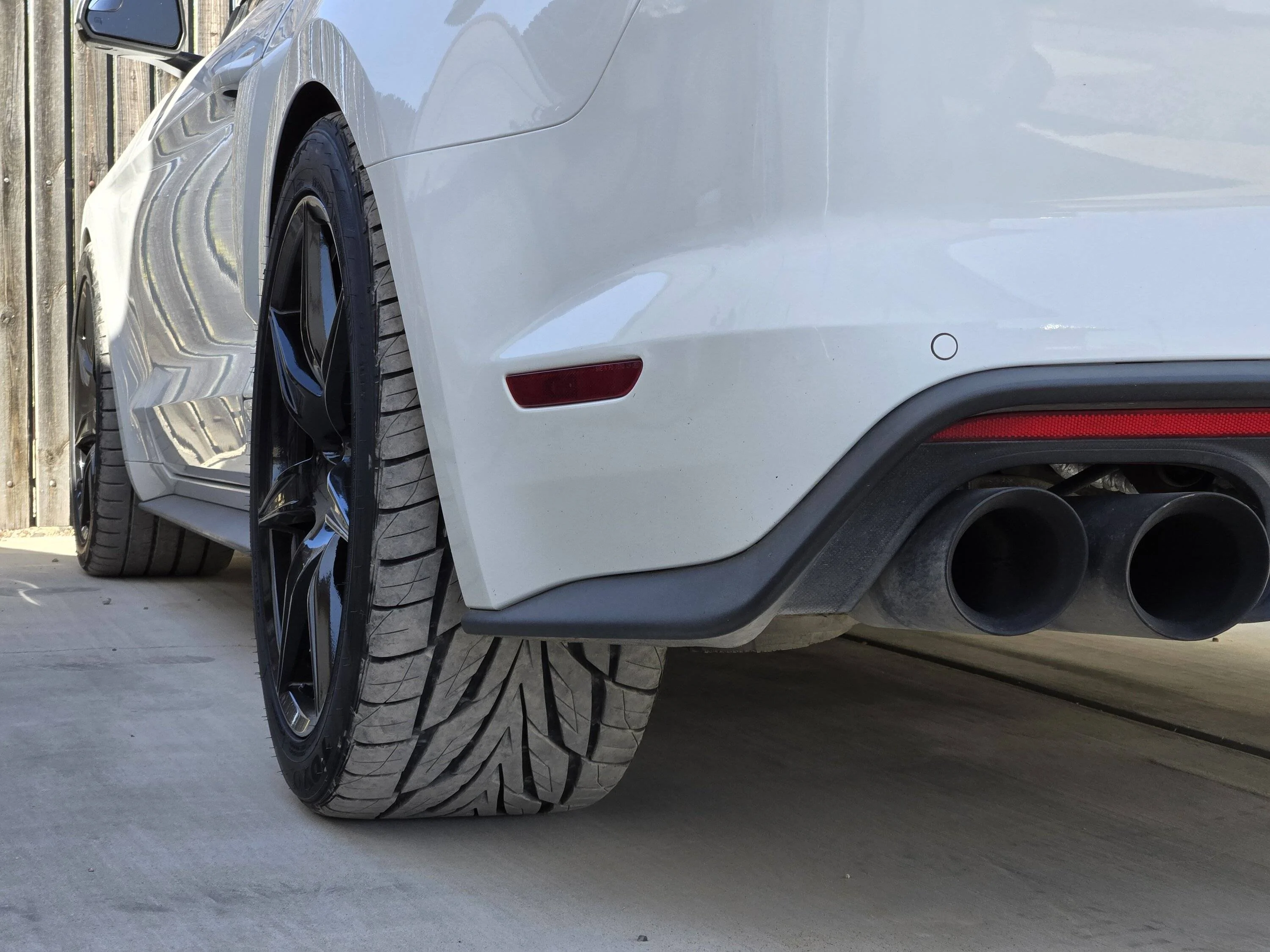

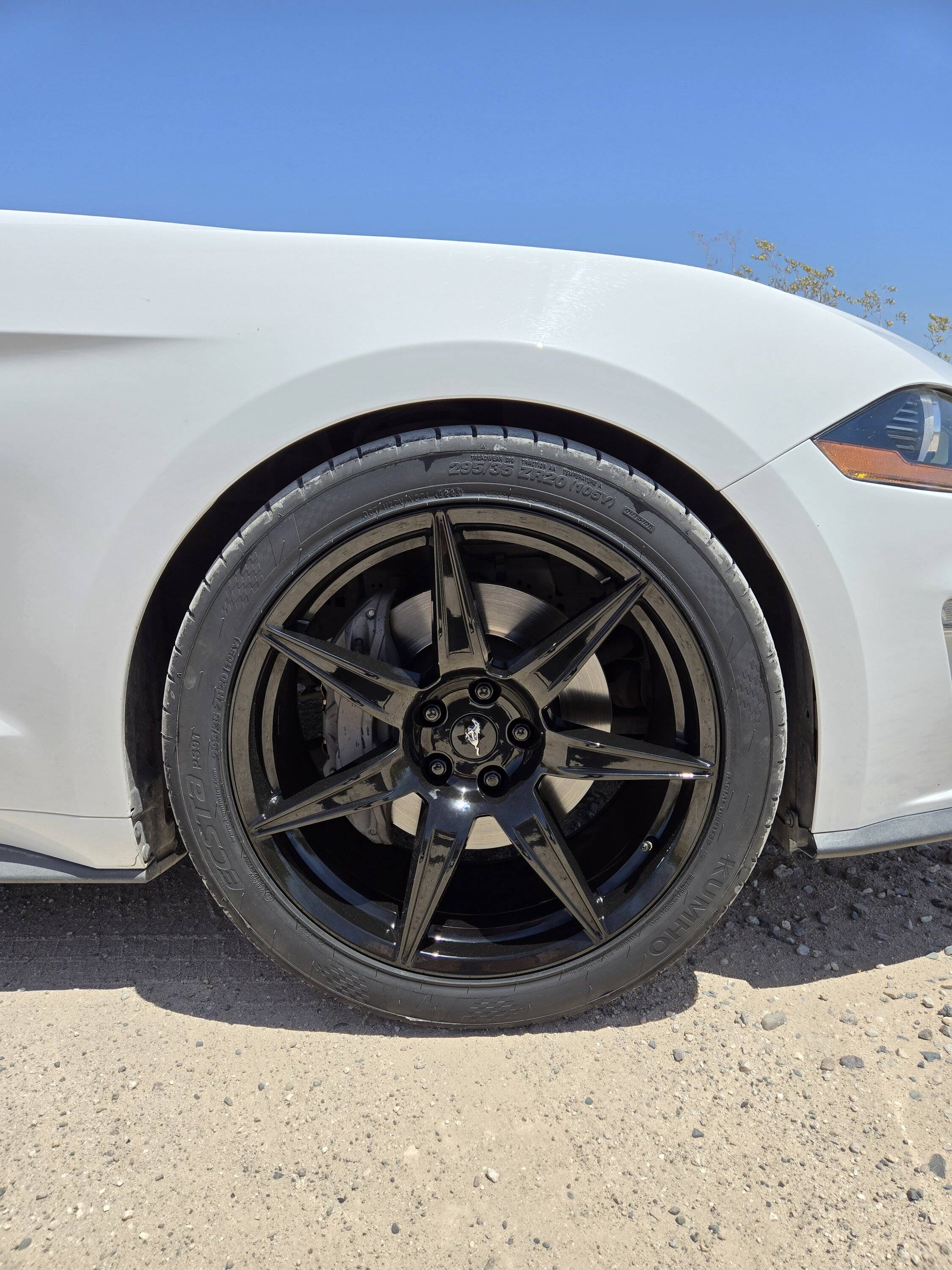

Stock 2019 GT Premium California Special that came with 19x8.5 wheels and 255/40/19s. Got a set of 20x10 +35 and 20x11 +50 wheels from Late Model Restoration https://lmr.com/item/WK-912062/sve-mustang-cfx-wheel-kit-20x10-11-gloss-black-15-22 and wrapped them with 295/35/20 in the front and 315/35/20 in the rear. Everywhere I looked said that was too big but I wanted some meats so....... The rears clear fine, the fronts barely rub if I'm turned and hit a bump like pulling into a gas station.

Depending on what the tires are rubbing on, you may be able to fix it with a camber adjustment.

The rub while turning is just the plastic fender well liners but once while going a little too fast on a bumpy road I heard THE rub, pretty sure it was the outer edge of the tire touching the top of the outer fenderwell so yeah some camber would help but then I don't want to wear the inside of the tires any faster. My dad would say "that's whatcha get for fuggin with it" haha

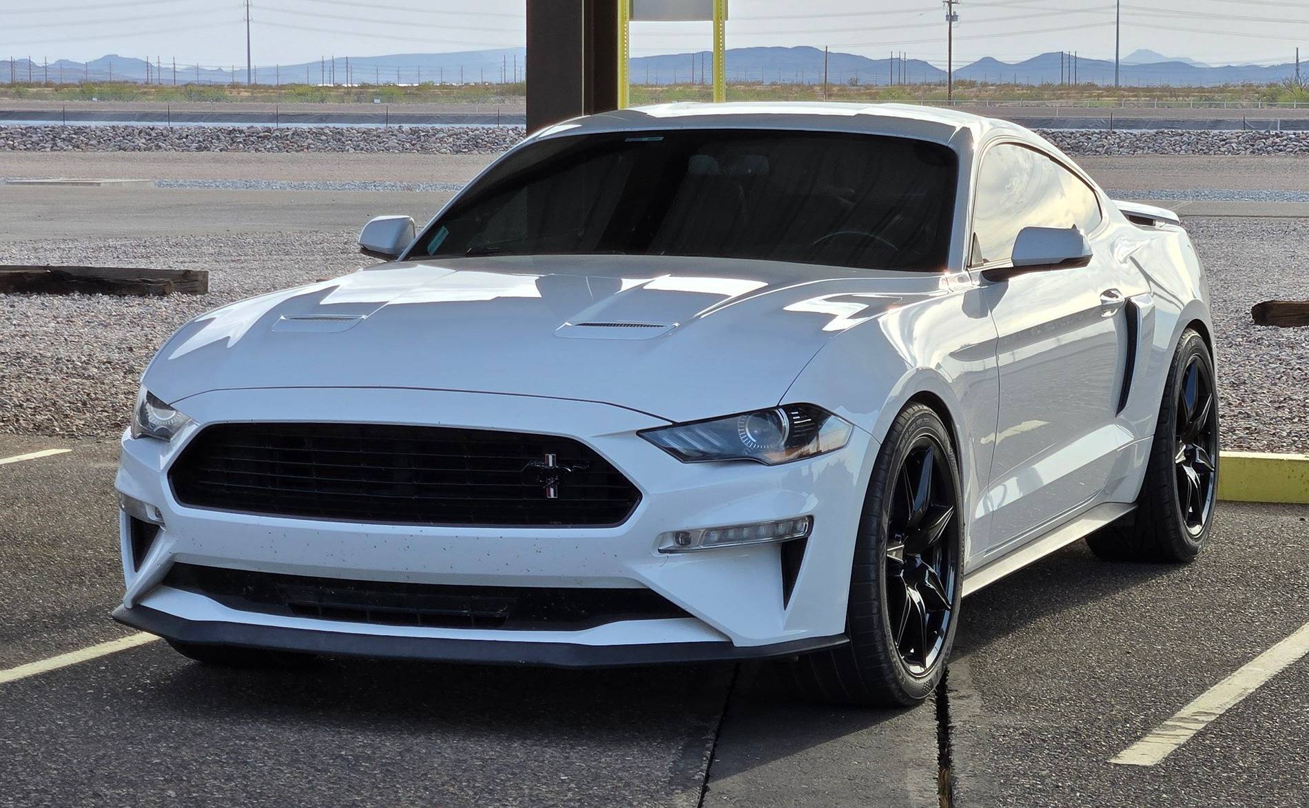

Just can't get over this flush with the fenderwell look and the wider stance. When I see one with stock wheels they just look so funny all tucked under the fenderwells by like an inch

No way, that's a hair under stock height, I like the taller than stock for some cushion. Next set I might go 285/35/20, they be a touch shorter and skinnier

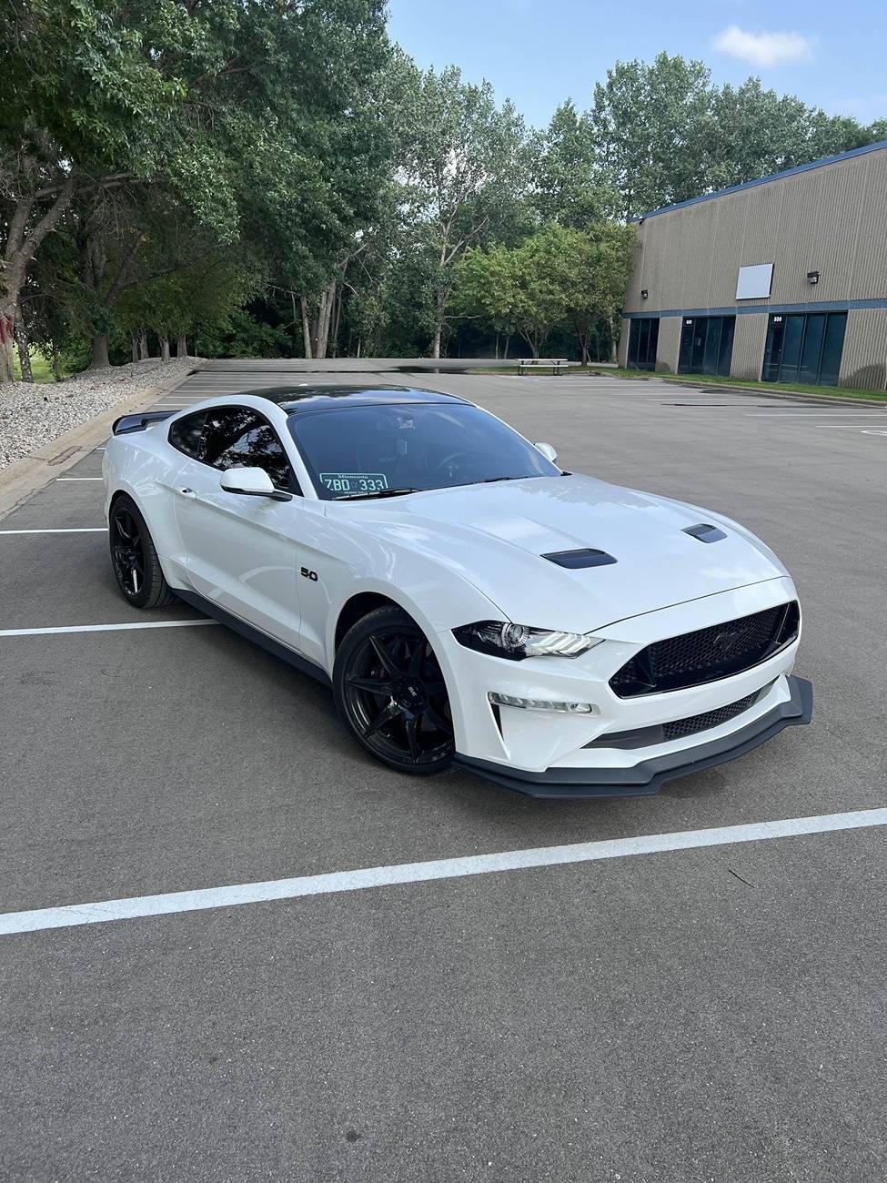

Here’s 285/35/20 all the way around on stock suspension as a visual for you

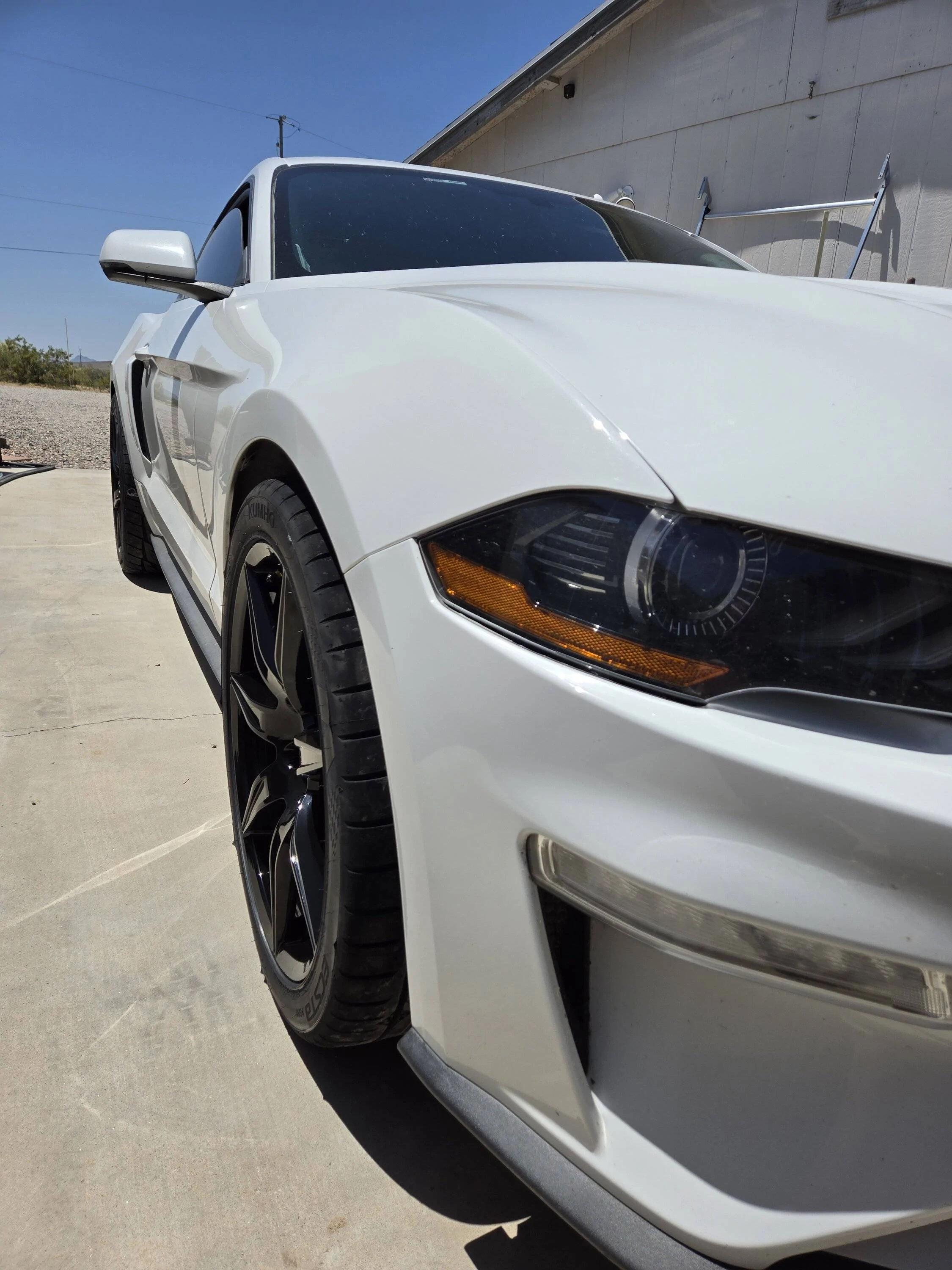

need a touch more front camber.
