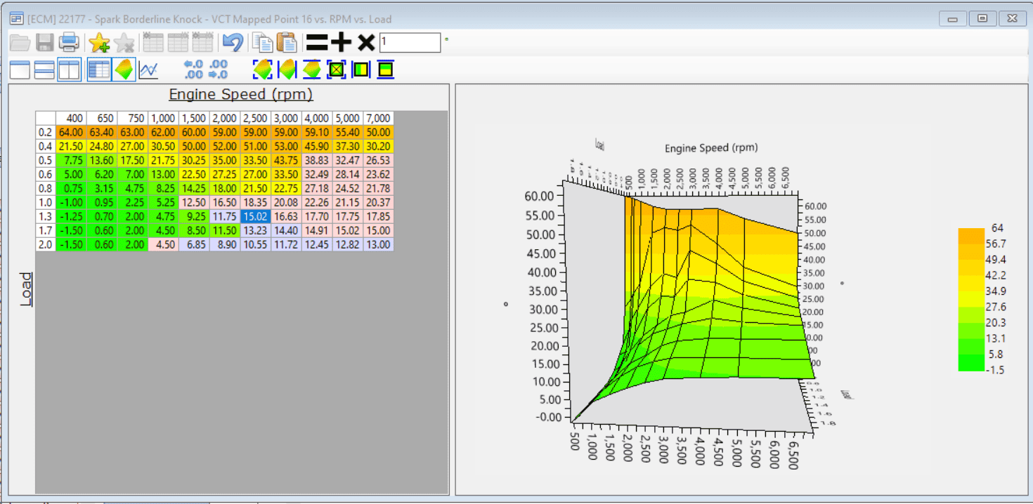

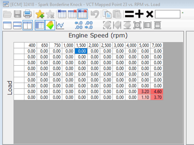

Back to the OPs setup. This is why i always recommend a reputable remote tuner vs most local tuners who are inexsperienced with these cars. Op sent me the read of the car and i see he has essentually stock timing maps in his boosted car from a previous tuner.
First of all the timing maps were not scaled for boost.
A stock timing map is based on load and rpm.
The load axis was stock so whether you make 1psi or 15 psi the timing would stay the same as the load axis was not scaled .
2. Cat over temp was disabled and he has stock cats. That will damage cats and can cost you a engine.
3. Power enrichment was set to .82-.83 lambda at wot which is too lean for these cars.
First picture is stock. Second is previous tuned timing map and 3rd is a comparison differnce between stock and previous tune.
All the Timing mapped points were done like mapped point 23 with only the last few cells adjusted a little

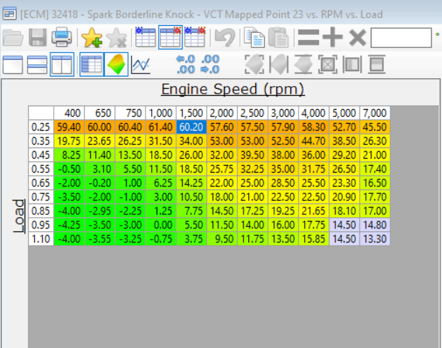

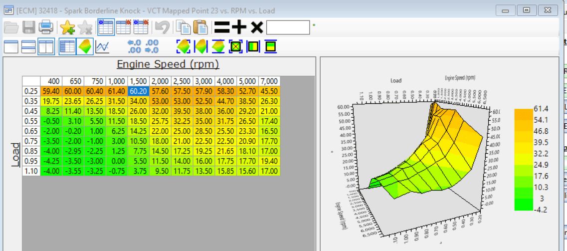

Here is something i just made really quickly. This is not our tune and was only made for this thread
and allows you to referance what i am talking about.
At 1.0 load (like na) you will see its set to around 21 at WOT.
We dont want that much timing under boost so we can set 1.0 load to be close to NA cars timing and continue dropping off as Load/boost increases.
We wouldnt want 1.0 load to be the last cell of the load axis. Any boost whether 1psi or 20 would run off the last cell and would not ramp down the timing. Timing would stay the same.
As load goes up (more boost) timing continues to adjust since the load is scaled.
This keeps us within the timing table vs hitting the last remaning table on the load axis and having no timing adjustments for increased load.
