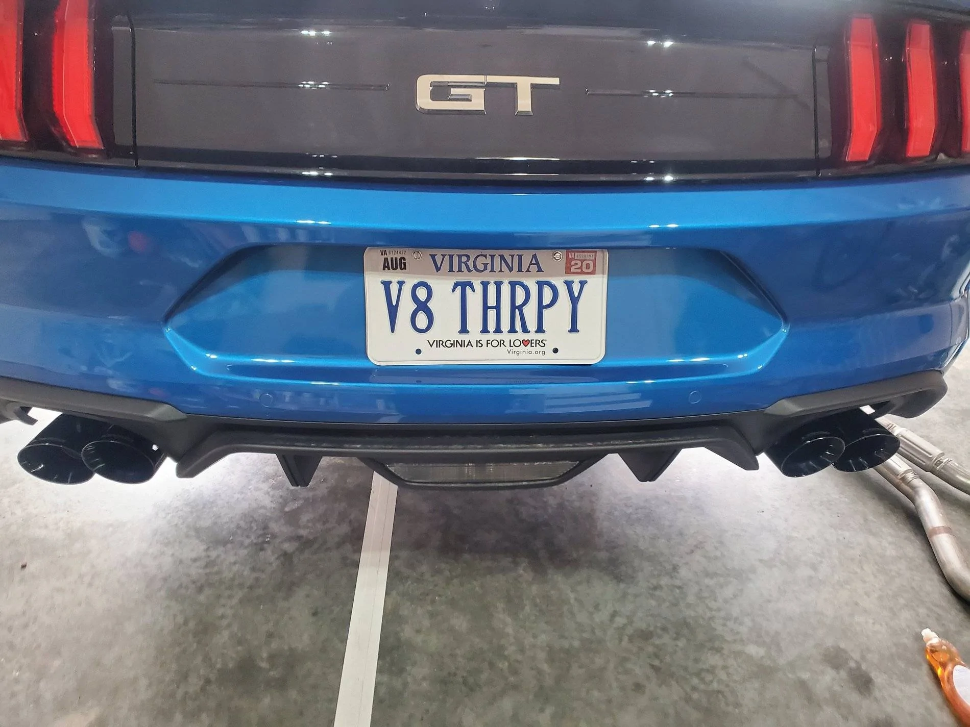

Well I through her up on jack stands and did the job my self. It was a bitch to do alone but I managed it. I love the sound. Might need some assistance making fitment adjustments, for some reason the outside tips seem a bit low but could not achieve any rotation to raise up that side. For now though it fits and is consistent on both sides.
Good job the driver side tips do might need some adjustments.

Clamp position does not have enough tension to keep the pipe from rotating inside the slip fit. Take a rubber mallet and tap it into a tight fit deep inside the slip joint when you have them oriented correctly
