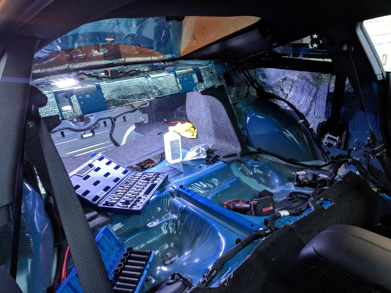

Car is a mess.
Take your time and be sure to locate the holes to drill very carefully. Brake lines and fuel lines below. Very little tolerance forward to rear (of the horizontal beam) to set the holes for support bars.
Another bit of advice, don't lean into the trunk and put your weight on the rear bumper. You don't want to induce sag.
Best of luck.

The seats were not much of an issue, the roll hoop went in and out without issue. The issue I had with my install was that there wasn't much play in the roll cage (main hoop) placement. The rear supports have to be drilled spot on and placed correctly (reference forward and aft of the beam) and there are no do overs. I used all play that was built into the main hoop bolt holes.
Despite these cars being built by robots, there is a bit of variations in tolerances and it may or may not affect the install.

I ran into the same... With the main hoop bolted in, my rear bar placement was about an inch off on the passenger side. (Driver side was spot on.)
So I loosened up the main hoop, bolted my rear bars into the main hoop and marked the drill holes.
I used the 3 piece rear seat delete instead of cutting up the stock 1 piece. (Mostly because I didn't want to unbolt the rear bars again.

That's exactly what I did. My caution to the op was how critical the rear support bolt hole locations are. I took my time and before doing anything permanent, I tripple checked it.
