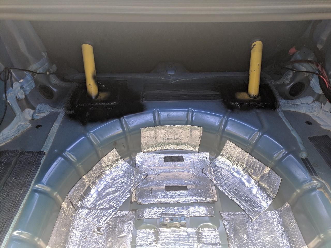

Unfortunately my mistake was I made the measurements while the 3 bolts were loose. Now my holes are off half an inch lol.
Grinding everything down to get it welded.

$200 later got the rear legs welded in.

Question,
Having the legs bolted or welded to the sheet metal, does it impact the safety? Sheet metal is weak so how does it work if the car tips over and the sheet metal rips away?

The the rear supports are located over a horizontal beam. That beam is the strongest part of the rear trunk area and when attached to the legs via bolts or a weld, support the main hoop structure. The two combined prevent crushing (The roof crushing down on your head).
Did you notice how many welds occurred along that beam that the rear support legs rest upon? Those rear support legs are not going anywhere. In all honesty, welding those in is actually much stronger than bolting the legs in (provided the welds are done correctly).
The reason they offer bolts is so that the support legs and main hoop can be removed if need be. Your installation is permanent.

Ok now I understand. The weld really good. The welder actually went all around the legs. Thank you
