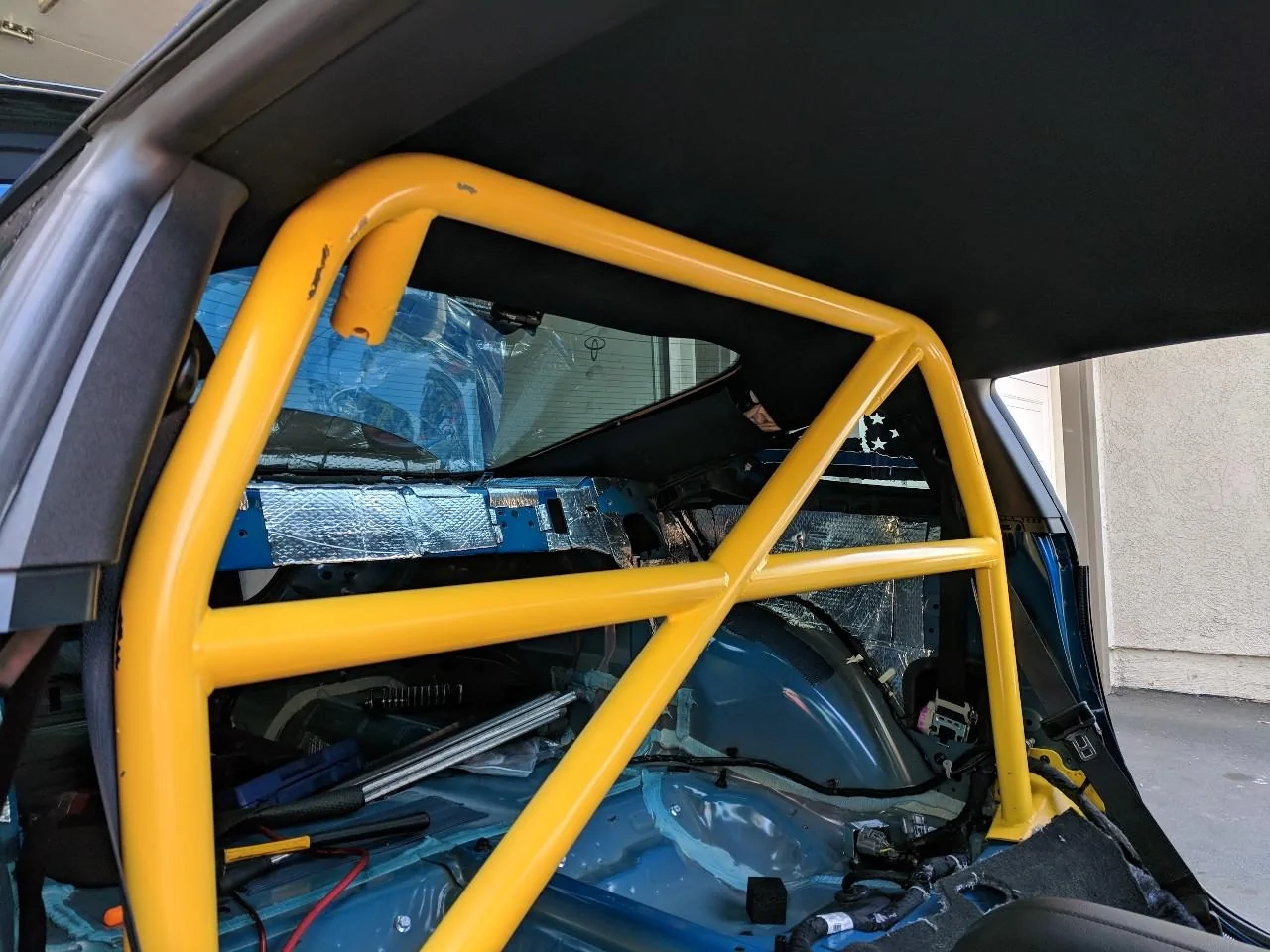

For some reason I can get the roll cage in. I am going from the driver side but it won't go into place. The passenger side fits but the driver side doesn't.

Have a look at my install thread. It's tight but will fit

I got in after destroying the paint. This is was really hard task to do it by myself with no help.

I hear ya man. I did mine myself as well. I wrapped mine in towels.

Yeah it happens. I should of got it poweder coated but is ok. I will touch it up and wet sand it smooth.

You'll be fine, do an air brush touch up or go to your automotive paint supply and have it put in paint cans and use a shop vac to take up the overspray.

I am in process of bolting everything in and for the love of God I cant get the driver side leg into the cage. What am I doing wrong?

Ok I got it in. Finishing up tomorrow.
