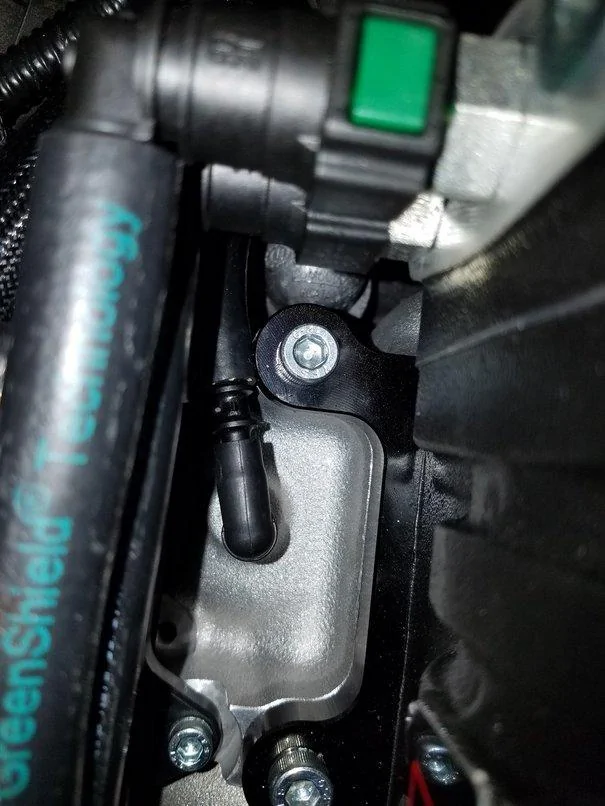

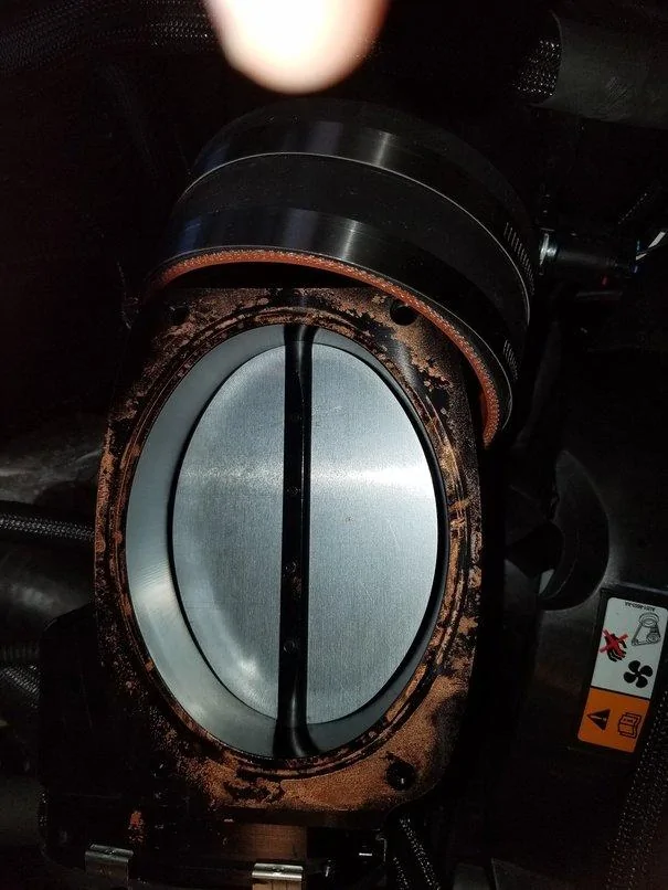

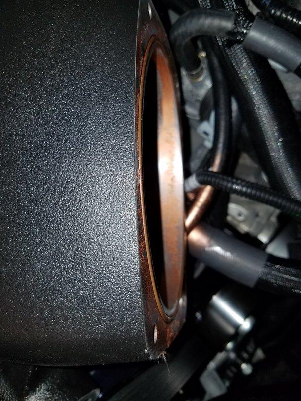

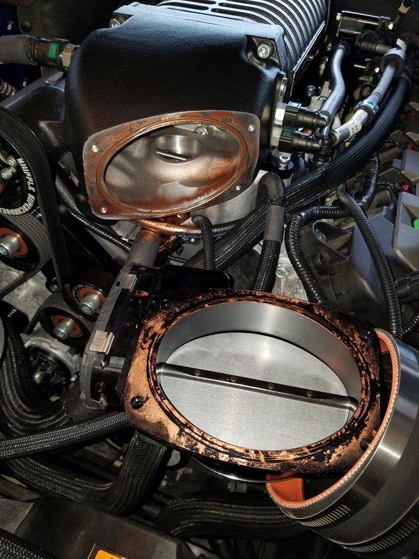

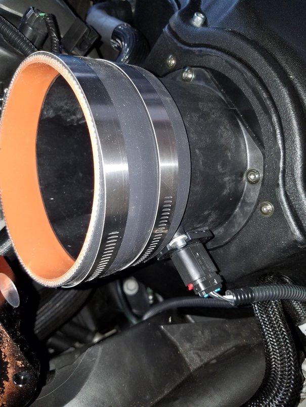

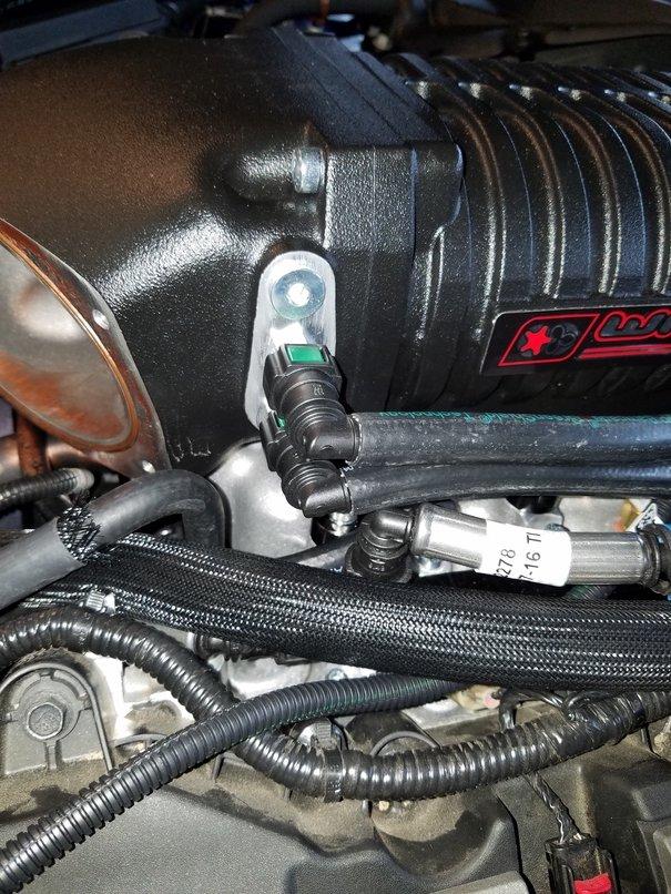

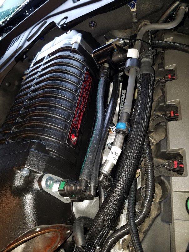

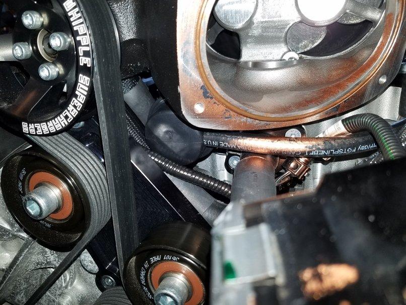

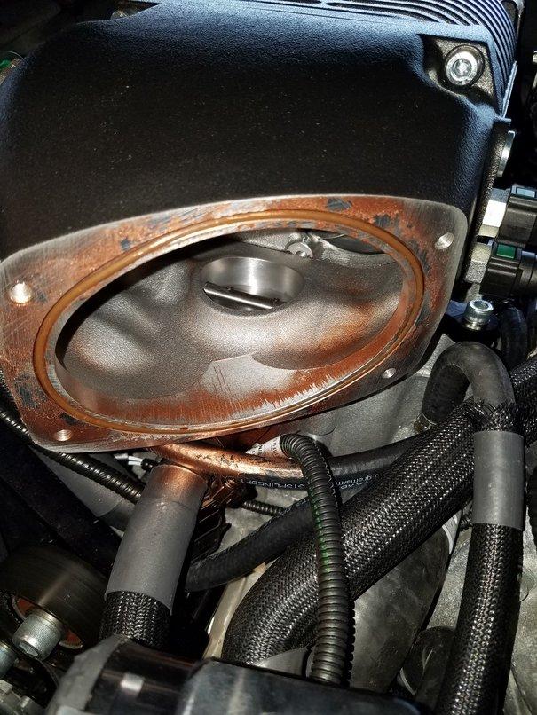

Ok. Again, I am no mechanic, but extremely mechanical. I took some shots. Wanted ot know of anything else I should do before putting it back together. I checked all of the above. Everything seemed correct. Not sure what that goldish spray crap is. Almost like they used a sealant on the TB it is very tacky and thin. You can see it got on the hoses below a little. Maybe one of you know better.

Not sure why orientation of pics got lost in translation here, but the MAF is in the correct orientation.

Clean the copper gasket shit off. No one puts a gasket coating where there is a o-ring. The shop is not as competent as you may think. If you are getting high idle it is I am almost 100% you have a vacuum leak. It's most likely the front of the blower forward to cause a high idle.

I can't believe they hoped anti seize copper all over that, really sloppy work.

Damn, well I may go back to them and tell them to clean that crap off. I ran the car all around that since reassembling. I dont think the leak is from there though.

These guys probably put that copper gasket between lower manifold and heads. If they did that and didn't use the rubber o-rings, it will definitely leak vacuum and boost.

No copper anywhere else. He said he didn't want to use silicon on that o ring. It wouldn't stay in place so he used that..... I know, bad excuse. He guaranteed it is nowhere else though. I guess this smoke test will tell the tale.... I will post later when that is done. Thanks again everyone for all of your help so far. I'm definitely about to lose it.
