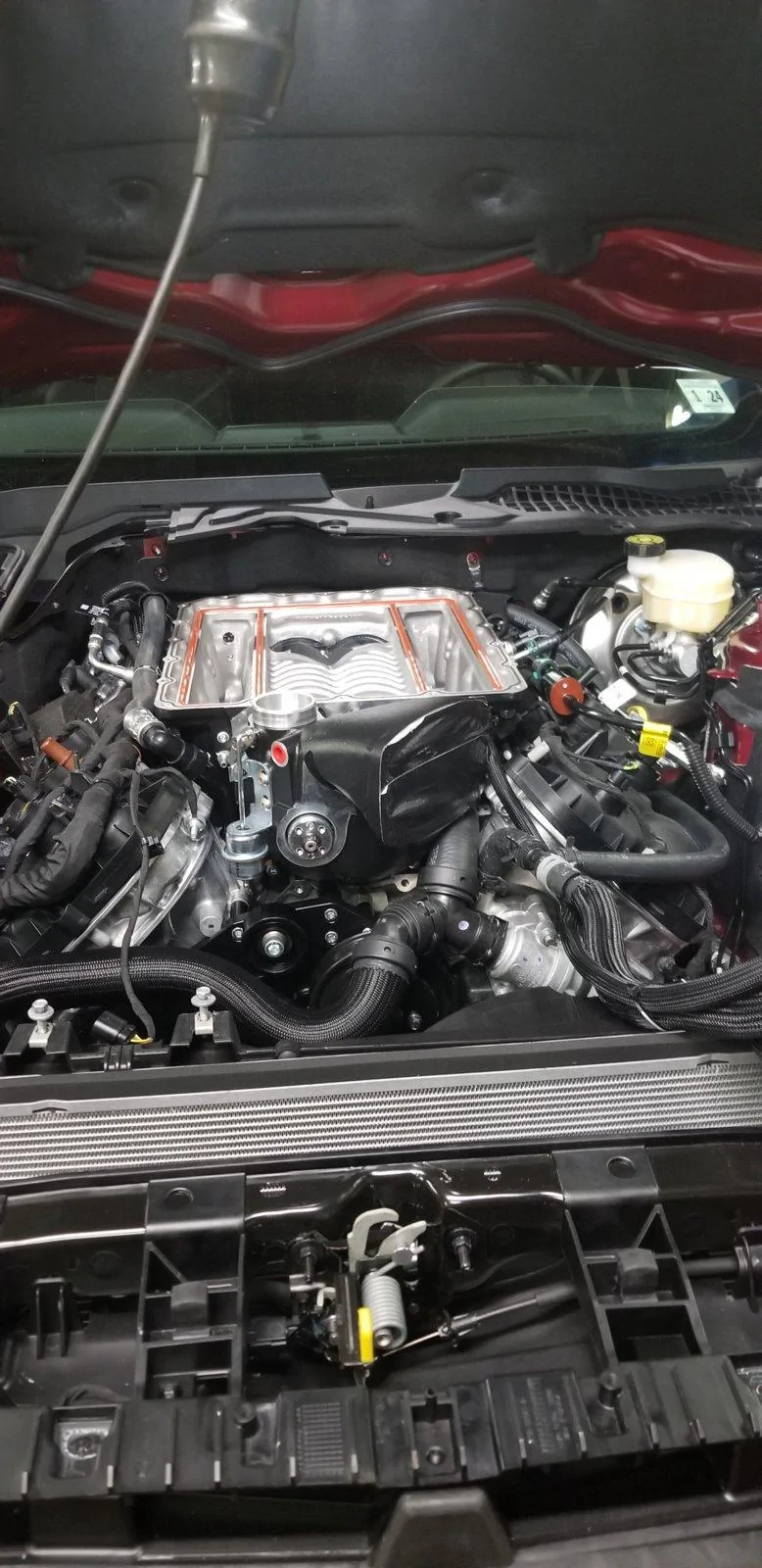

Finally!!!! My car car was ordered 10/20 came in 1/31. Had my whipple sitting in the garage for about 3 months waiting. Put a 115 miles on her and said F%#k lol. Just finished the install. First start up.

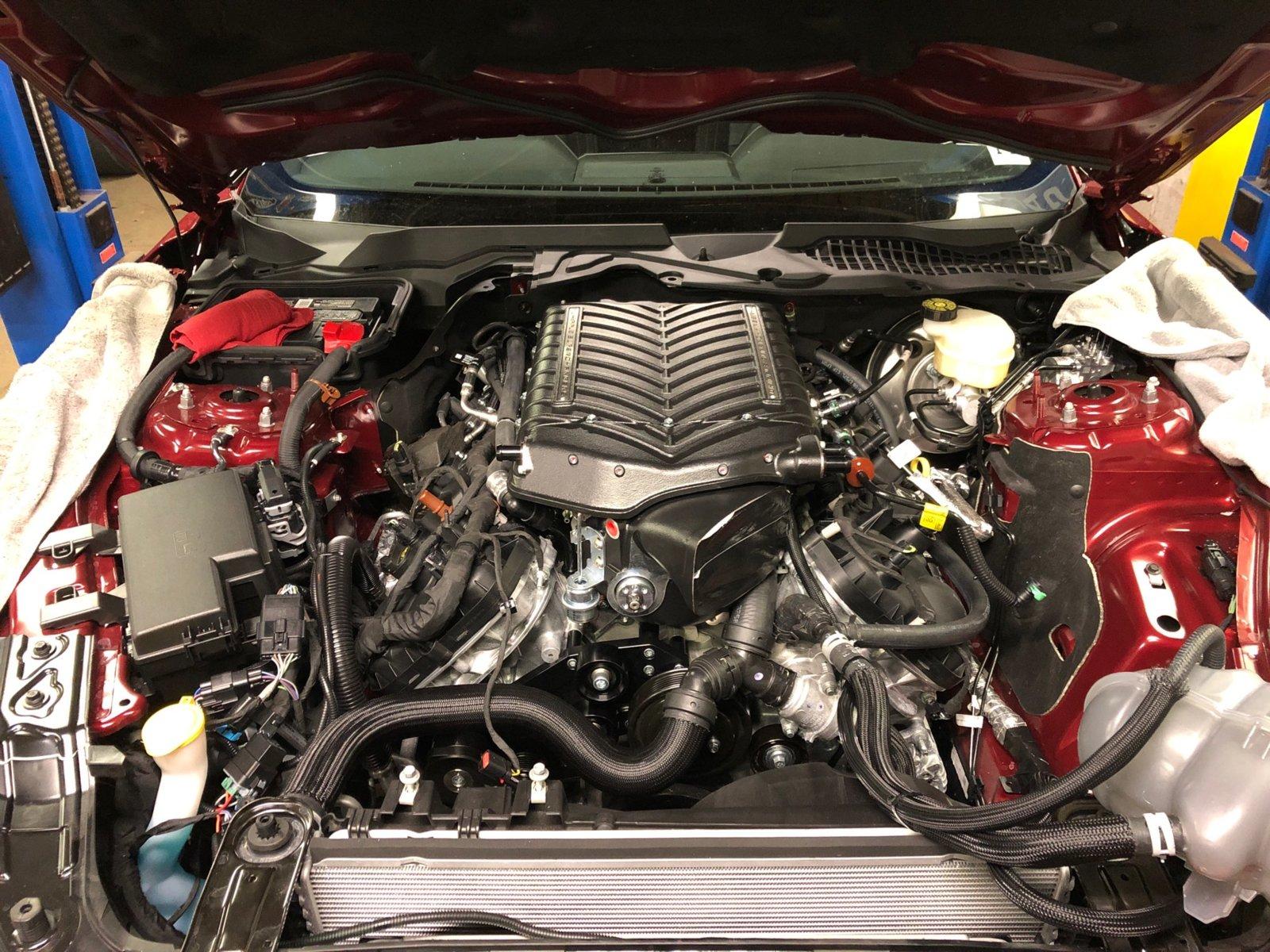

Wow. ! Hopefully someone at Whipple is reading this and going oops!
But congrats on the Whipple. Looks nice n clean in there.
