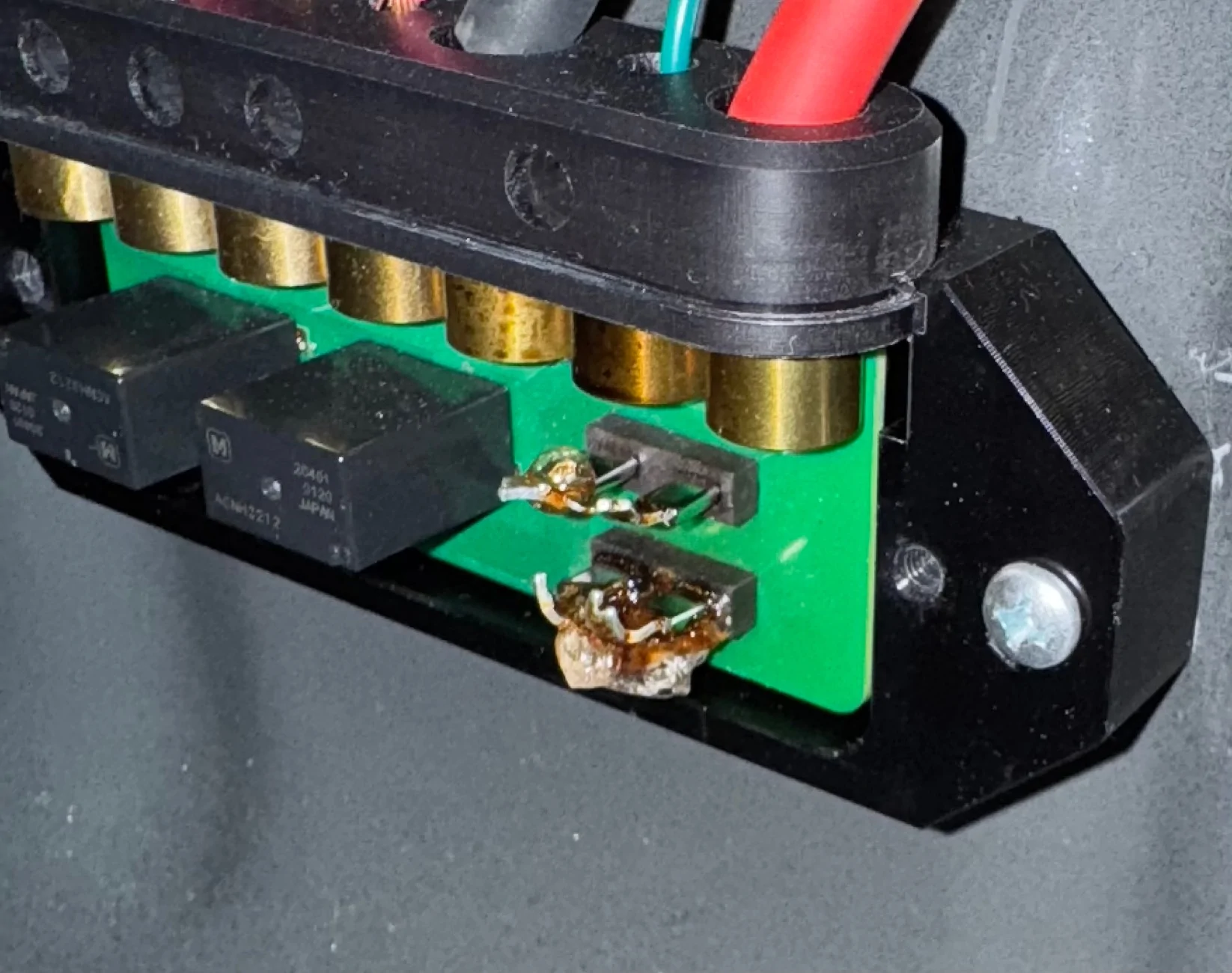

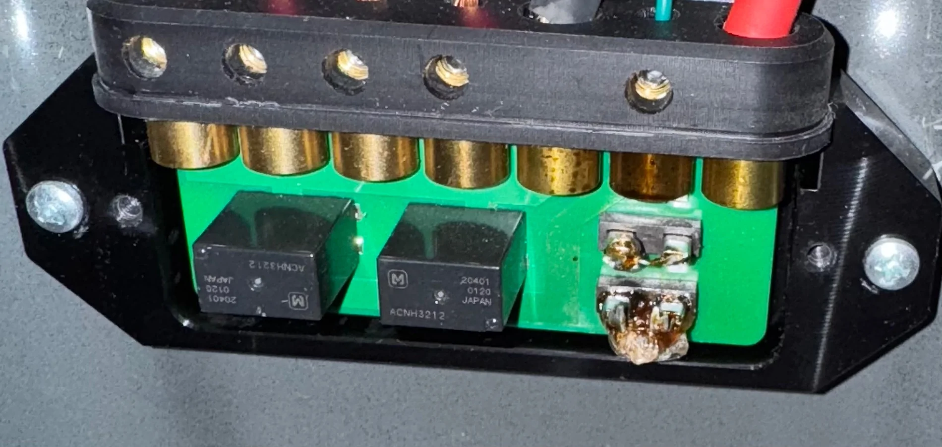

I ordered a new fuel filter and pre filter socks for my pumps today.. figured it wouldn’t hurt to change them out… then I went outside and was looking things over because of the long cranking times I’ve been having lately after not having any issues for 2 years now… I opened my FC2 unit and found these fuses melted down. No idea if any of this is related or not, but I pulled that shit out, cleaned it up and put new fuses in. I tested both pumps prior to looking at this unit and both pumps were working fine.
