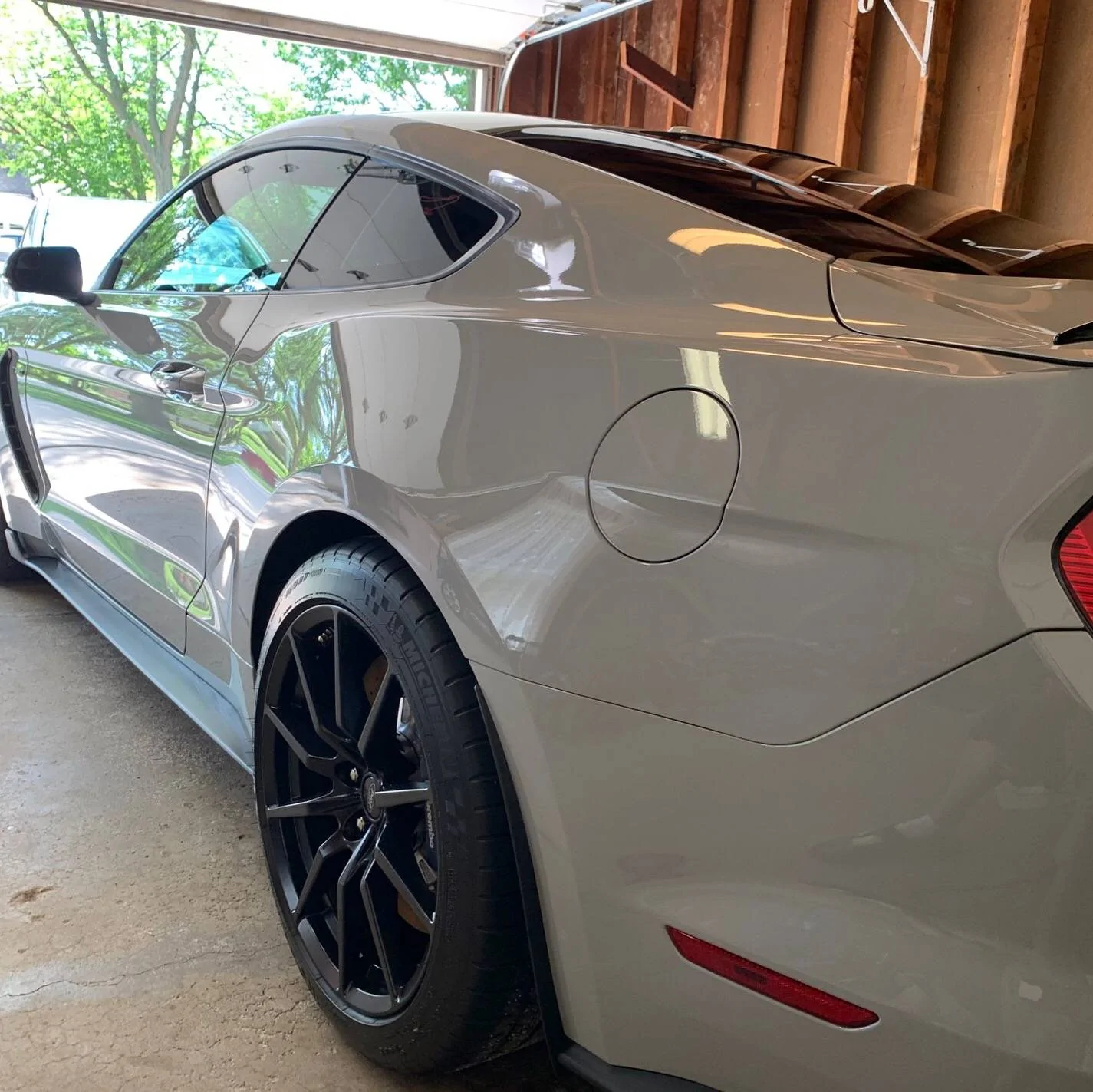

My car got stuck in the rain while I had a repair man working in the garage on the water heater. Looks like I have some water spots on the stripes that won’t come off. I have a coat of wax on the stripes too. Any other way I can protect against this happening again?

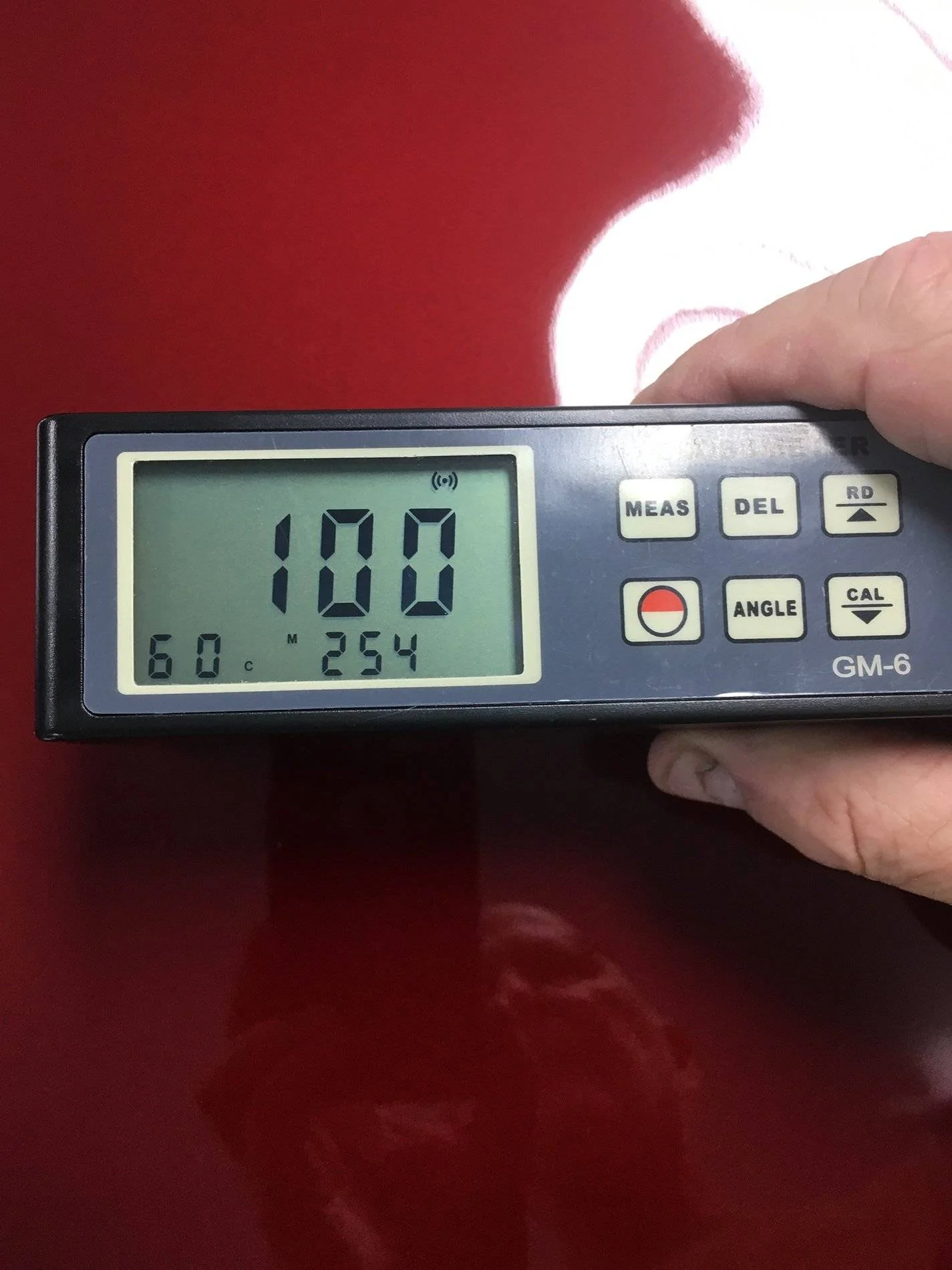

McKee’s Jeweling Wax will remove water stops, scratches, scuffs dullness from stripes and paint. One of my favorite products to make paint and stripes POP! It takes shine to another level! Gloss Meter shows the real results!
