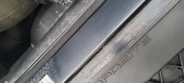

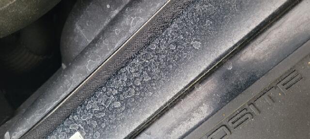

The water where i live is extremely hard and if you're not super anal about keeping your glass clean, spots will start to multiply. I accidentally stumbled upon using Mequiar's polishing compound after getting it on the glass and wiping it off. I noticed it took the water spots with it and have used that to get stubborn water spots off since then. Today, searching the net, i found a guy saying to try Bar Keepers Friend.
Turns out, any friend of a Bar Keeper is now a friend of mine! Stuff works like a charm. For shits and giggles, i wiped it across the radiator shroud and my oxidized windshield wiper arms.
This is a single wipe. I didn't spend a lot of time tonight on the glass, but i'd say there's about a 95% improvement already.
