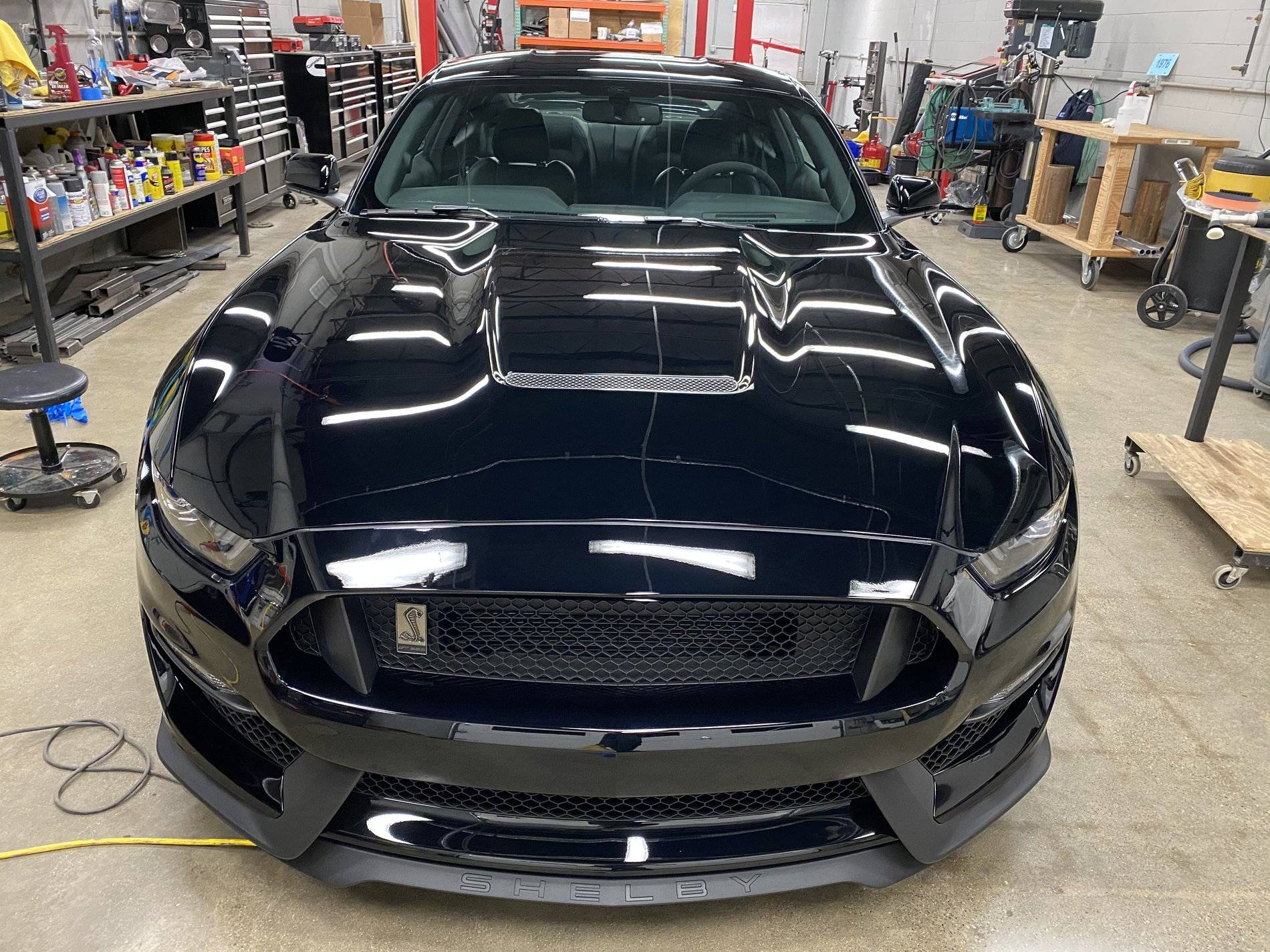

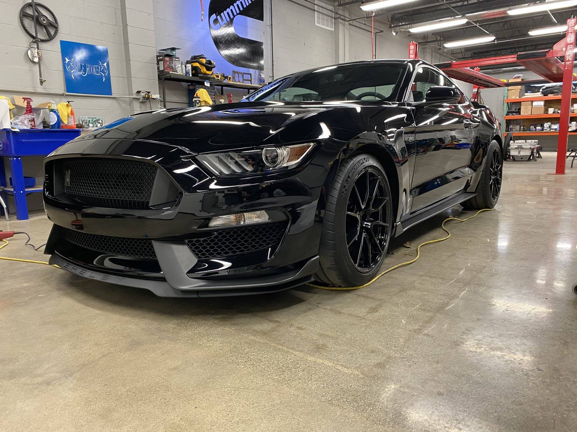

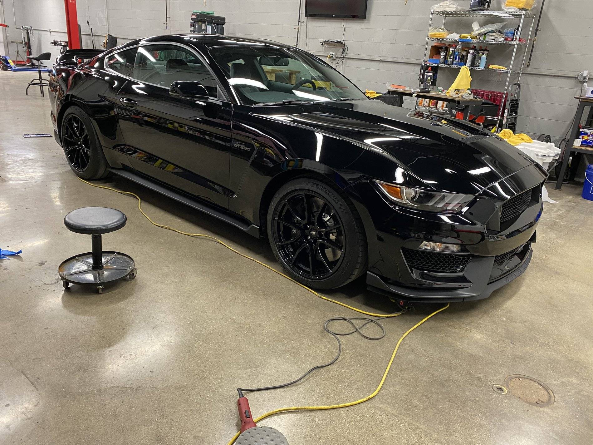

Here’s a great example of what I’m talking about. These pictures were taken after I paint corrected my mustang, before having ppf done. I had about 16 hours of work wrapped up in this car, and it only had 130 miles on it at this point.
Within a day of finishing the work, I had a friend ask what kind of wax I was using because it looked so good and he wanted to use the same product.
A car enthusiast I met through a friend asked me who did the ceramic coat on this car because he said it came out better than the one on his GT3 RS and he wanted to have it redone by “my guy.”
Both people were shocked when I told them there was nothing on this paint. No ceramic coating, no wax, nothing. In prep for the PPF I wet sanded the clear, then polished with 3 different grits, then gave it two alcohol wipe downs to remove any and all waxes/polishes/oils.
As a side note, the total paint thickness on the Gt350 is super thin and I don’t recommend people polishing with anything very aggressive to avoid going through the clear coat. I forget the exact mil thickness, but it was roughly half of three other cars I tested at the same time. Beware!
