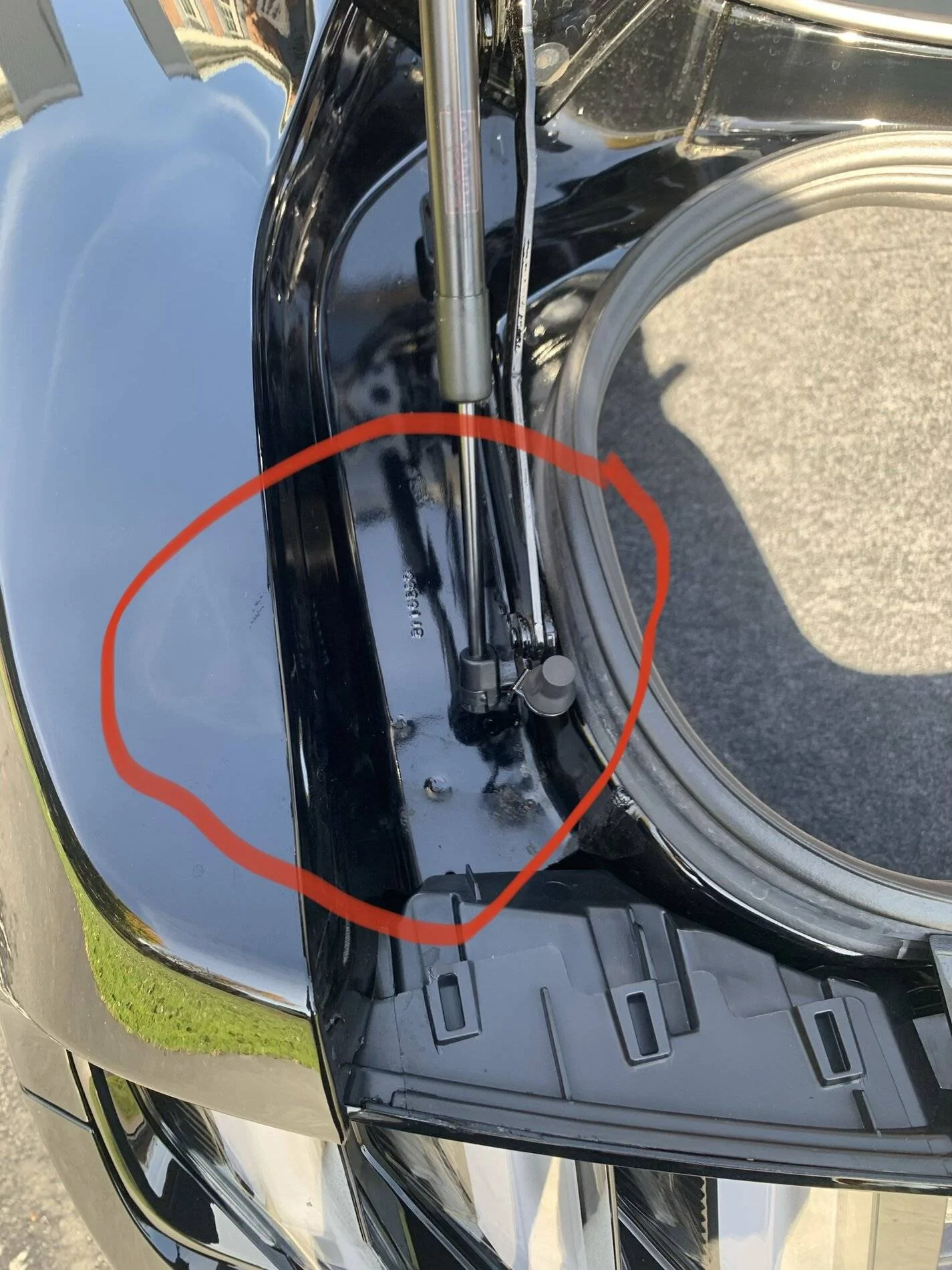

I just washed my car and noticed some water/suds pooling in the trunk lip (right where it meets with plastic from top of the brake light assembly). Is there a drain hole under there? I couldn’t locate it after taking the top piece of plastic off. Seems just like the assembly light under it.
I’m not getting any water inside the trunk but I haven’t really looked into it. Maybe it was the pressure washer that pushed it into corners. I don’t really drive it in rain to tell.

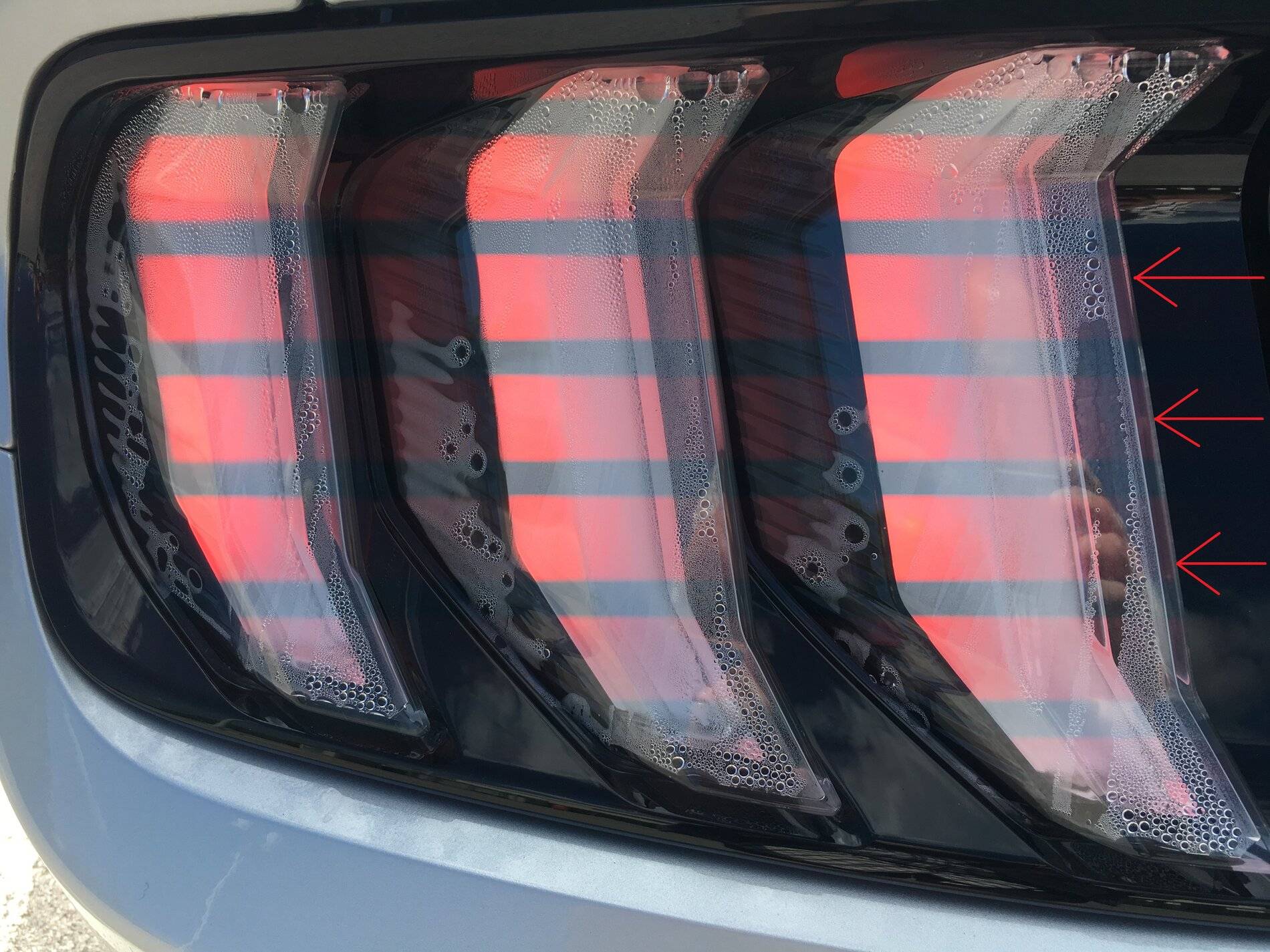

Lol. Thanks guys. I only asked since I noticed my euro lights had some condesation. Figured it may be connected but doubt it.

I only asked since I noticed my euro lights had some condensation.
I had the condensation in my (also euro) rear light, but it was not caused by the water caught in the trunk lip.
The light assembly surface had noticeable damage (not seen from this angle). It is marked with red arrows.
Check yours on the line of contact with rear deck lid.
After my warranty claim, Ford dealer replaced the light with new one without any questions asked.

Condensation in a tail light is a damaged tail light.
No it isn't.
From the Ford manual:
'Exterior front lamps and rear lamps have vents to accommodate normal changes in air pressure.
Condensation can be a natural by-product of this design. When moist air enters the lamp assembly through the vents, there is a possibility that condensation can occur when the temperature is cold. When normal condensation occurs, a fine mist can form on the interior of the lens. The fine mist eventually clears and exits through the vents during normal operation.
Clearing time may take as long as 48 hours under dry weather conditions.
Examples of acceptable condensation are:
• The presence of a fine mist (no streaks, drip marks or large droplets).
• A fine mist covers less than 50% of the lens.
Examples of unacceptable condensation are:
• A water puddle inside the lamp.
• Streaks, drip marks or large droplets present on the interior of the lens.
If you see any unacceptable condensation, have your vehicle checked by an authorized dealer.'
