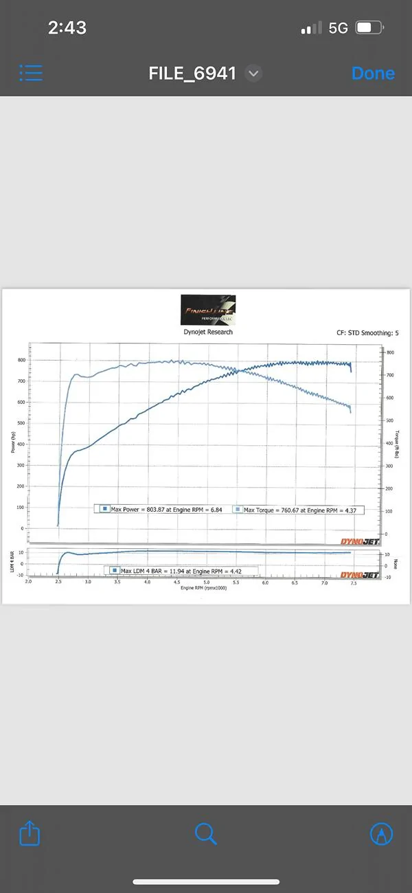

Here are my dyno # for Roush P2 on E85 with FI Stage 2 kit:
