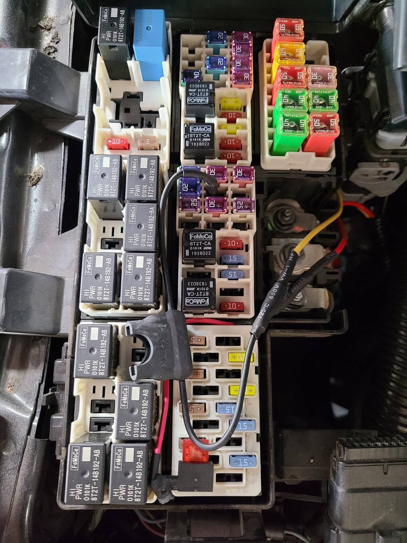

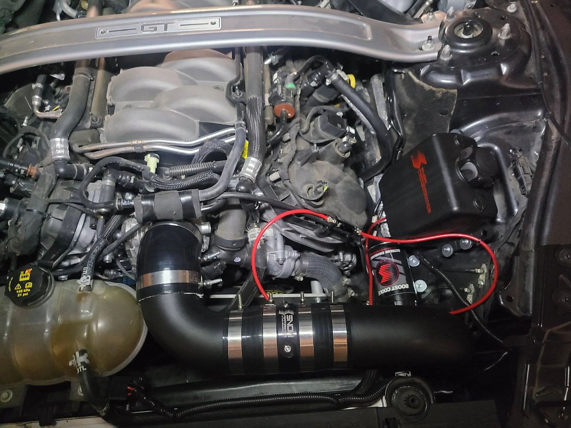

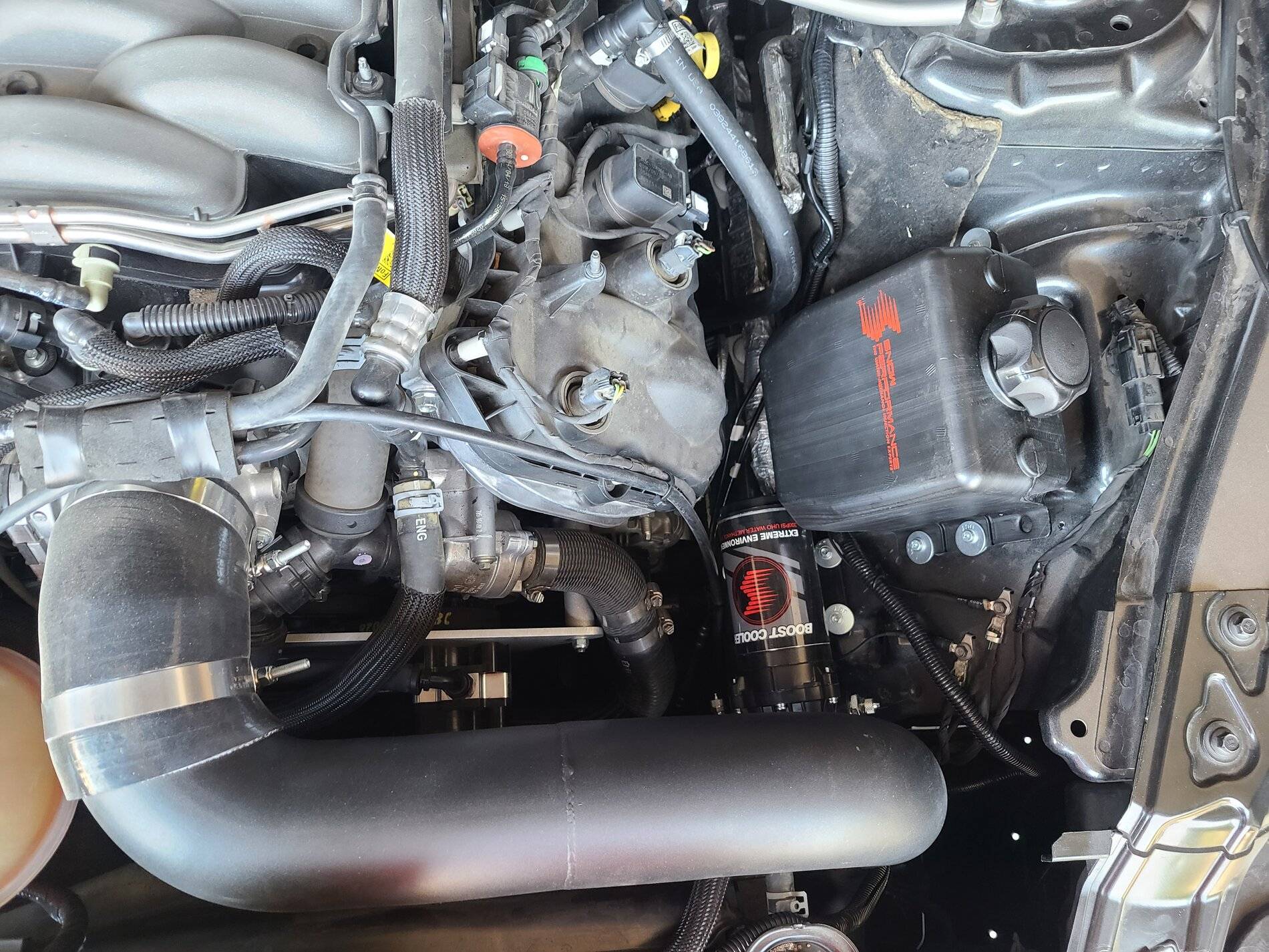

So long story short I purchased the snow performance meth kit about 6 weeks ago and finally made time to finish everything up over the weekend. Just in time to see how it works for a whole week of 115° plus days. I went with the base kit and have it set to start spraying at about 4lbs of boost with their #4 nozzle (225ml/min). I didn't tune for it, just running it for cooling and octane. Right now I'm only running 6-7lbs of boost but plan on getting a boost controller and turning it up after the summer heat lets up some.
Install was very straight forward and pretty simple. It only took so long because I got busy on the weekends for a while. This is my first time using meth so I'll throw some pics on here and tell me what you guys think. I'm open to suggestions if I should be doing something different. Yesterday was my first day playing with it and car seemed to run noticeably stronger despite the heat. Also I'm using boost juice 49% meth/ 51% water. And yes I know my engine is dirty as hell. It's on the list for a nice detail next weekend!

Mix your own, it cheap and easy. I found 70M/30W to work best in most cases over the years. You can mix that for a total cost of around $40 for 8 gallons.

Move the nozzle as far away from the throttle body as possible but still after the maf and use a bigger nozzle. I would mount the tank in the trunk but that’s just me. Get a breakout harness and a separate iat sensor. I would wire it different but once again just me. I have a ported 2018 manifold with the iat sensor installed if you are interested $200
