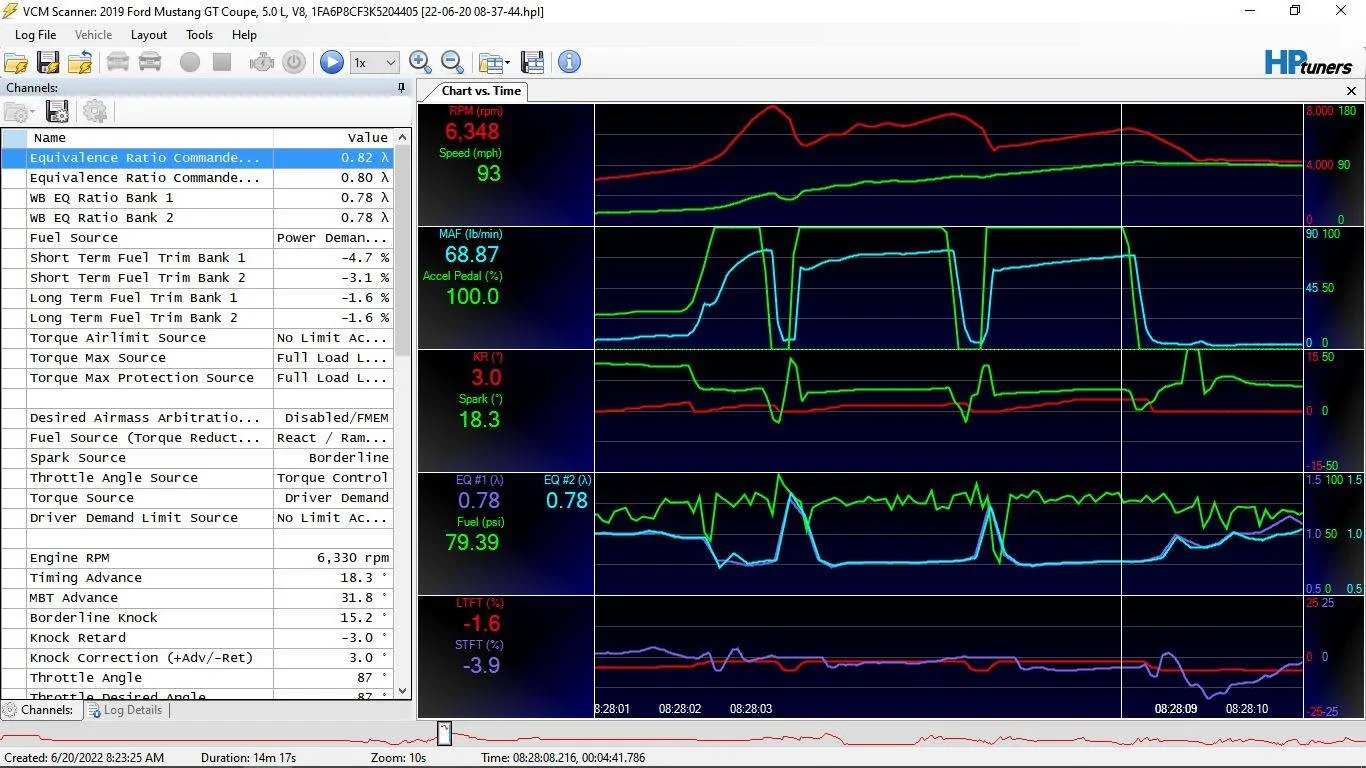

No, the tune still commands the same wot lambda. The upstream o2 sensors will compensate for the additional fuel by pulling it out.

This! Exactly what brianbr said. Different supercharger, but I did the identical thing on my 2018 procharged GT. Fueling was left alone and let the wide band O2's correct, however the additional octane and cooling allowed more timing. Unless you go overboard, meth injection is a fantastic option on these modern cars with on-board wideband O2 sensors. I'm currently working on a similar setup on my 2021 GT500 with the factory supercharger much like you are considering.

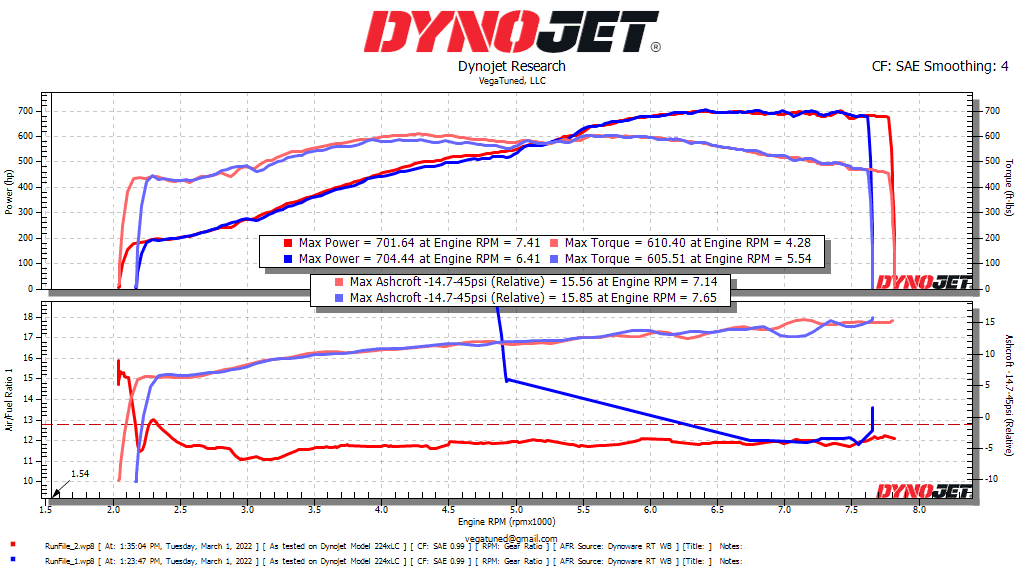

I run a 25 GPH nozzle on a Edelbrock 2650 like @brianbr. Like he I also run roughly a 60% meth water by VOLUME. I also use some lubricant in the mix to lengthen pump life.
Your backwards on the tune you'd actually want to run a richer lamba on 93 because when you add another fuel it thinks it's more 93 not meth, so it's trims you back (lean). I'll post my dyno sheet but you can see how when it comes on i go from 11:1~ AFR to around 12:1~
But since you're removing heat from the combustion chamber with the water, and giving it a huge boost in octane it should be fine. My nozzle is where the elbow about 6 inches away from the TB.
STFT’s pull the dwell from injectors based on the O2’s lambda reading. But yep. Closed loop fueling is such a beneficial ability these days.
