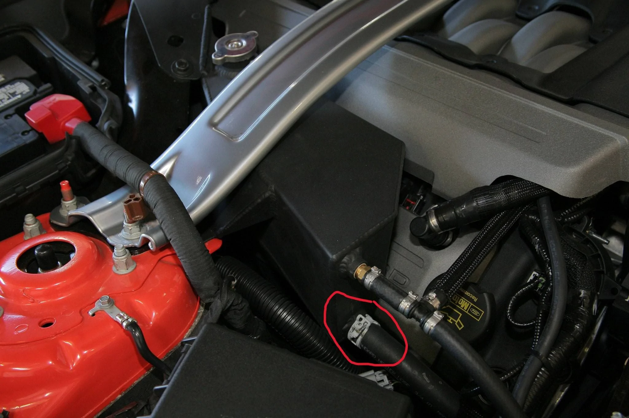

Does anyone know the size of the lower hose for the coolant expansion tank.? Relocating mine. Thanks!

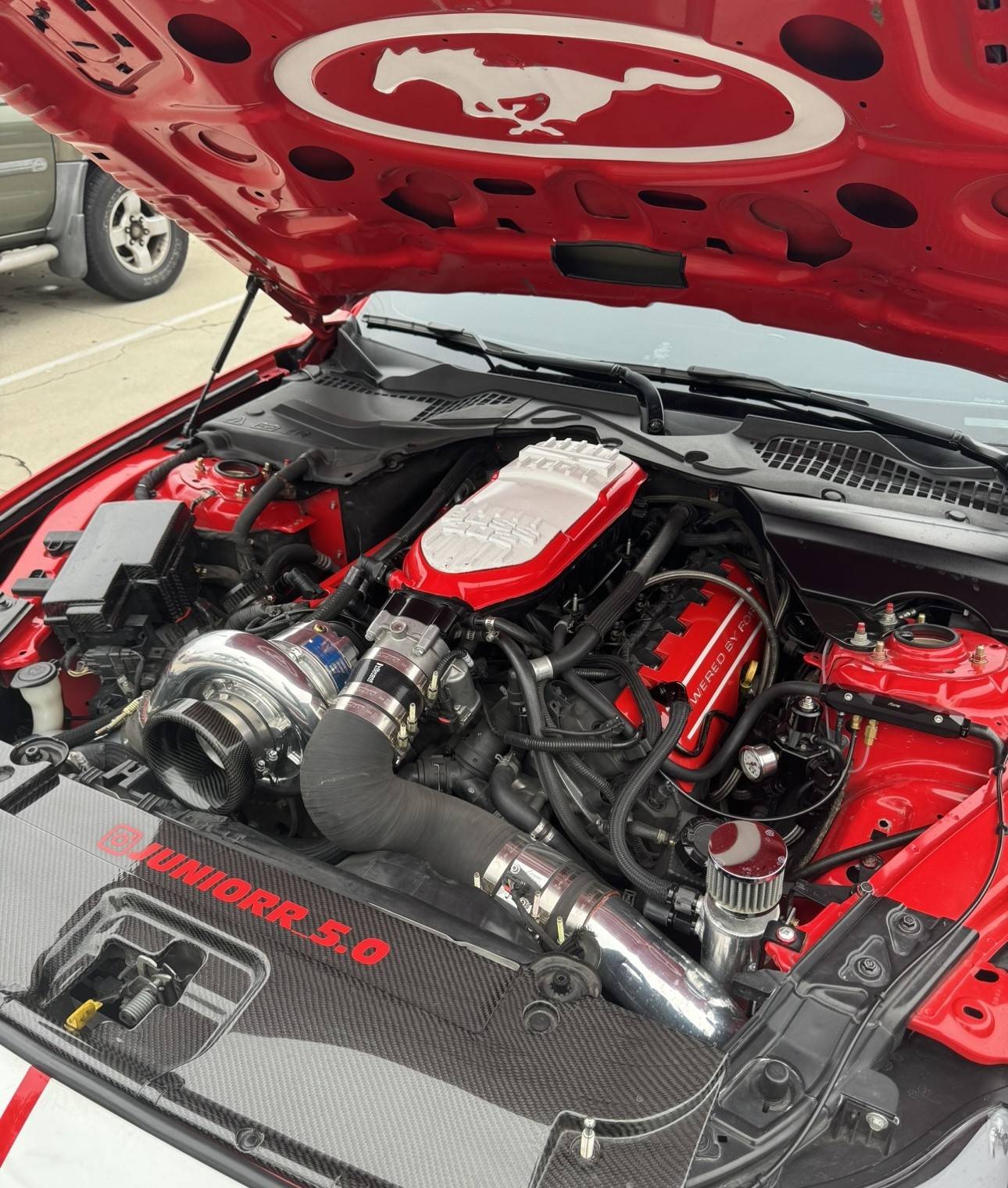

Hey this is Junior from N4SM I have a vortech on my car that I posted above.
Both Vortech & Paxton superchargers are the same company just different names. What you are looking at is head unit size. The 2200SL is Paxtons oil fed mid level head unit good for about 900-1000 HP. The head units that have a extra charge are the bigger upgraded race sizes. Depending on your power goals the 2200SL is a popular and great choice.
- Injector size I would get with Beefcake on that to see what he recommends.
- "BAP" is boost a pump, a voltage booster for the stock fuel system fuel pump. That is needed for 91/93 octane fuel.
- In my opinion 8 Rib pulley system is only needed when you are just south of 1000whp. I have a 6 rib griptec pulley and Gates belt on my car making 850whp, no issues with belt slip.
