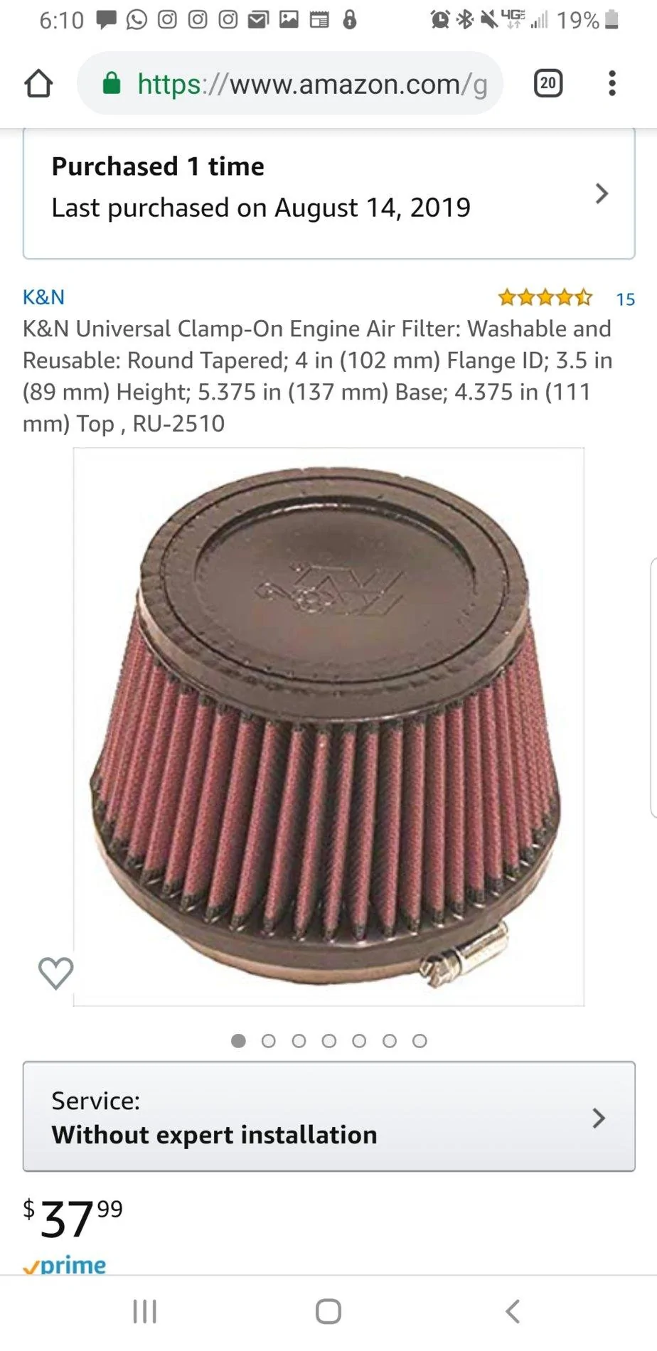

I hear the jlt cold air pipe
is restrictive so I bought a K&N filter to go over the inlet. Has anybody used one? Any gains in boost or hp/tq?

I doubt you’ll gain boost. But it’s a lot cheaper than the CAI’s offered by Paxton.

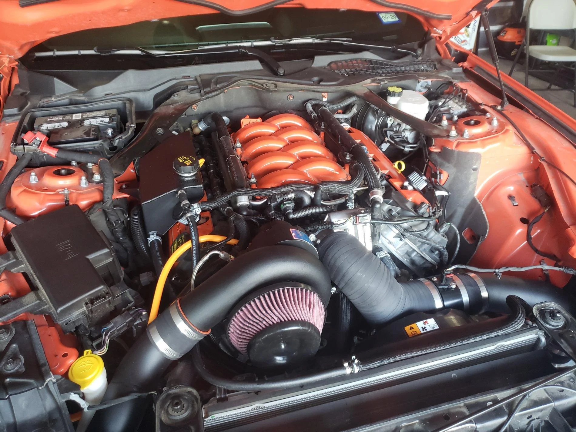

I have one of those filters new in the box if anyone is interested. I think the car would make more power with the JLT but the filter does clean up the engine bay. I ran my car with the JLT then pulled it and ran an open blower at the track and noticed very little difference. It is worth less than a .1 between the JLt and open blower.

I've seen one car with the Steeda closed box option with a Vortech blower, but not much more than that. Wonder how viable that one is with these setups being closed box?

I wouldn't go through the trouble unless you are just running the stock airbox. I think what you gain in lower IAT is offset by loss of flow from closing box. It is also really tight on the drivers side with the inlet and outlet both over there. If I had to do it over again I would just throw a filter on the blower for street duty and run it open at the track. I think most people will blow the engine up far earlier than it will get worn from ingesting dirt at the track.

You should always run open blower at the track.
