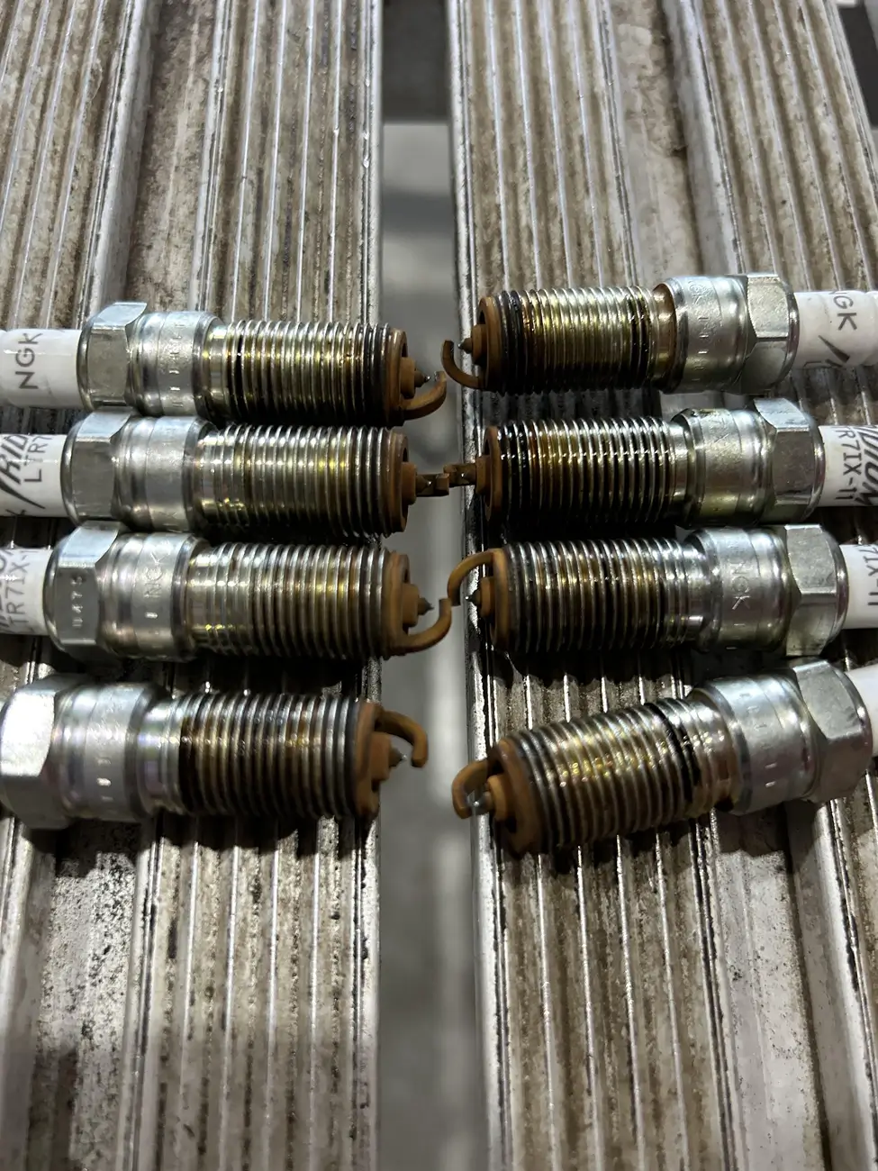

Checked the plugs and they had some discoloration. Will post pic under:
Does this mean it was running lean, tuner said they don't run lean due to the wideband O2's?

Looks like octane booster was being used at some point. I'd put a new set of plugs in it, I'd recommend the ford racing m50a plugs gapped at .026. I'd not use the 6510s pictured there.

I was using VP unleaded octanium (16oz) per tank as I was seeing a lot of knock at WOT pulls during the tuning process, the octane booster brought it to basically zero knock in all conditions. Was I running too much or what should I do?
If it was me I'd get with your tuner and lower the timing, this is a common problem I see on boosted cars running 93. Some tuners have the tune too aggressive with the timing and fuel being used. Some gas stations the fuel is inconsistent as well.
just start walking it down til you see knock again at wot. 14oz, then 12, 10, 8, 6 etc, til you start seeing knock and that will give you a good idea
