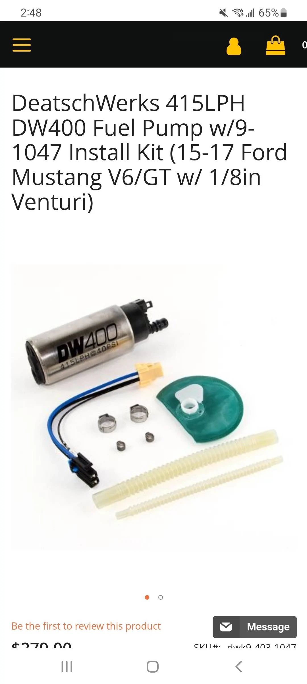

You lose the venturi line. That's exactly what I said. Not a lot of people want to drill a hole into the top of theor pump and glue in a nipple to add a small straw. If you have to add something that is no longer there then yeah that thing has been lost.
the line coming out the top of the pump is not for venturi

2015 mustang gt
Just got off the phone with my installer. He talked to Vortech and had a very interesting conversation. He has always used a 1 step colder plug with a forced induction install. The tuner at Vortech is telling him that he shouldn't have done that. We need to go back to the factory heat range and gap it down to 28 and that should cure it. NKG Plugs are on order and we plan to swap out after Labor Day. If this cures everything that will be crazy and only $100 buck for plugs and install. I was going to drop some cash on a new tuner so hopefully this takes care of it.
i see zero chance of this working. heat range is not how hot the spark plug fires, it's how much heat it retains. your just increasing the chance of detonation with a hotter plug
