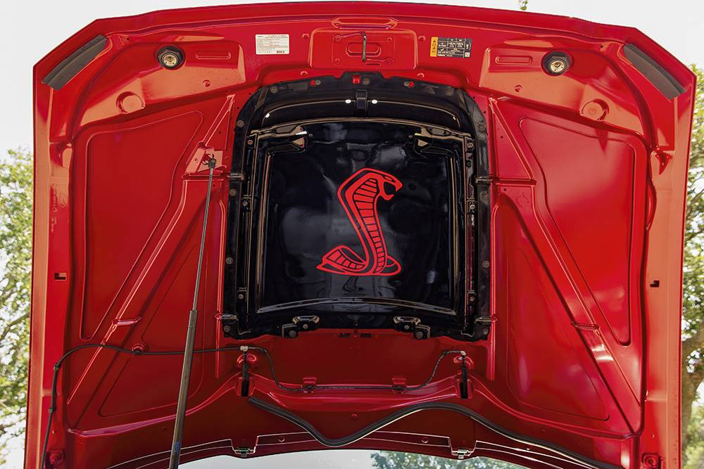

Straight water might be alright for small decals like the snakes, Goose, but you need the solution to be slippery and that's where the the detergent comes into play. I've applied dozens and dozens of fairly large decals and the odds of you needing to "lift" it to reposition are high. So, with just water, you might find that the decal is much more difficult to apply than with a lightly soapy solution.
And, FWIW, I never use adhesive promoter as it just gets diluted or washed away while eliminating the air and liquid.
As an example, the rain tray snakes I made are a foot high and it would be totally impossible to apply such a large decal without lubricating solution.

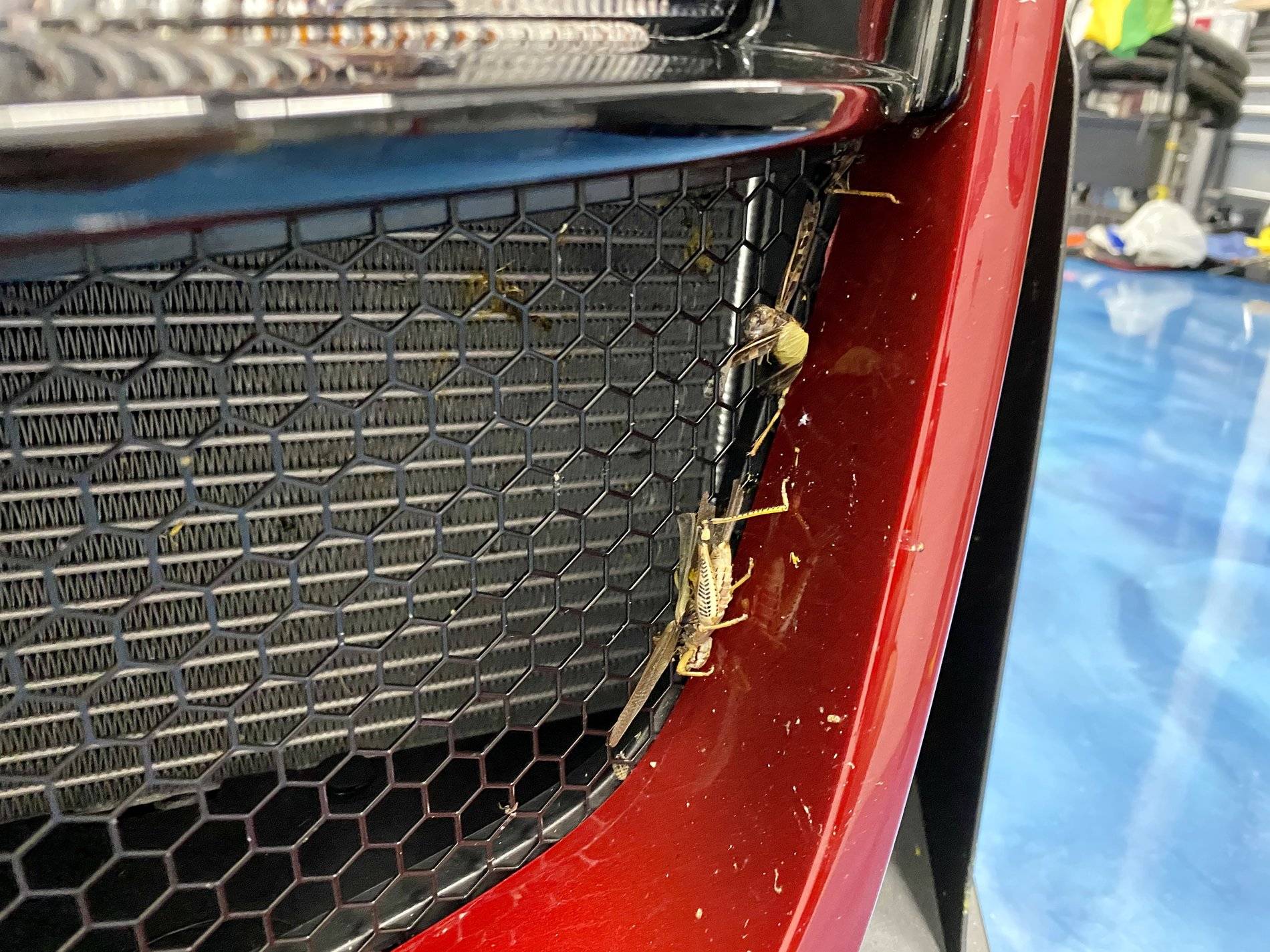

Totally agree. I’ve applied stripes, pinstripes, windshield banners and decals. I’ve used a soapy water solution for all of those. For these small graphics, I didn’t want to introduce any soap, especially on the splitter. I was already concerned with adhesion... having ceramic coating I’m sure doesn’t help.
So far so good though with everything staying put. I hit 150 on a Mustang cruise yesterday and also hit a crap ton of large bugs. The car is all clean again today and the decals all held firm.

I like that look, I wonder how well its going to hold up with the heat from the engine bay. And you made that huh? Interesting...I have to think about this, But I'm thinking white, or a contrast color.

Mike: Others have had the same rain tray decal on for some time and neither they nor I have seen any indication of heat issues on the vinyl. I'm fairly sure it would have affected it by now.
Yes, I cut the decal in the photo, it's two layers of vinyl, full black background and red snake, and I've made them for a few other folks as well.
