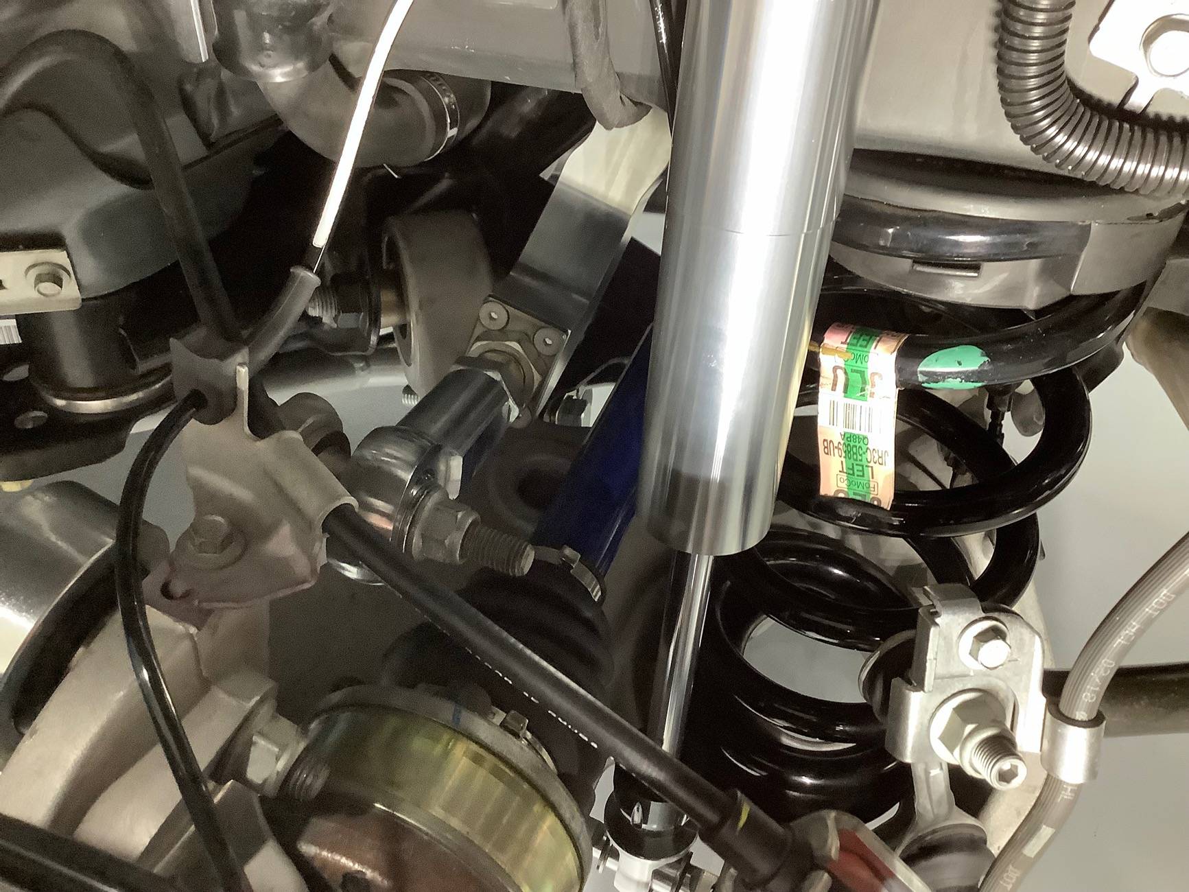

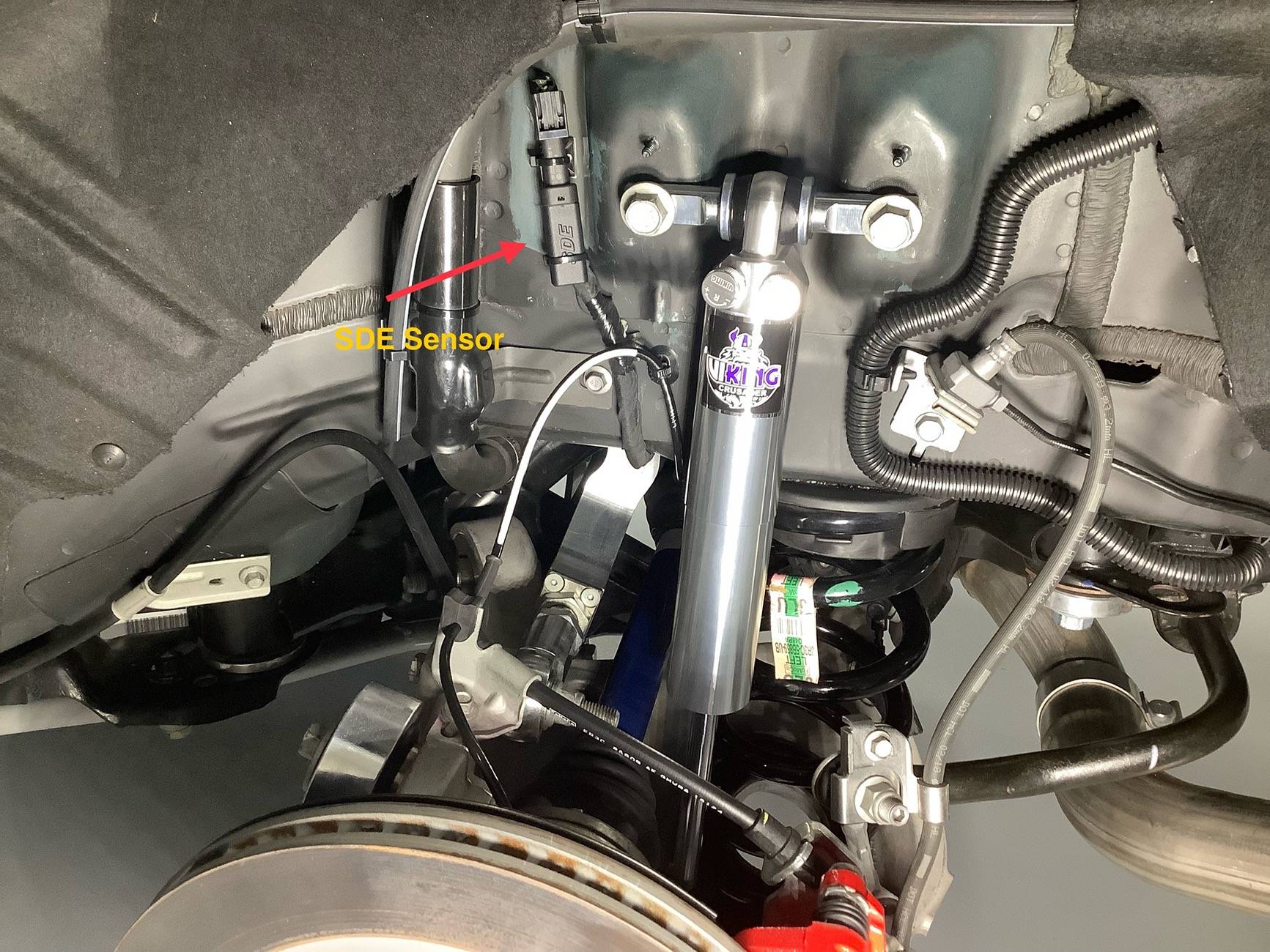

Ultra Spec Inverted give you more clearance from the axle dust boots. Non-inverted shocks are close to the boots and there is a risk of rubbing through them.
