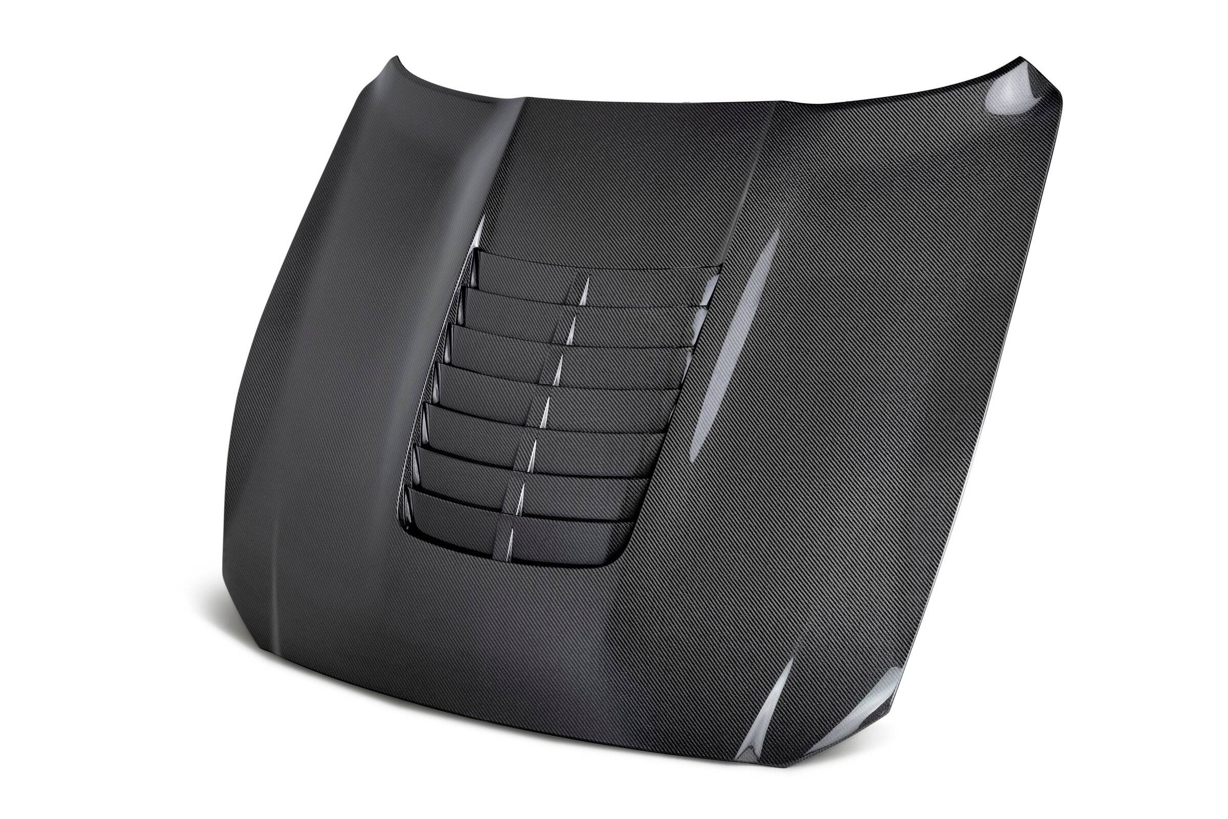

We offer a GT500 hood with removable vent specifically for the GT350/350R models. Our hood does clear the strut bar in engine compartment and it also comes with a rain tray.
2015 - 2020 MUSTANG SHELBY GT350 TYPE-GT5 DOUBLE SIDED CARBON FIBER HO | Anderson Composites

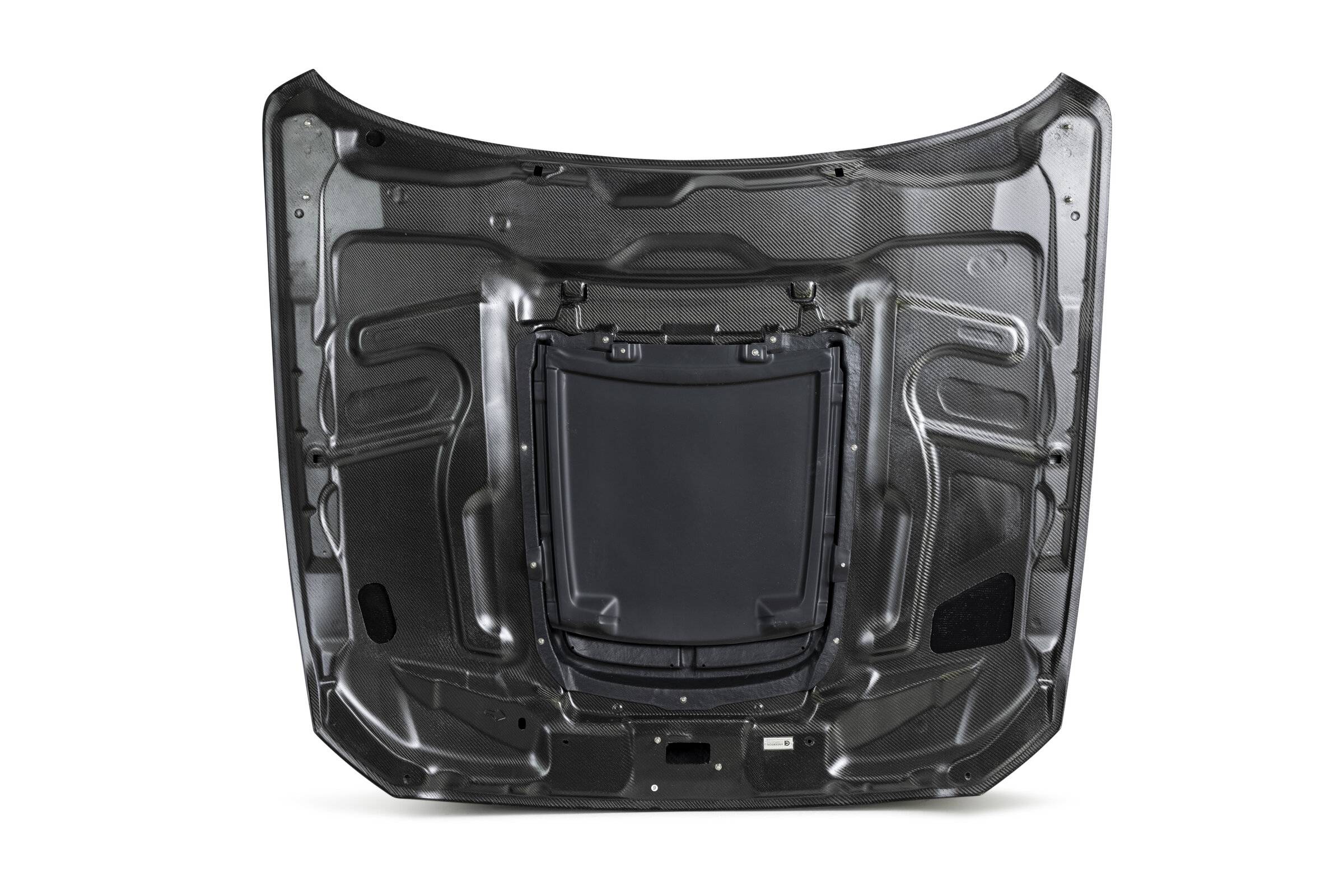

Hey there, I see that it says that a heat shield is required and it brings me over to this page. Do you have any pictures of the heat shield installed on the hood? Also, do you know where it goes if you don't have pictures?

The heat shield material has self-adhesive backing on one side. You cut the material with good pair of scissors and roll it down onto the backside of the hood. The link for the adhesive is here.
Heat Shield - ThermoTec Aluminized Heat Barrier Adhesive Back | Anderson Composites
The images on the web page are for reference. Most owners apply the heat shield in the flat, wider areas in between the structure bracing etc. And also in areas where there may be more heat, i.e. turbo, headers etc. Here is image of back side of this hood.
