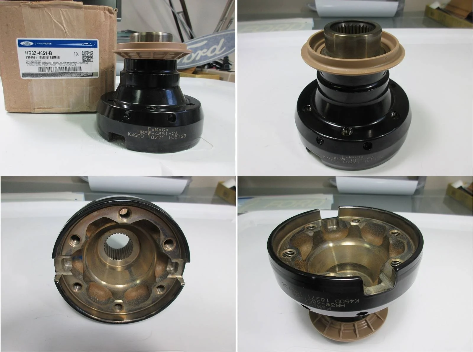

I've had a reputable shop change gear and posi unit on my 18 GT got it back with vibration At 60+ mph clocked my aluminum driveshaft no good replaced with original shaft still vibes but not as bad as the orig is taken up the NVH. My question to you is how do you clock it 5 different positions?Had drive shaft replaced,no difference.Changed clock position on rear drive shaft to pinion flange (re indexed) 3,000 miles ago vibration gone or 95% gone.
Tried 5 different positions,makes a HUGE difference.
