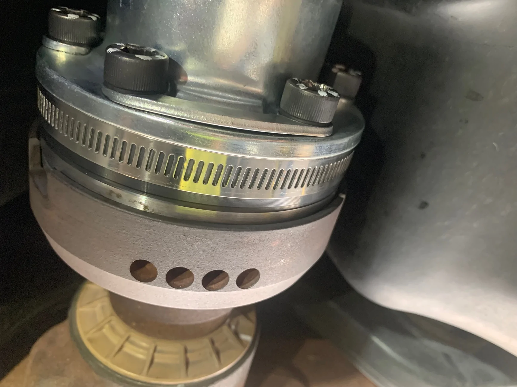

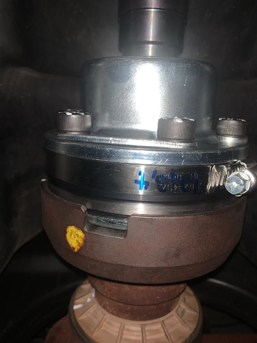

Been dealing with this myself. My factory ds carrier bearing went out and the vibes started. So, after reading the 250+ post about vibrations on this site… I decided I did not want to “try” several factory driveshafts before finding one without issues. So, I ordered a 1 piece aluminum driveshaft from the driveshaft shop. I installed it and the vibes were way worse. I was frustrated and contacted the supplier and they sent me a new one. Installed the new one and same issue. I rotated the ds one bolt at a time with no meaningful change. As I studied the factory ds and the pinion flange with the yellow paint marks I realized the factory ds and the pinion flange were balanced as a unit. The flange in my car has 4 holes drilled into one side and 2 more, 1/4 away from the first 6. Ford did this to remove weight. So, I used a hose clamp (with car on jack stands) and moved it around in measured increments until the vibration was mostly gone. I used a sign on my garage door and whether or not I could read it from my rearview mirror as my gauge to determine improvement + or -. It’s livable for now but at some point I will mark everything from trans output to ds to pinion, take the ds out and the pinion and have it balanced as a unit at a local machine / driveline shop. It’s nuts that Ford doesn’t make the carrier bearing serviceable. It’s even more nuts they had to drill so many holes in the pinion flange and they balance it all as a unit. Must have saved them a ton of time/money but they created a nightmare PITA for everyone else. Oh and Ford’s factory warranty might as well have never existed. It’s a joke. I love my mustang and have too much invested in it to think of getting rid of it. However, I will NEVER buy another Ford product. EVER.
I hope this helps you. More than likely you need to remove your ds and pinion flange and have them balanced together as a unit… or use a hose clamp. I’d go jack stands and hose clamp first to prove to yourself if the vibe is truly coming from the ds. It’s time consuming but cheap. If you see a good improvement, then it’s probably the ds/pinion flange issue.

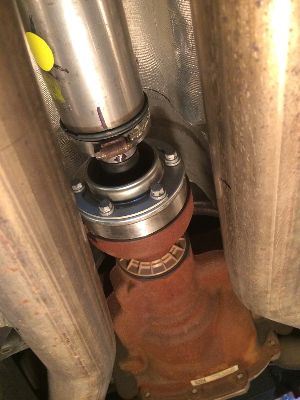

I did basically the same thing that WhitemarePP did when I installed my one piece alum DS from steeda.
I had pretty bad vibrations and I worked it out on jack stands and a hose clamp.

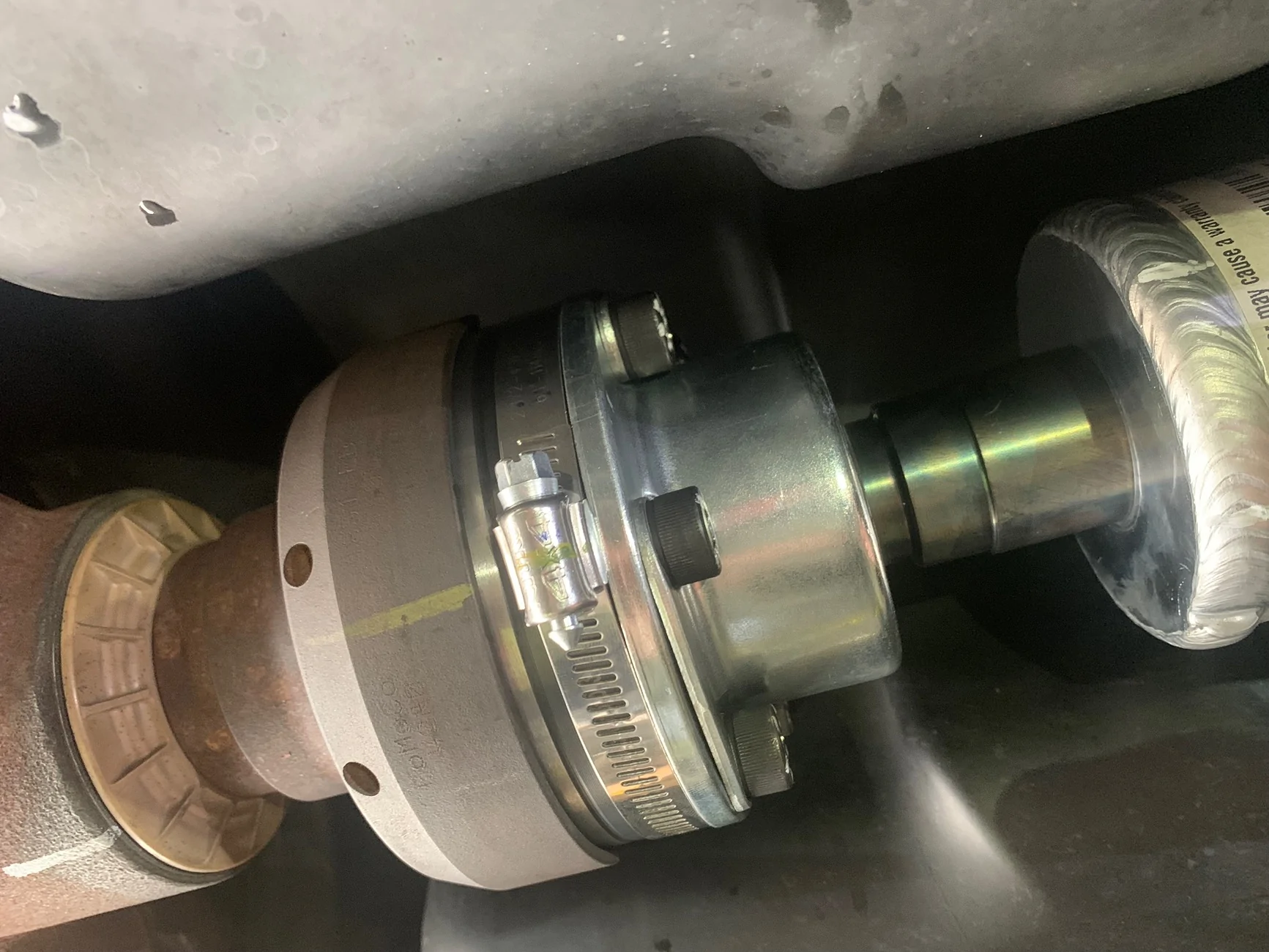

I wish I had found this thread two days ago. I just swapped my ds back to the stock two piece ds because I had vibration with two Driveshaft Shop aluminum driveshafts, both at 45 mph. I was about ready to purchase another style ds. Now I'll have to try the hose clamp cheat.
