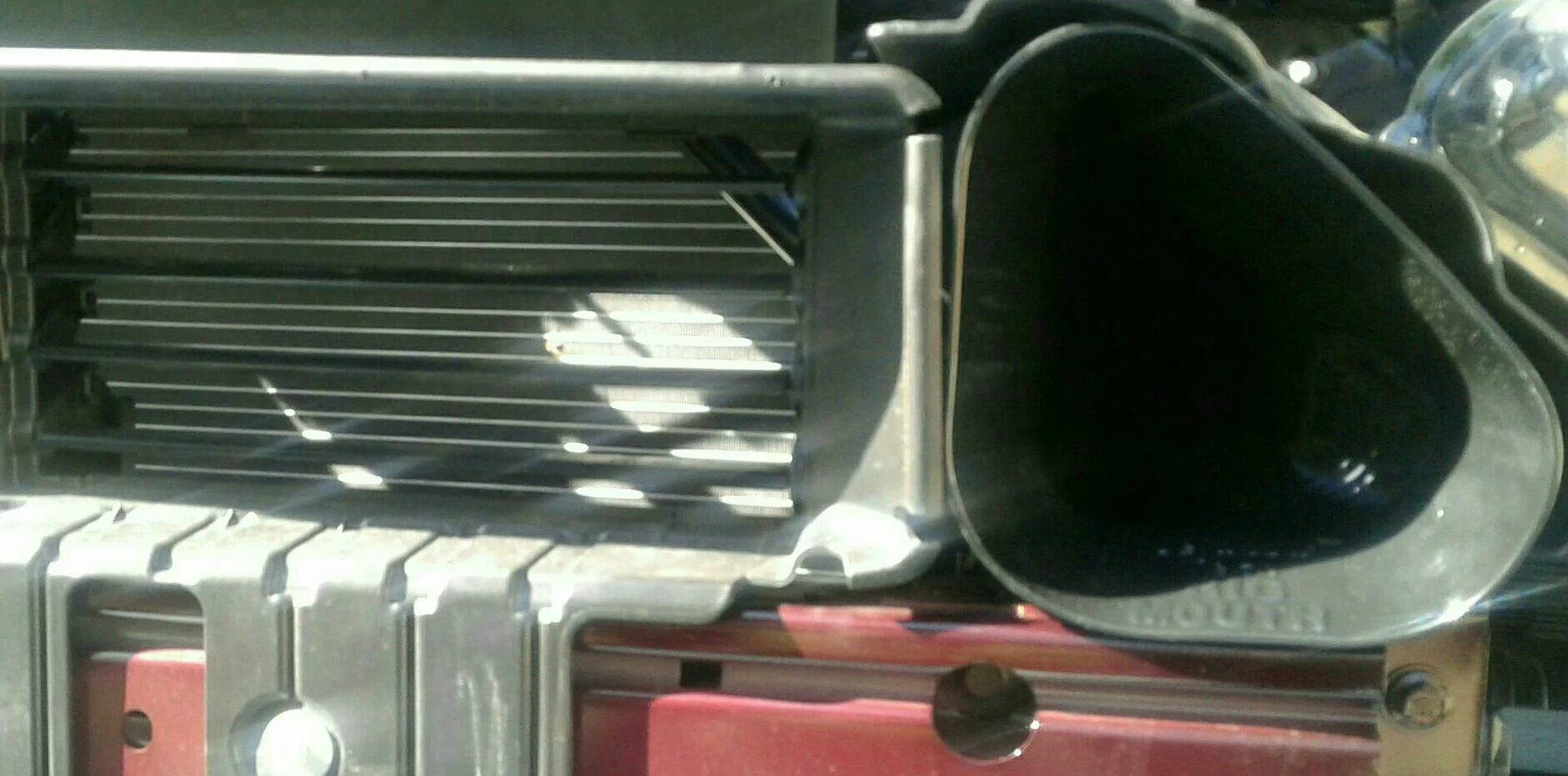

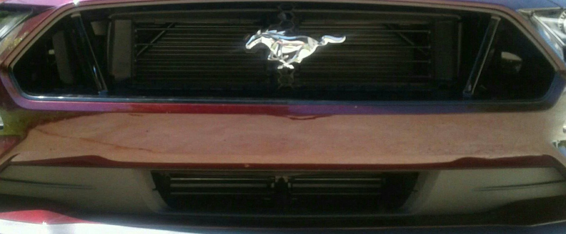

Velossatech ram air scoop fits 2018 mustang with gt upper grille!
I really doubt it will fit since the shape and size of the grille has changed for 2018.
It fits just fine actually:thumbsup:
Here's some pics for proof. Stock gt upper grille opened to leave only the pony in it's corral. Lower opened to match the upper, side pockets opened to match the actual scoop size. Velossatech ram air scoop in gloss black to match upper grille(first ever on a 2018.:ford:
Can confirm that after a quick test drive&a few hard pulls. Per in car sensors intake air stays within 2-5degrees of ambient temp. Before it would be as much as 20degrees over ambient in any type of idling or stopped situation.
Even without the scoop before it wouldn't get this close to actual indicated ambient.
Imo worth the $ not sure other then a little added turbo spoiling up noise under full throttle. What it actually offers perf wise:shrug: best guess would be slightly better mpg on long hwy trips&possibly a tenth or so at the strip.

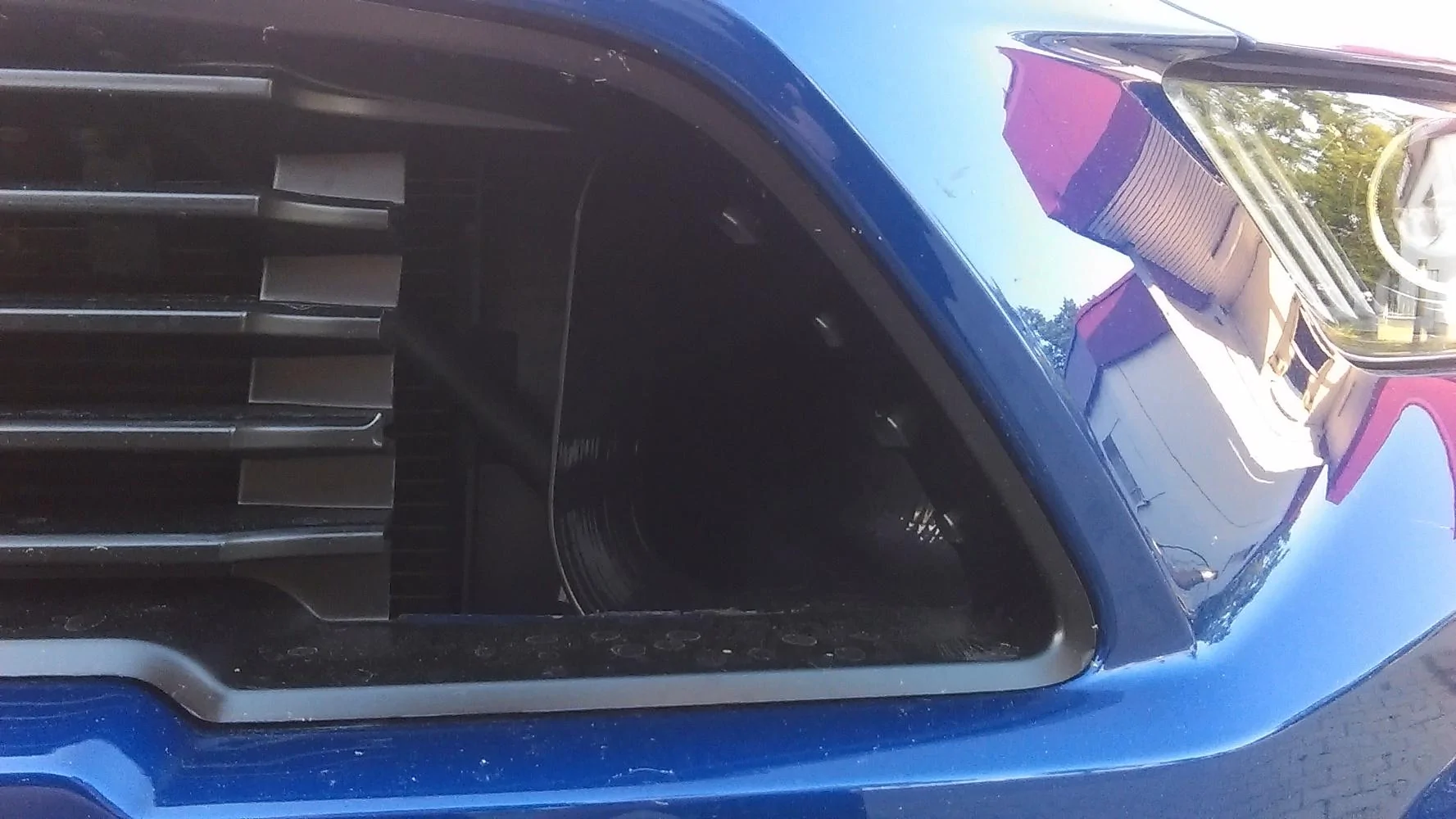

If Velossa Tech decides to make one for the Roush fascia let me know.
