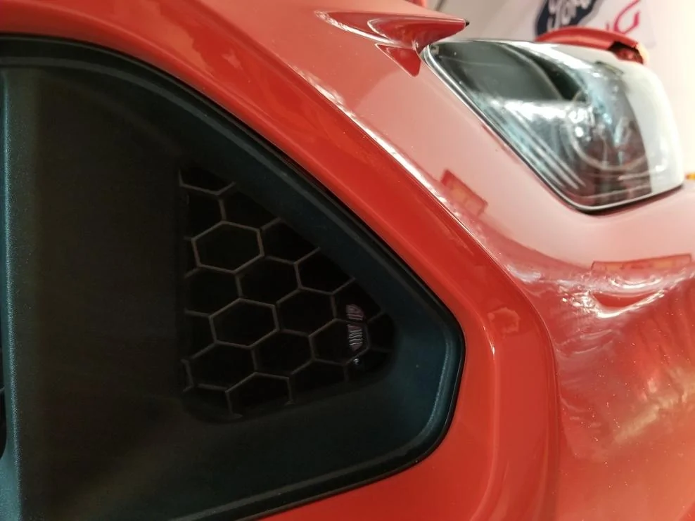

Question, is there any advantage to cutting the grill as a complete hole versus cutting the back and using a razor to clean it up to open up the holes? Figured I would ask because once it is done, its done.
Curious as to if there is any more airflow going through the little holes versus cutting that section out completely and opening it up or are we just talking mostly aesthetics?
The more material you remove the more laminar the flow and the higher the velocity, the difference isnt very much but if you want to squeeze every ounce of performance out, cut it out. :headbang:
The honeycomb offers a little bit of foreign object intrusion prevention, worthwhile for a DD, IMO. I also like how it looks myself :p. You're still opening up the cross-sectional area by more than double.
Yeah, that's true as well. It is my secondary fun car after all and I do occasionally go to car shows and some fun drives. I may put in the effort to cut the back and clean it up so it looks more how it should have come from the factory with a cleaned up nice looking air duct.
To me it seems the easier method than dremeling all the holes out, too. You can quickly get a clean cut with a hack saw on the back.

[MENTION=19602]VelossaTech[/MENTION] Air tunnels uses flow straighteners, aka the honeycomb. Same idea with the Ford grills. IMO just making a gigantic hole would slow down/stall airflow.

I cut out my entire front, upper grill, it's very easy, there's basically a cut indicator on the backside (where the material goes from textured to smooth), use a Dremel, then clean it up with a little sandpaper. Mine is clean enough that it almost looks factory.
The one part of the process that's a possible issue point: the upper side tabs that hold the fascia may ... or may not, break off. Do a search, see what people are describing (FWIW, I think if you used something like a butter knife to slightly release them vs. the usual method of just "pulling hard", they'd fare way better).

I followed the indicators mentioned above using a coping saw to leave the honey comb. I cleaned the holes up with an exacto knife. Retained the factory look which is what I was after. I was also able to leave the grill in the bumper cover this way.
