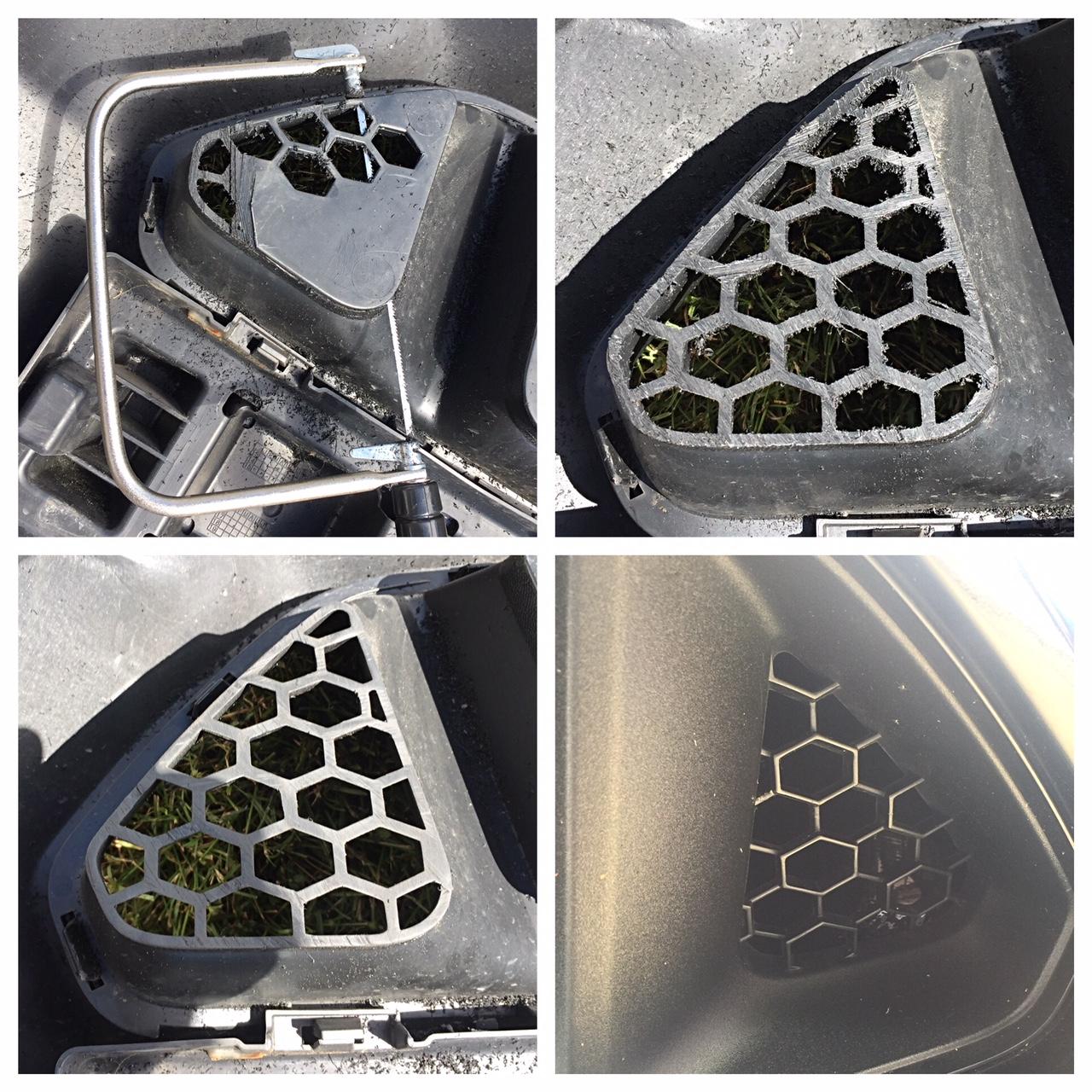

Thanks Mike.
First I tried a flush trim router but ended up marking one of the hexes, thankfully it's only a minor blemish.
Next I tried a Dremel type tool. This was quite tedious and wasn't giving the finish I wanted. Props to those who persevered and did a clean job.
I made an executive decision and carefully hacksawed the back off. The flexible blade hacksaw followed the back plate as can be seen by all the cut marks in the photo. Then I filed and finished with a cork block and sand paper.
I removed about 3 millimetres (1/8 inch) in total.
I believe this last method does give the best finish as there is no risk to damaging the inside of the hexes.
I remembered this post and wanted to thank you for the idea. I also wanted to add that a coping saw (usually under $10) makes cutting the back off very easy. A sanding block and razor blade took care of the rest.
