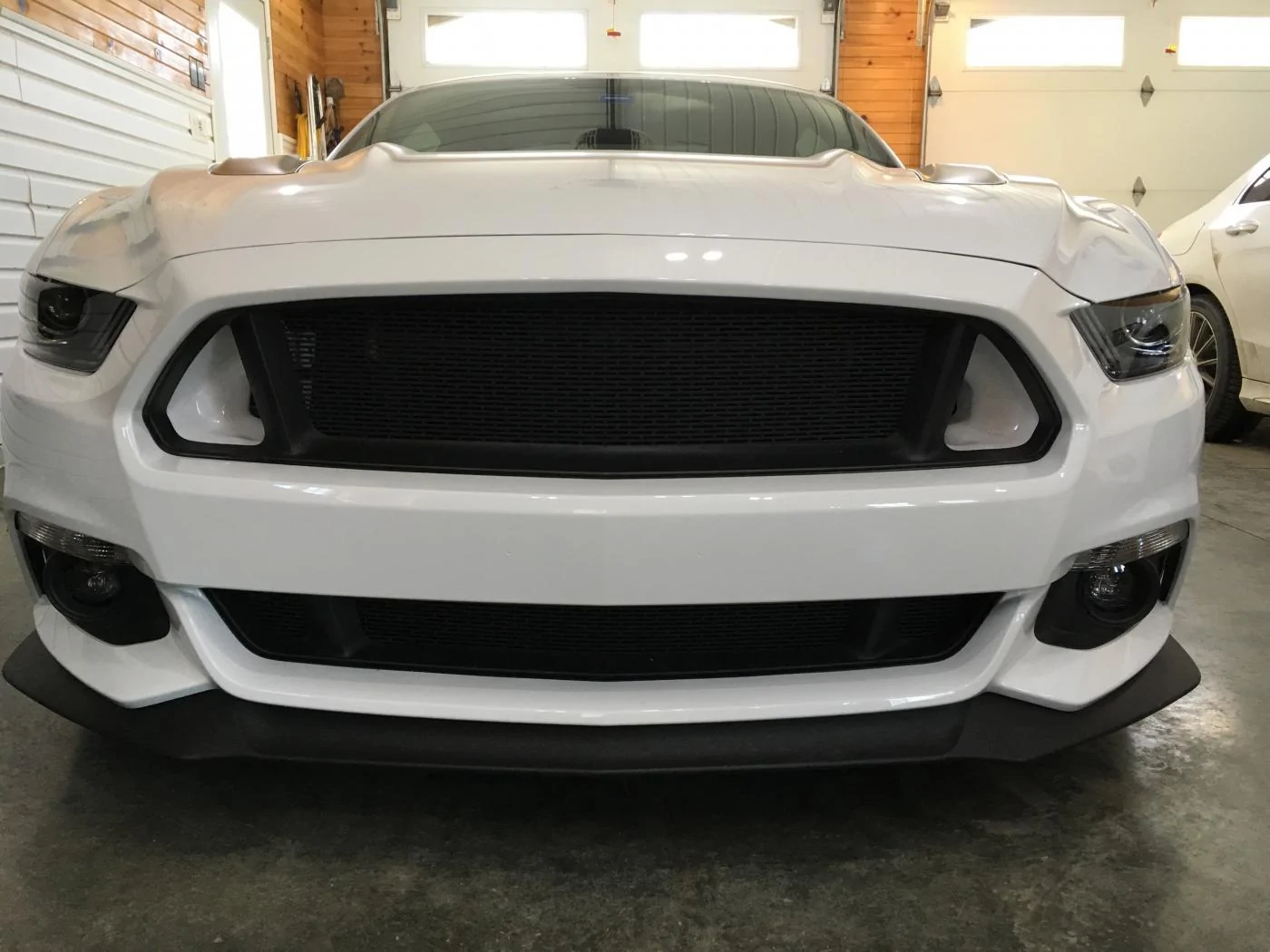

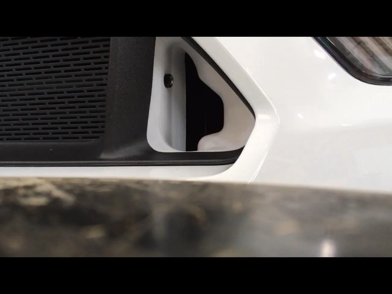

I'll get some better pictures up on this mod Wednesday. I've also added an LED light in each big mouth for a night time affect:thumbsup:
Thanks to Dan @vellosatech for his excellent workmanship and ability to design a pass side copy for me. I'm in love with the affect and the beautiful color match.

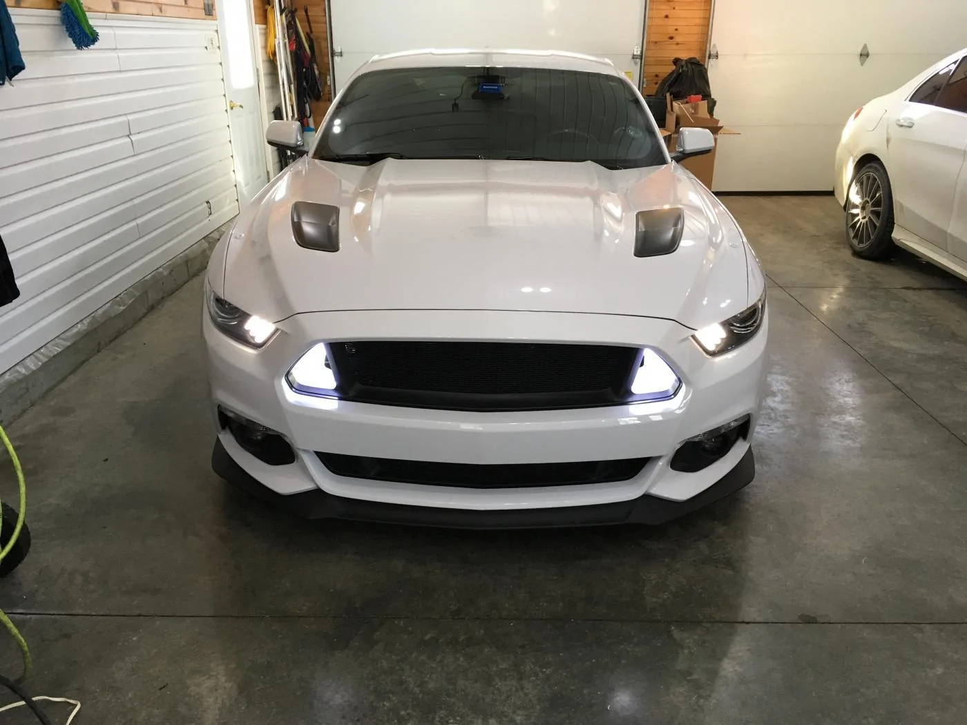

Shawn was nice enough to send me this picture. Thought I would share.
His dual big mouth setup is really special I think!

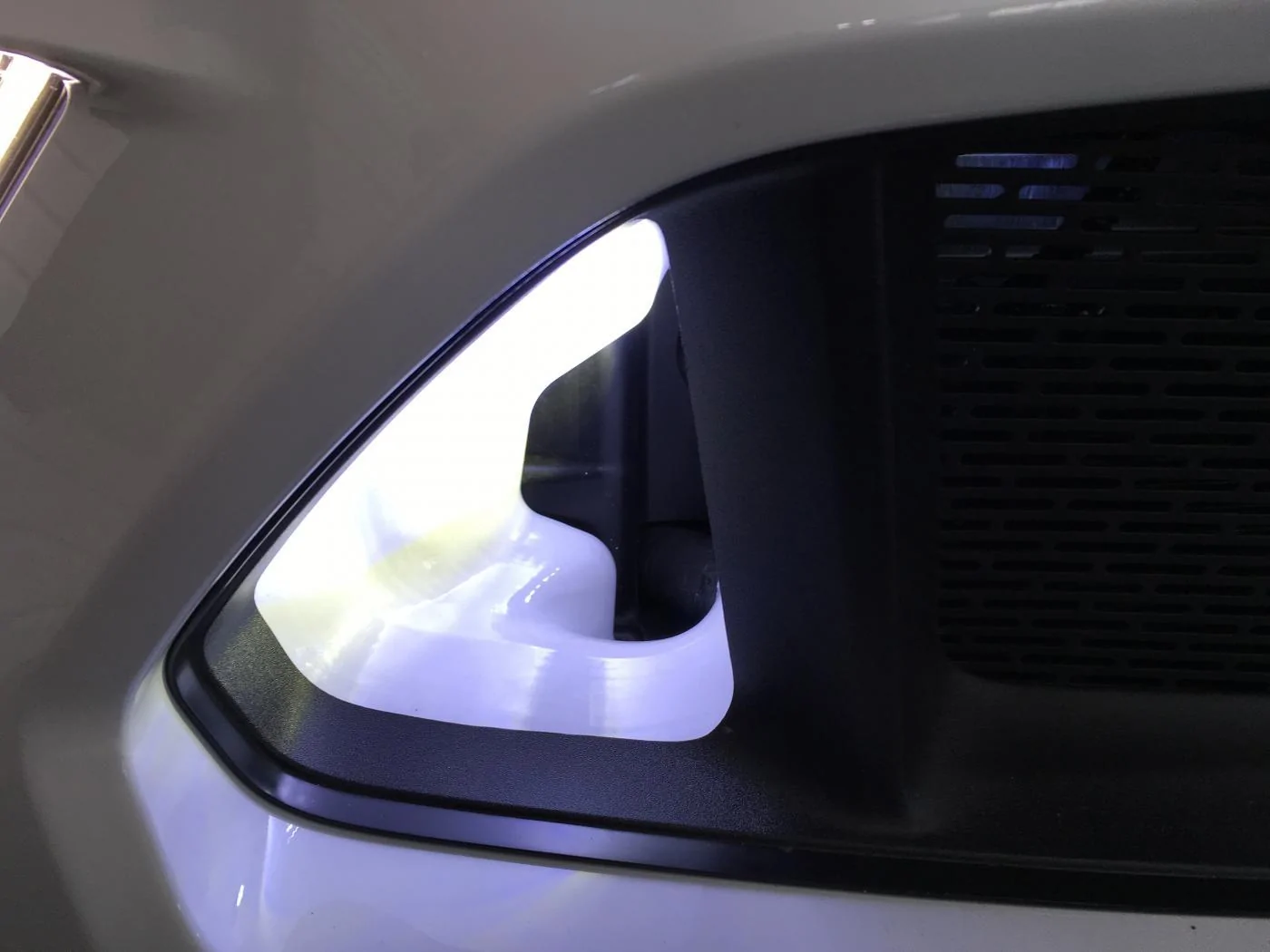

Not sure if Dan from Vellosatech is going to offer a lighted version, but if anyone wants to do this, here is what I did.
LED lights from Amazon different colors are available but mine is white.
https://www.amazon.com/gp/product/B007PBPI68/ref=oh_aui_detailpage_o01_s00?ie=UTF8&psc=1
As far as wirring goes it's simple. I tapped one headlight at the connection plug for both lights. The power on with ignition wire at the headlight plug is the light grey with purple strip wire which then connects to the LED light red wire and the LED black wires are grounded to frame. That's it.
