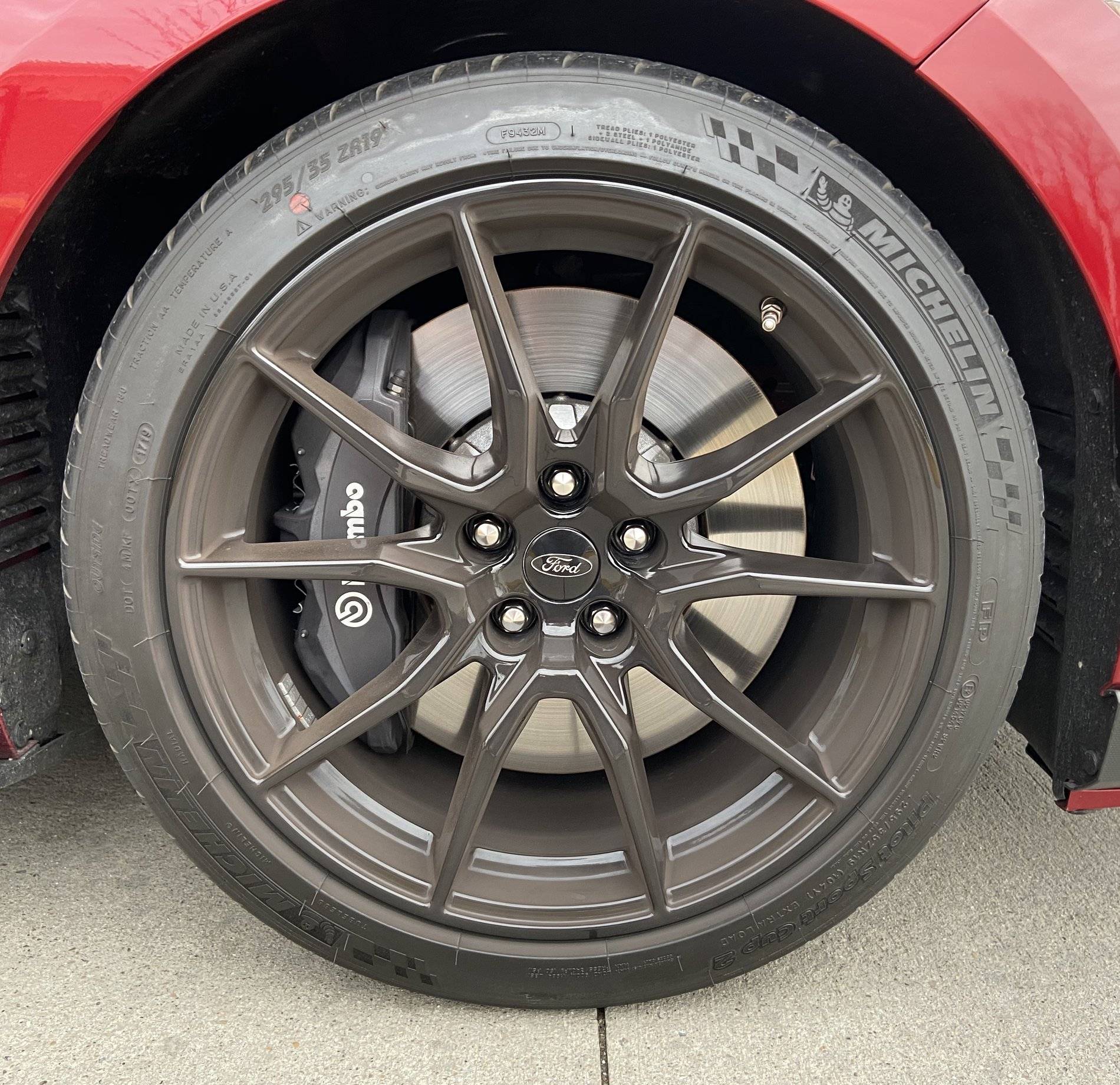

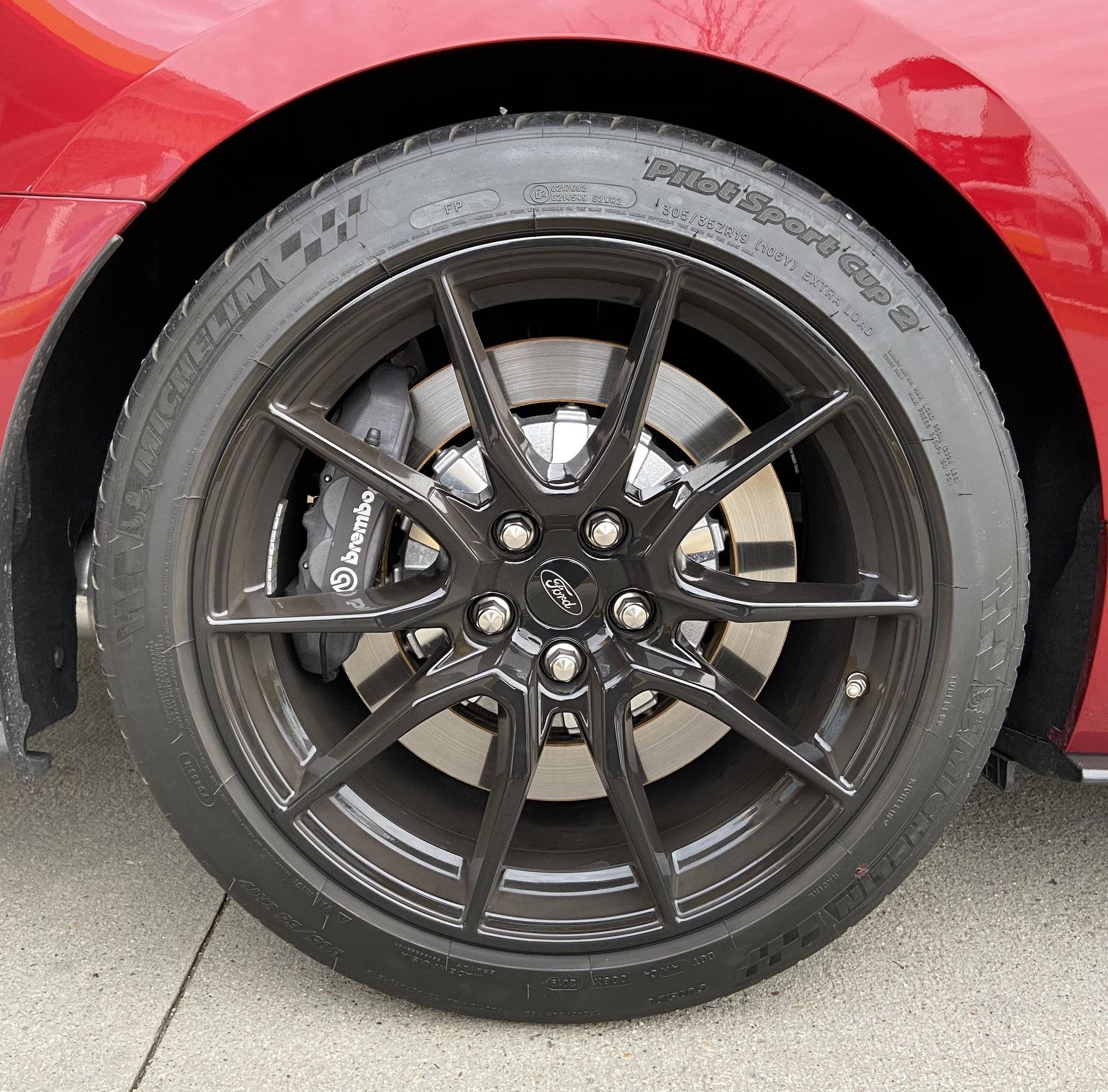

I noticed the valve stem location is not the same front vs. rear.
In the fronts, the valve stems are between the spokes, in the rear they are not.
Does anybody know the reason for the differentiation between front and rear?

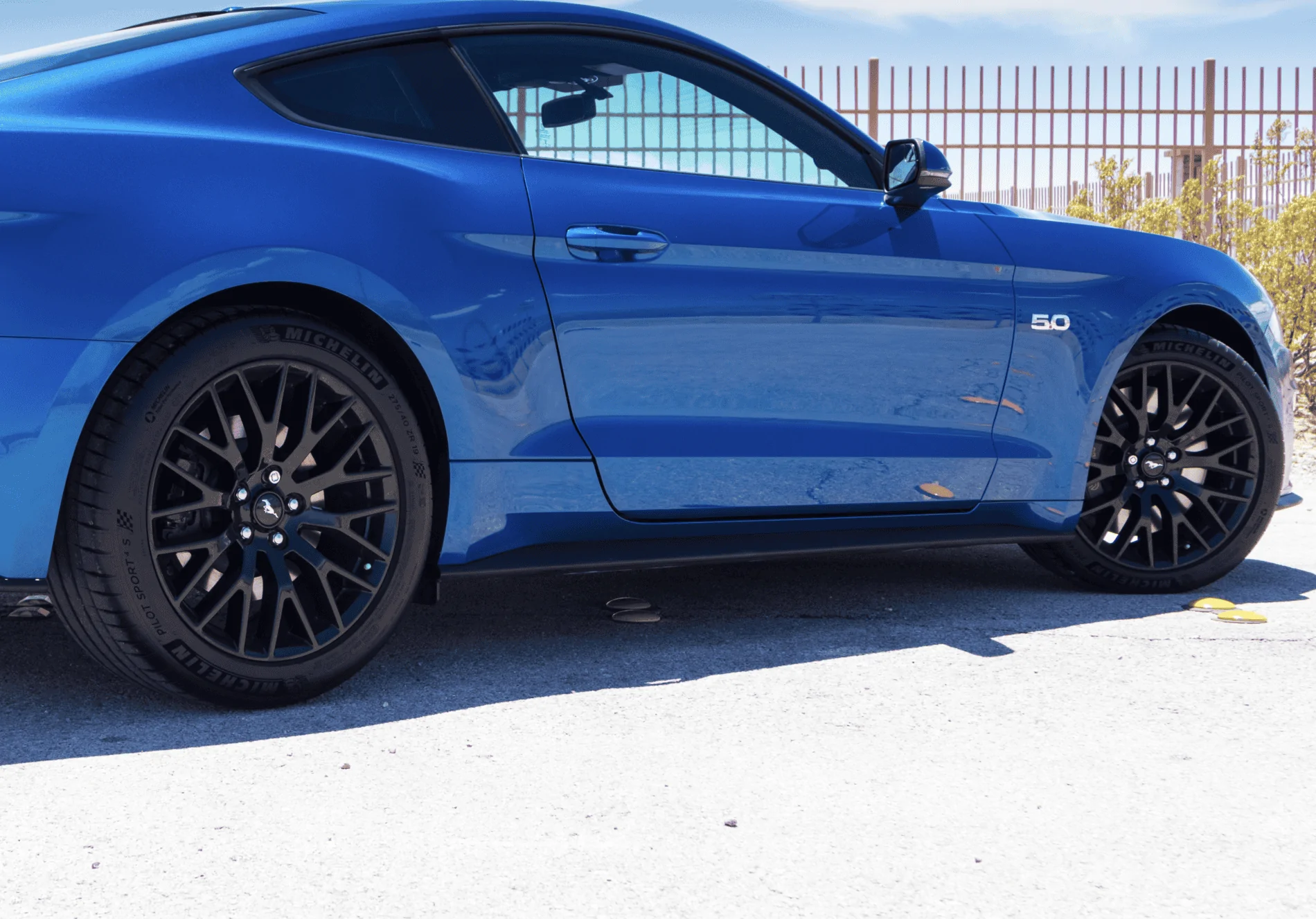

On the PP1 GT it’s between different spokes on the front and rear wheel. You can see in this photo when I first got the car and had the green nitrogen caps

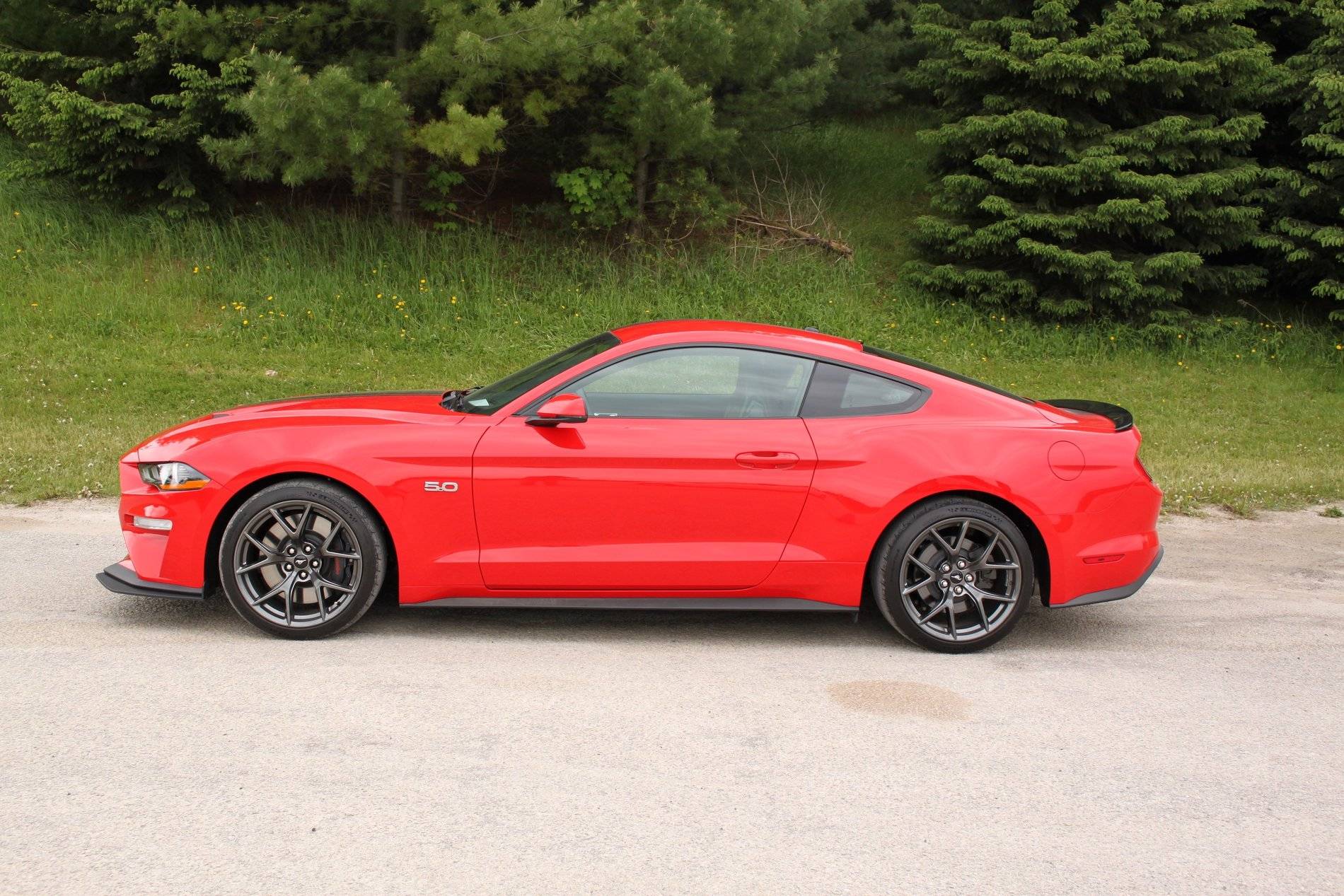

They do this to visually differentiate bewteen the front and the rear wheels since the wheels are different widths. Of course, the stock tires on a GT350 are different front and rear so a quick look on the tire makes is easy.
The PP2 Mustangs, however, use different wheel widths but the same tire width front and rear. The placement of the valve stem tells you which front wheel and rear wheel without actually measuring.
It's detailed on page 12 of the PP2 Supplement

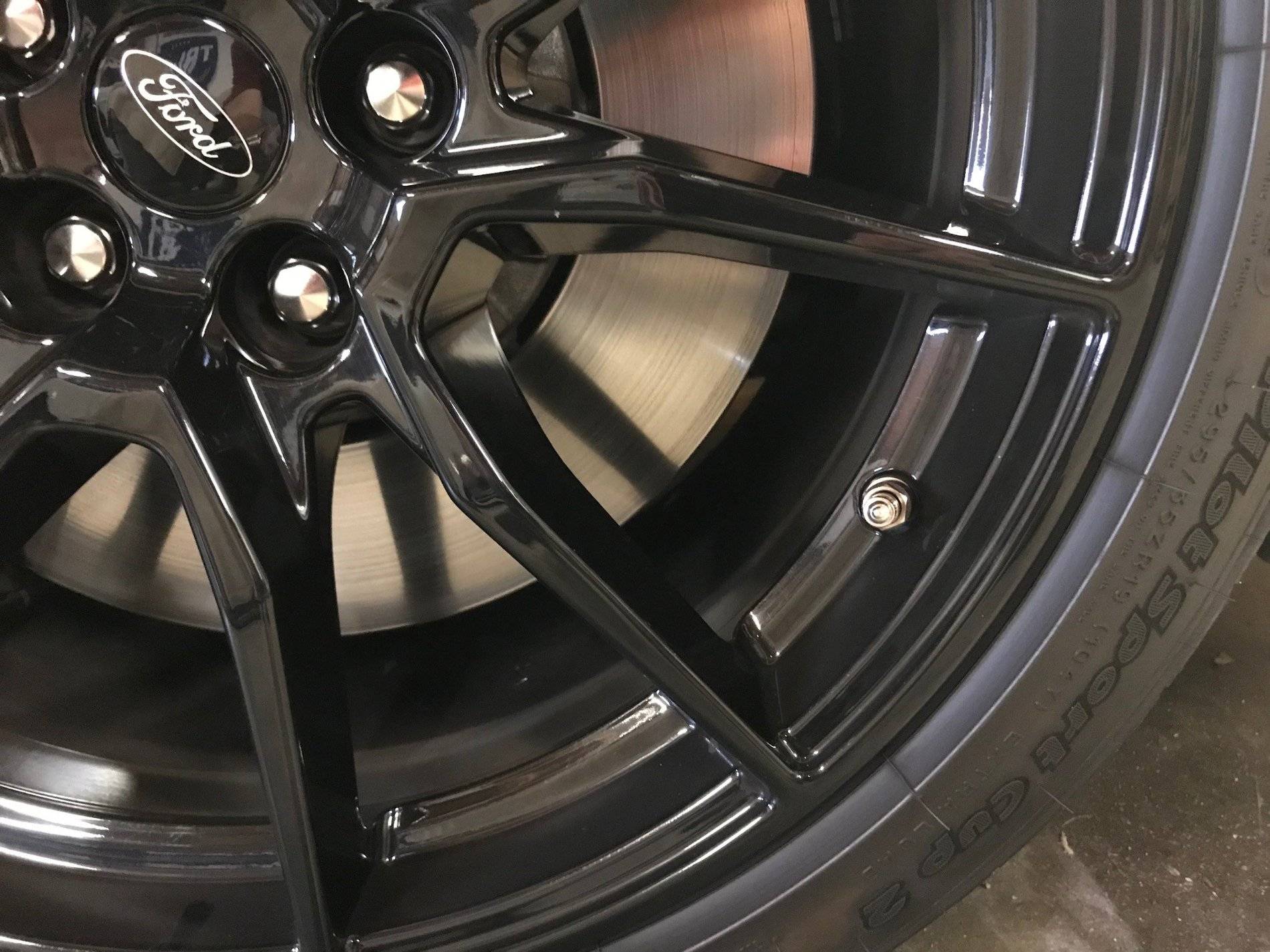

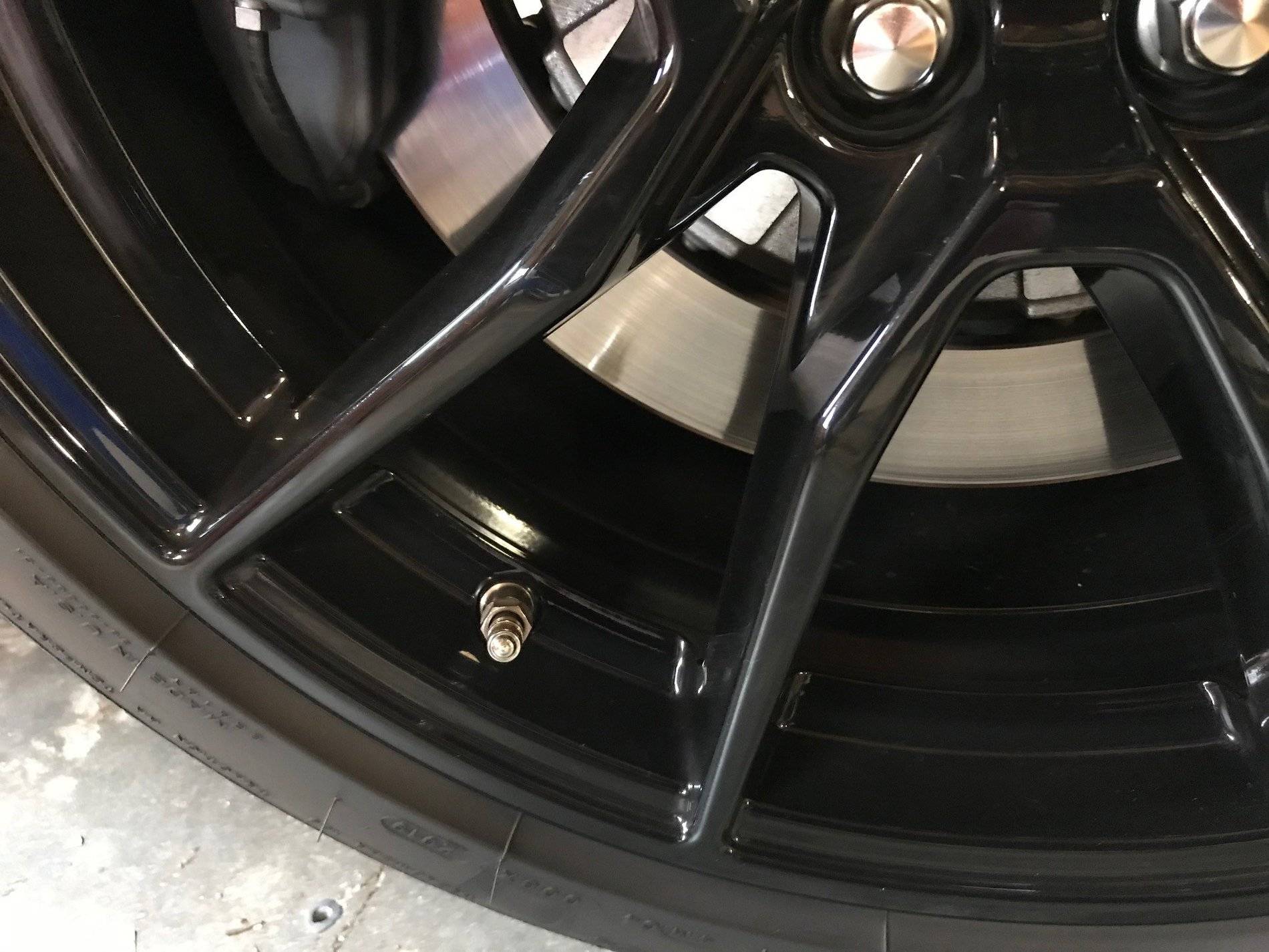

As requested George...
REAR
FRONT

They all appear between the spokes... but I see what you mean! Definitely not the same location, and very interesting...
