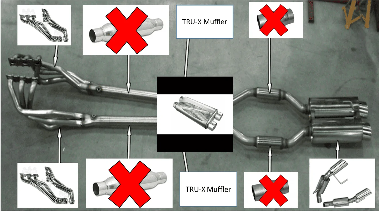

Look at the pictures I uploaded. You just buy the parts you need then go take them to an exhaust shop and have them install everything. They will fit it, weld it, and install it. The thing you need to decide is whether or not you want X-Pipe or H-Pipe. Personally, X-Pipe all day. You don't need to buy a pre-fabricated H-Pipe or X-pipe that matches to the headers. Yes, its easier to just get the headers and the matching H-pipe from say BBK that go together, but an exhaust shop will make something to fit if you go more custom and forgo the prefabricated piece. Look at like this too from a cost perspective. That H-pipe is like $250 and then the catted version is even more....the X-pipe in the picture I uploaded was $22.00. The saved money goes towards you applying Very High Temperature (VHT) paint (obtained from any AutoZone for like 10.00) and the exhaust shop welding it into your custom long-tube setup.

The picture uploaded is for reference in understanding how the x-pipe on the first setup should be welded together with the resonators.

Where does the Tru-X go into this?
You would use it instead of the fabricated x-pipe in the picture. And as already said, no need for the resonators, either.

I'm just gonna repost this picture lol....
If you go with the TRU-X then you don't need get resonators as shown in this photo. HOWEVER, if you find the exhaust to be too loud or obnoxious and not to your liking you can have the exhaust shop weld the MINI-BULLET resonators in later to clean up the sound. Just remember an system exhaust will take a few hundred miles to break in before the sound settles to what you would hear driving daily.
