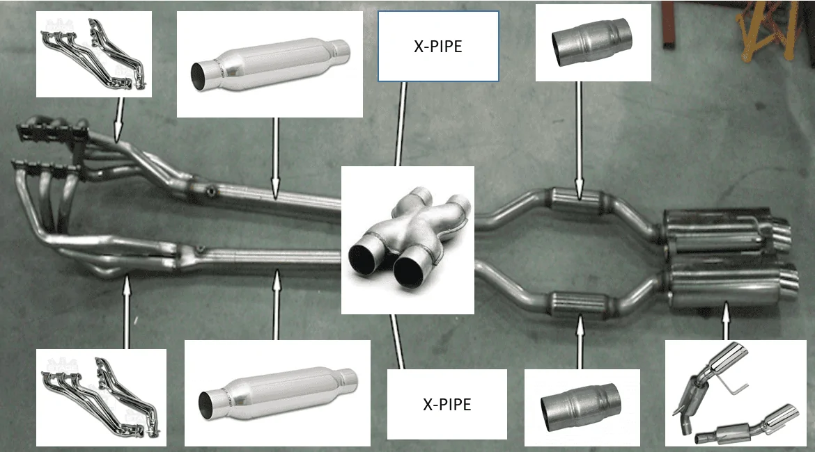

I will show this in a picture to help you visualize, give me a few it may take me some time cause I'm at work but I will show you something. Just understand what I am saying is you would buy the parts needed to this exhaust setup but it wouldn't be a complete kit. You would take it down to an exhaust shop and have them weld it and install it for you.

Stock: engine - headers - cats - pipes - resonator - pipes - muffler

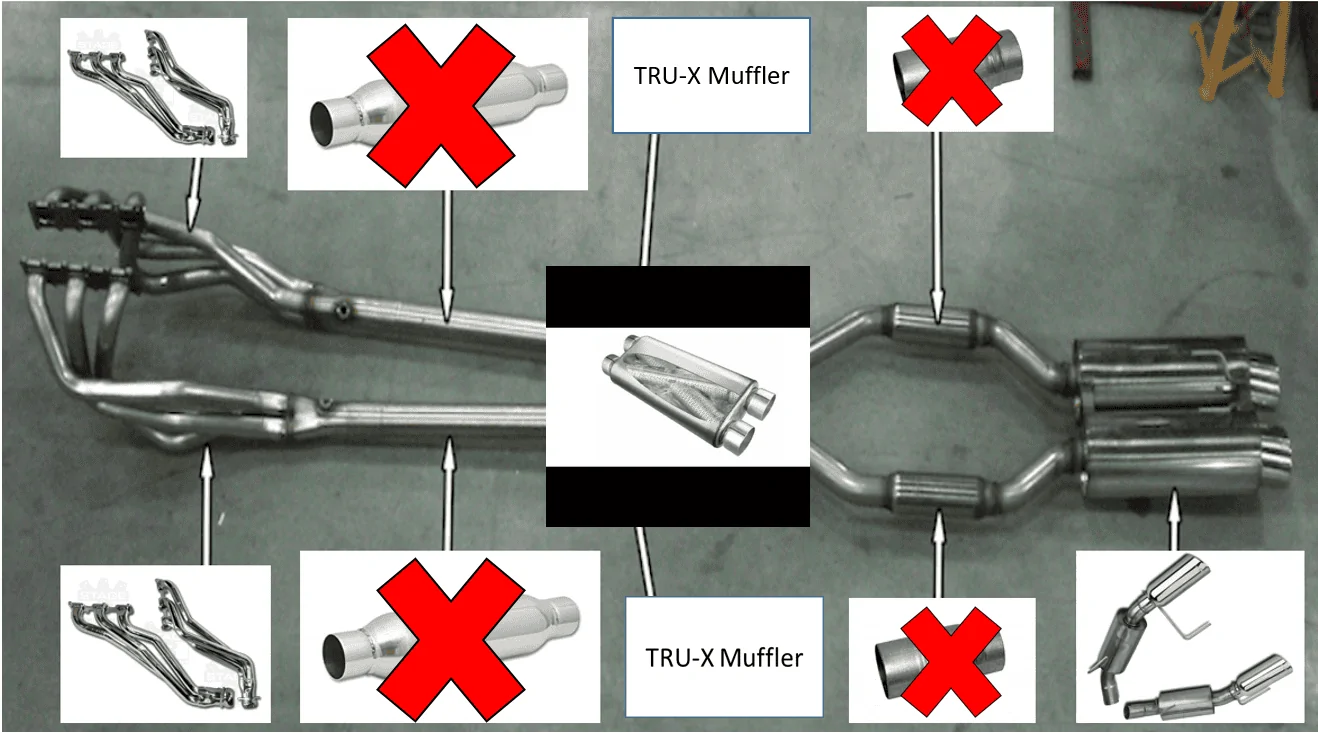

My recommendation: engine - longtubes - cat delete x or h - Magnaflow Tru-X - pipes - muffler
USMCtoARMY's: engine - longtubes - cat delete x - pipes - mid mufflers - pipes - inline resonators - pipes - muffler
If you're going catless longtubes, skip getting a catback (unless it's the Borla Touring which comes with a resonator similar to the Tru-X) because you're most likely going to end up needing to replace that part of heavily work around it anyway.

I slapped this together real quick for you to get a visual...

Those three items will complete the setup and give me no drone then? Since the Touring has a resonator? And this would all be bolt on?
I kinda wanna try to do this myself. There is a garage here in Kansas where you can rent a bay and its a professional lift and all that.
Likely wouldn't bolt on and requires lots of cutting in different areas, I'd personally pay a shop to do it and weld it instead of just clamps everywhere (they can shake loose and cause false knock issues down the road, that steals power). A regular cat back would be a bolt on affair and take an hour or two.

Here is what @Nagare was conveying.
