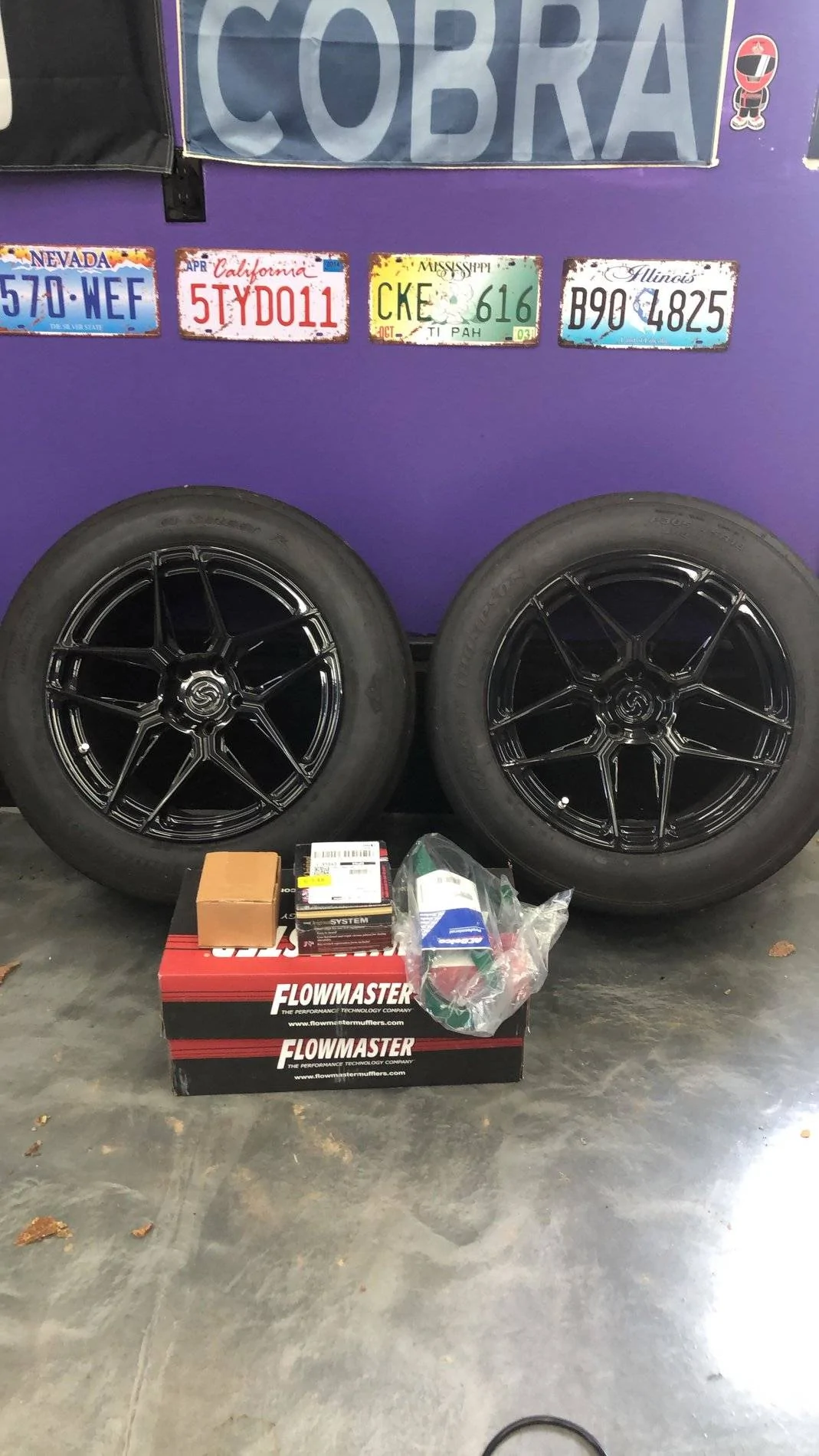

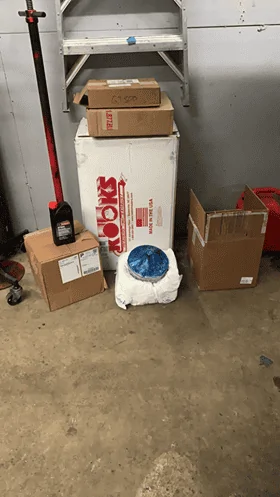

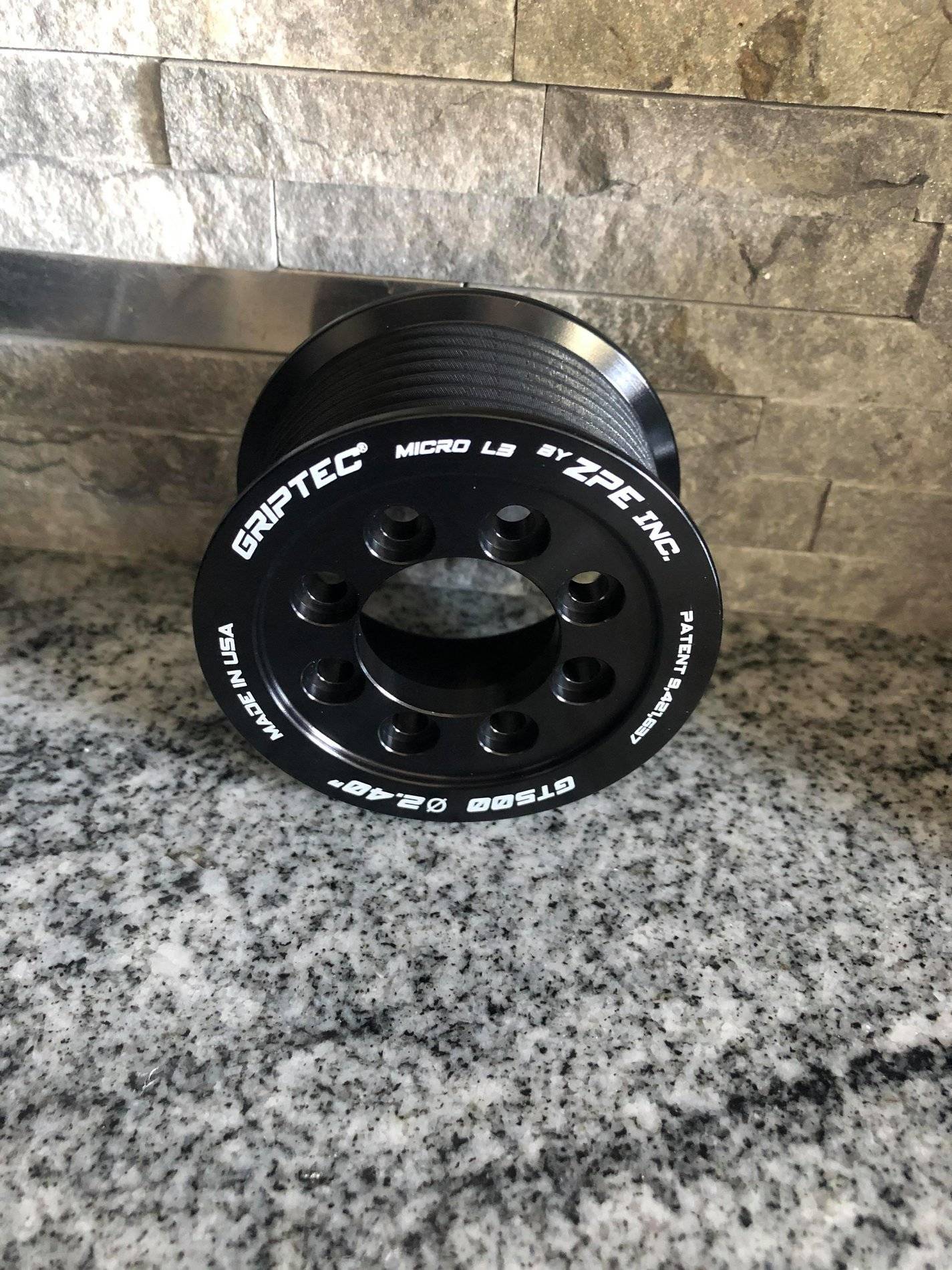

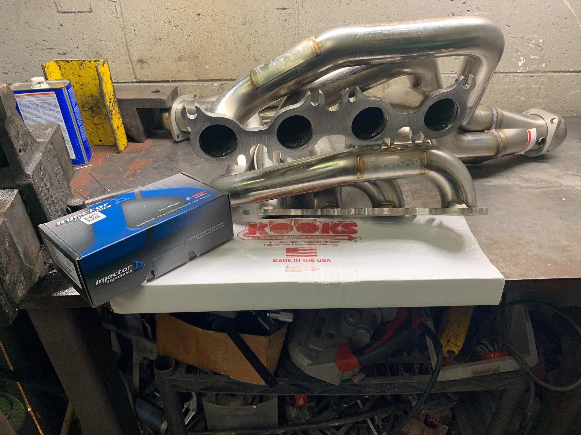

just a few of the parts that have arrived, install starts next week :)
What you see pictured are:
ID1300
Div X fuel rails
2.4 pulley
Kooks 2" headers
HD belt
Flowmaster super 44 mufflers for custom rear with OEM valves
SSP Built/Upgraded Clutches
DCT fluid
NOT PICTURED, but arriving today/tomorrow
SPE thermostat
Whipple Intercooler and Valve
Exciting times for us go fast people :)

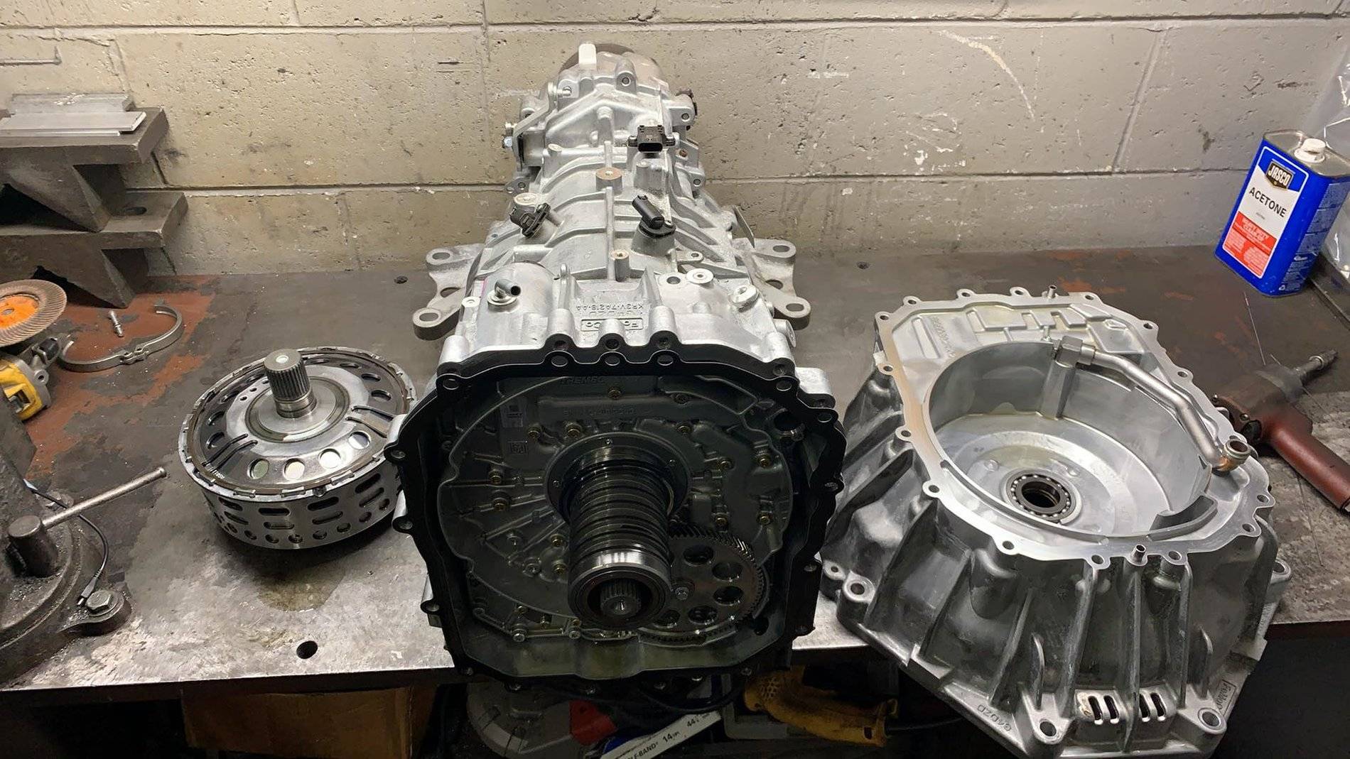

Has anyone found out what the limit is on the stock DCT yet?

VOODOO, your list is similar to mine, but haven't ordered anything yet, trying to get some driving time on it and doing cosmetics. Who is doing your tuning? 2.4? what boost is that getting you? What are you thoughts on the whipple intercooler vs vmp/vmp race intercooler, i am trying to decide which one to get. And are you porting your SC? jokerz or kong? sorry for all the questions but i plan to go down the same path.... thanks

Can you explain more on your DCT plans please?
Any insight or links to what other high power/shop cars have seen DCT wise?

Call and talk to ken at PBD. Thats the easiest way to get clear info straight from the source.
I already have the 1320junkie stg 3 port, 1320 has their race port on his own blower now so i may upgrade soon, so i cant say for sure what boost will be, as well as.im adding headers at the same time.so #'s will change.
I wont touch anything vmp, for several reasons, aside from that whipple has the greatest name.in the game, in addition to their cooler, im told.from knowledgeable people is the best balance in terms.of sizing. Best size to cool.more effectively without any reduced pressure drop etc.
Again, talk to ken, hes done more testing than anyone with these 500s, and had "other tuner" crossovers for a reason.

Step 1 is seeing how the car drives with these. The NZ company said they had a guy and they couldnt figure things out and it was just too violent on downshifts, so they went back to stock. These are SSP made in Murica and i have high hopes, since they are the o ly.ones to figure out the mclaren amd bmw dct stuff.
The plates added to mine should get us about 75ftlbs more than stock, and at 767ft lbs he said mine still looked fresh.
So from a physical standpoint, mine should.hold 850-900ftlbs at least
. Now tuning.. thats another issue.
However, PBD made 1100rwhp with a 2.2 pulley. If all of my stuff works, ie clutches are driveable, ill be sending my car down to PBD again and let him pulley down and fuel system as far as he wants to go, and id like to see 1200rwhp on E.. thats all best case scenario though.

I had no idea it was getting this real. Have not seen anyone go this deep into their 500 yet.
