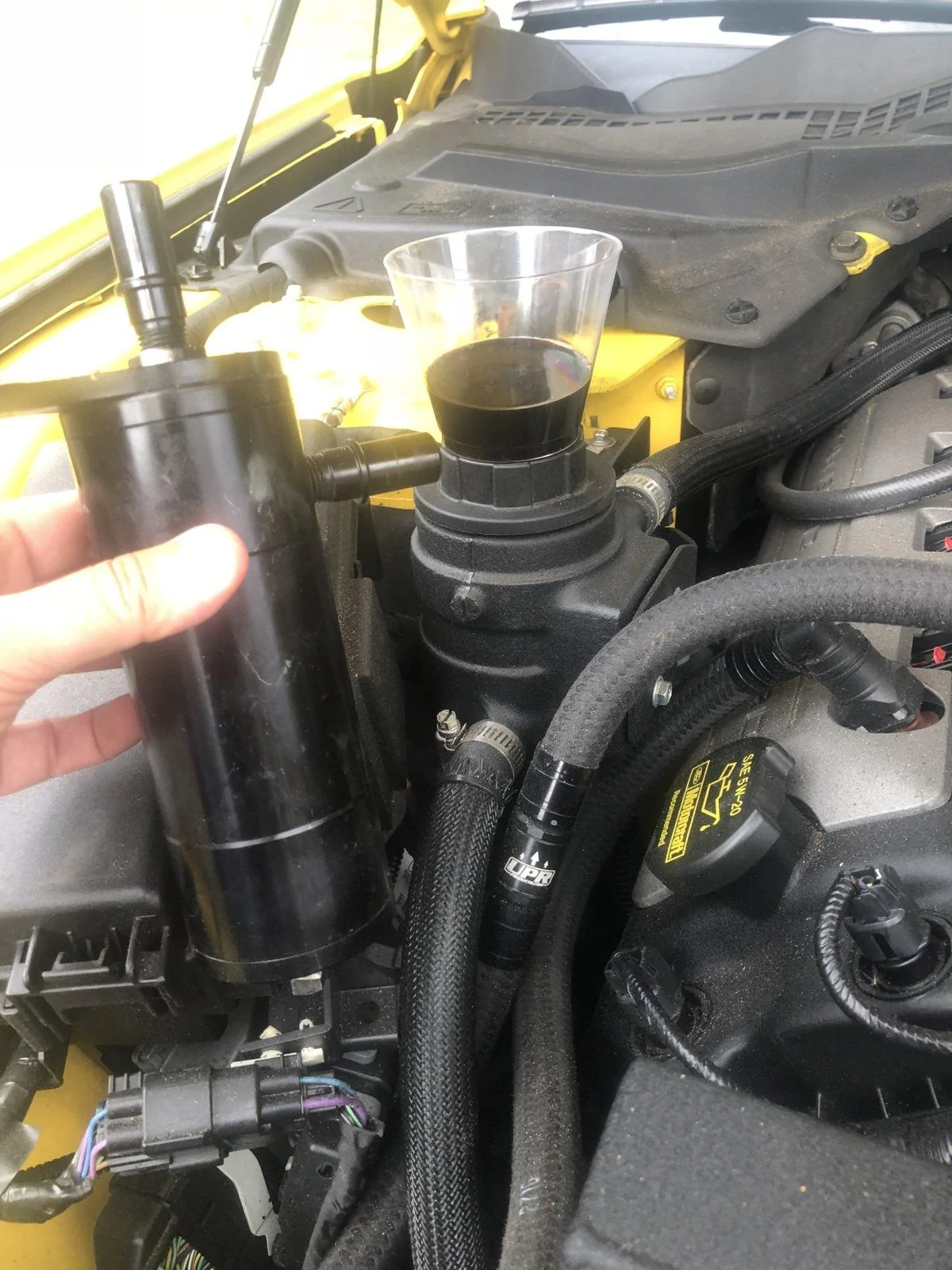

I just emptied my UPR Procharger specific catch can after about 2,000 miles of driving. I was extremely surprised to find less than 1 oz of oil/condensation in there. Curious if anyone else has had similar results since I keep reading horror stories of how much these cars benefit from catch cans. For reference, my setup is as follows:
2018 GT Premium PP, A10
P1X Procharger (8 psi)
ID1050x
NGK6510's
Factory active exhaust with Magnaflow resonator

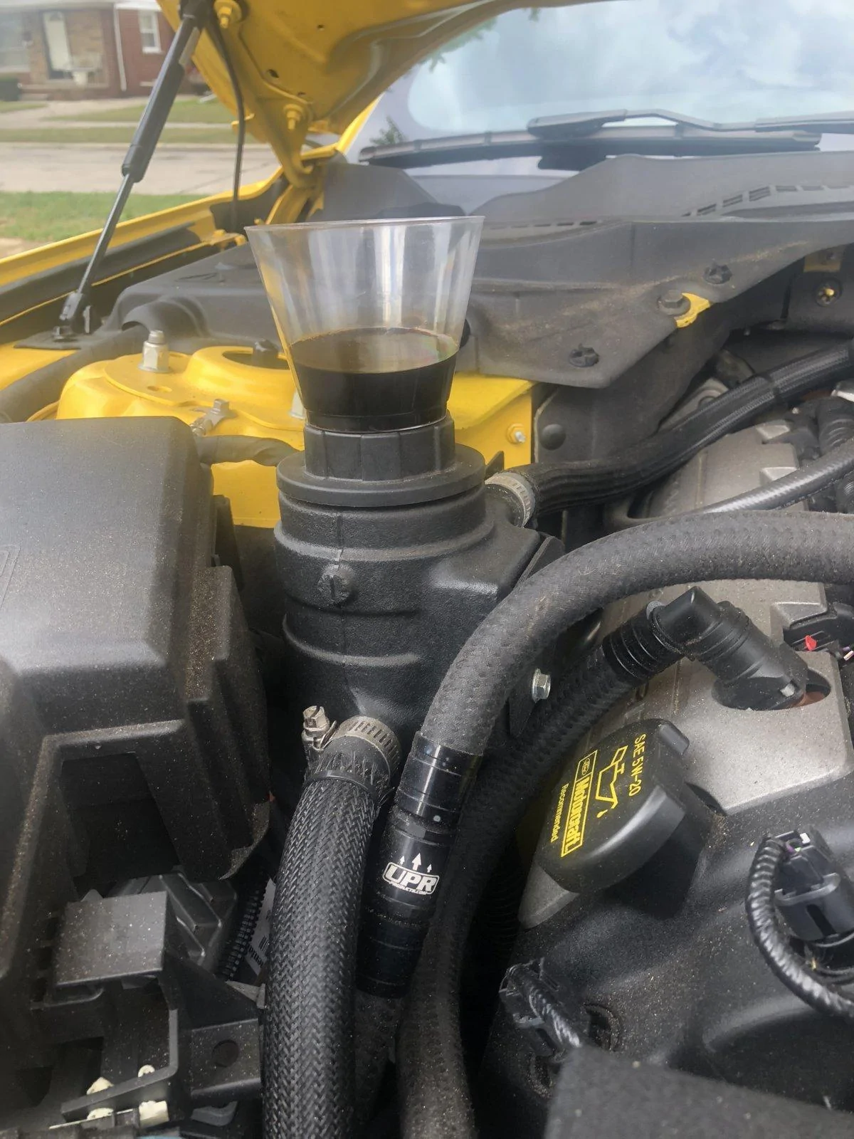

A little update. I just changed the oil after about 4,000 miles. Re-checked the UPR catch can and actually found about 2 oz. of oil/condensation in there (about 800 miles since I last checked it). The temps here in Arizona have dropped dramatically in the past few weeks and has been rainy. I think alh395's theory of cooler/damp weather playing a role is good one.
I have the nose of the car apart again so I can weld my Tial BOV on the driver side intercooler tank and weld bungs on my charge tube for the meth system. I was extremely pleased not to find even a drop of oil anywhere in charge tubes or intercooler. The UPR Procharger specific catch can must be doing an ok job. The car has just shy of 5,000 miles, nearly 4,000 of which have been with the Procharger installed.
