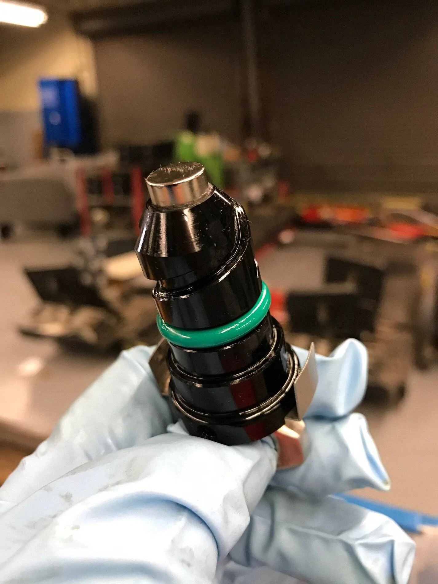

What's Dat?
Some metal shavings on top of magnet. I get about same amount or a bit more when I drive in high RPM when I change oil 3,000 miles

No, I mean what are you holding in your hand?
That is the oil plug I posted bout, well a version of it anyway. The UPR oil plug has a magnet on the bottom and twists in like the OEM. It has a valve that you can open and close to get oil flow without removing the plug totally. It also allows for a 1/2" tube to be attached to direct the oil where you want it without a mess.
