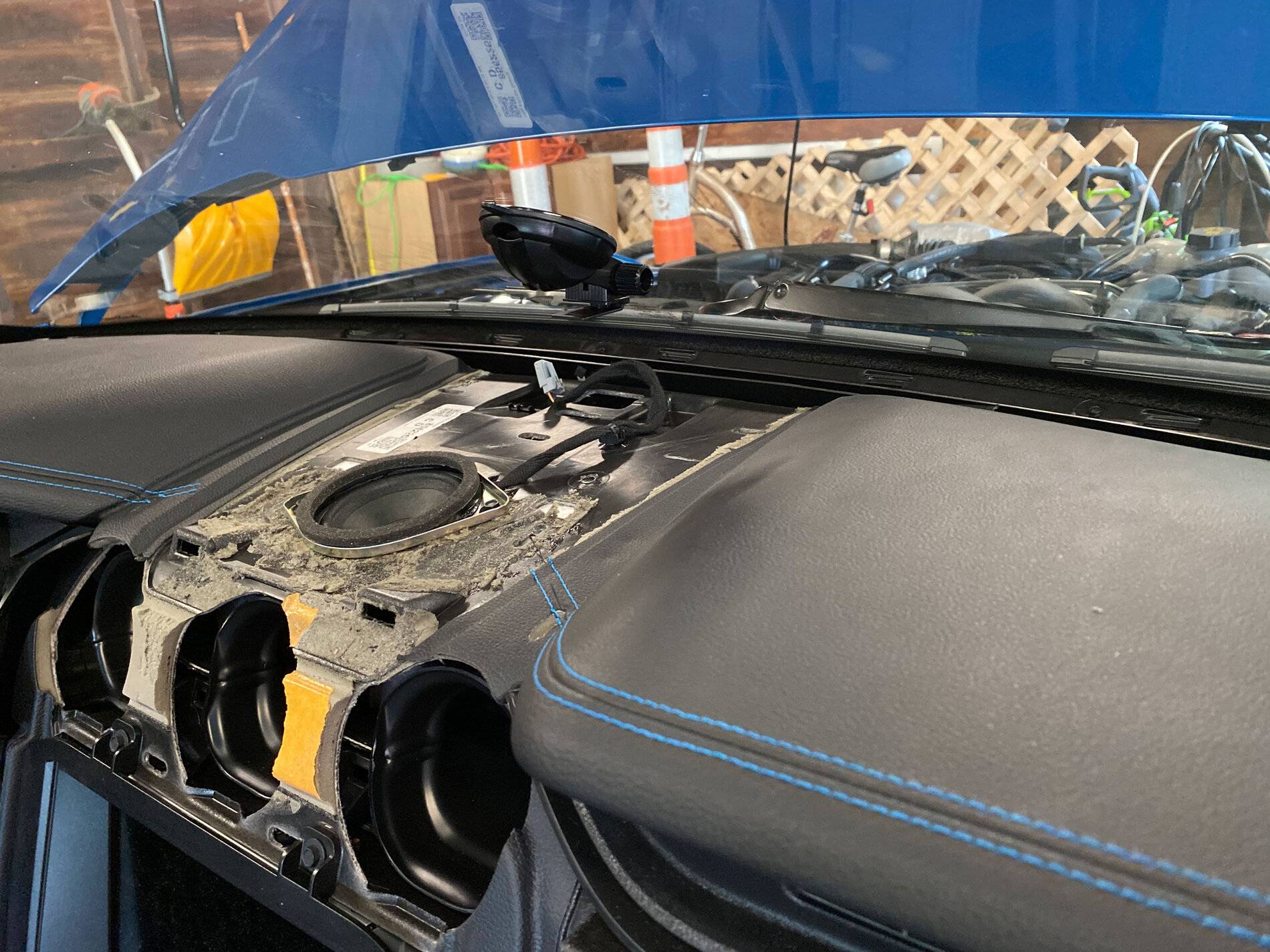

Do you have to take apart the dash to do this? I am assuming yes?

You only have to remove the front silver panel that goes around your vents + the little middle vent cover on the dash right above it.
If you get the plastic prying tools for trim from amazon for like $8 for a set, you will have no issues if you gently pry and slowly take your time. Careful to not let any clips fall into the dash as you remove it. It's easier than it sounds, there are some great tutorials on YouTube showing it.
I just recommend the trim tools like these https://www.amazon.com/MICTUNING-Re...rim+Panel+Removal+Tools&qid=1622833869&sr=8-7

Here is a photo for reference.

If you have a PP1 car with the dash gauges, you don't even need to remove the top dash grille. Reach in and unplug the speaker.

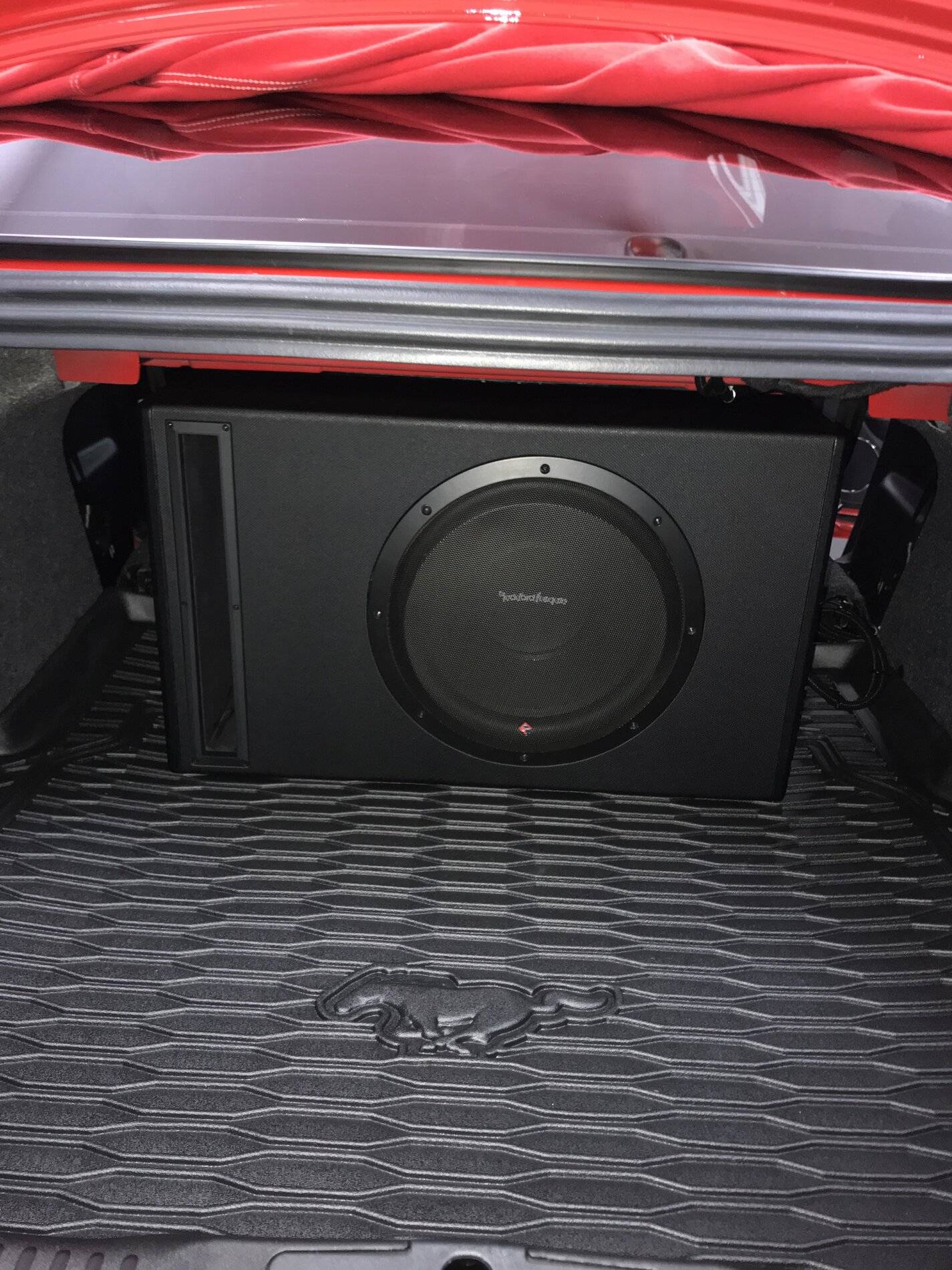

Rockford fosgate box 12 inch make all The difference ,simple installation ,And my base systeme is 9 speaker good for me!
