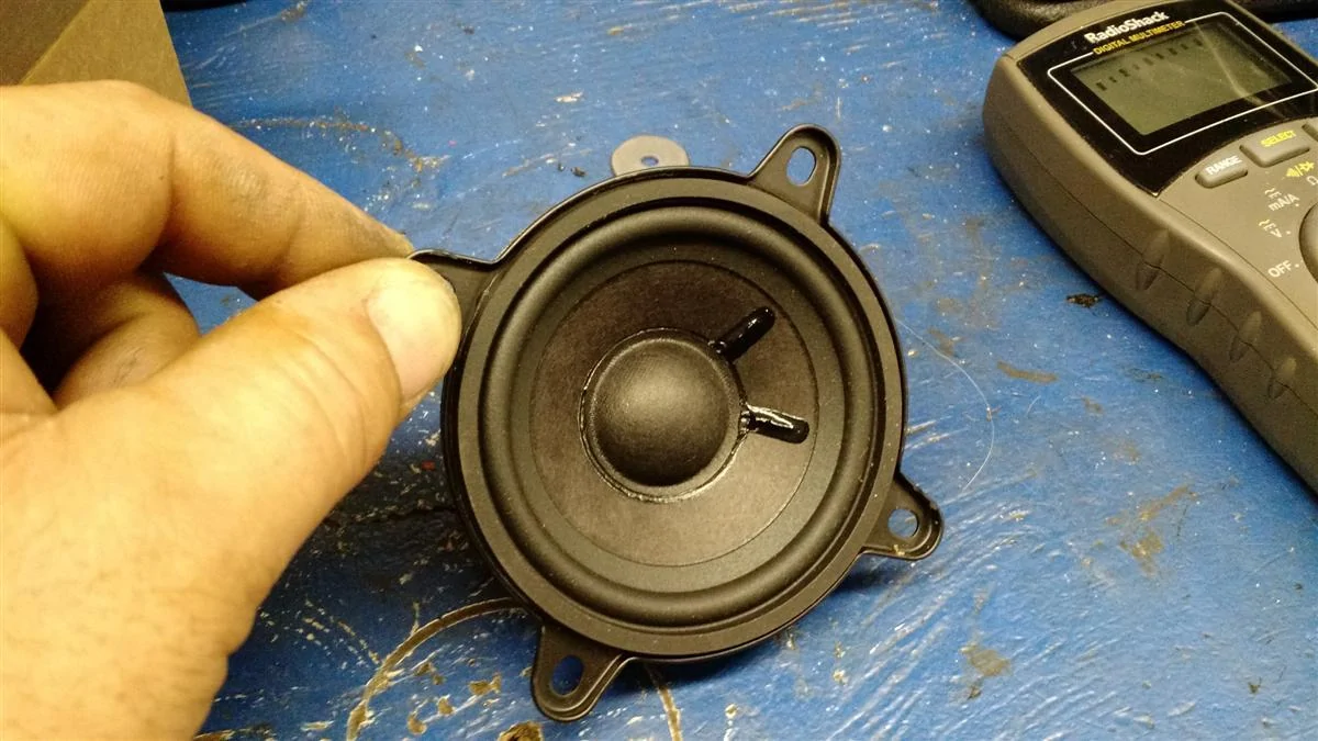

I have used the faital pro speakers from parts express with great success.

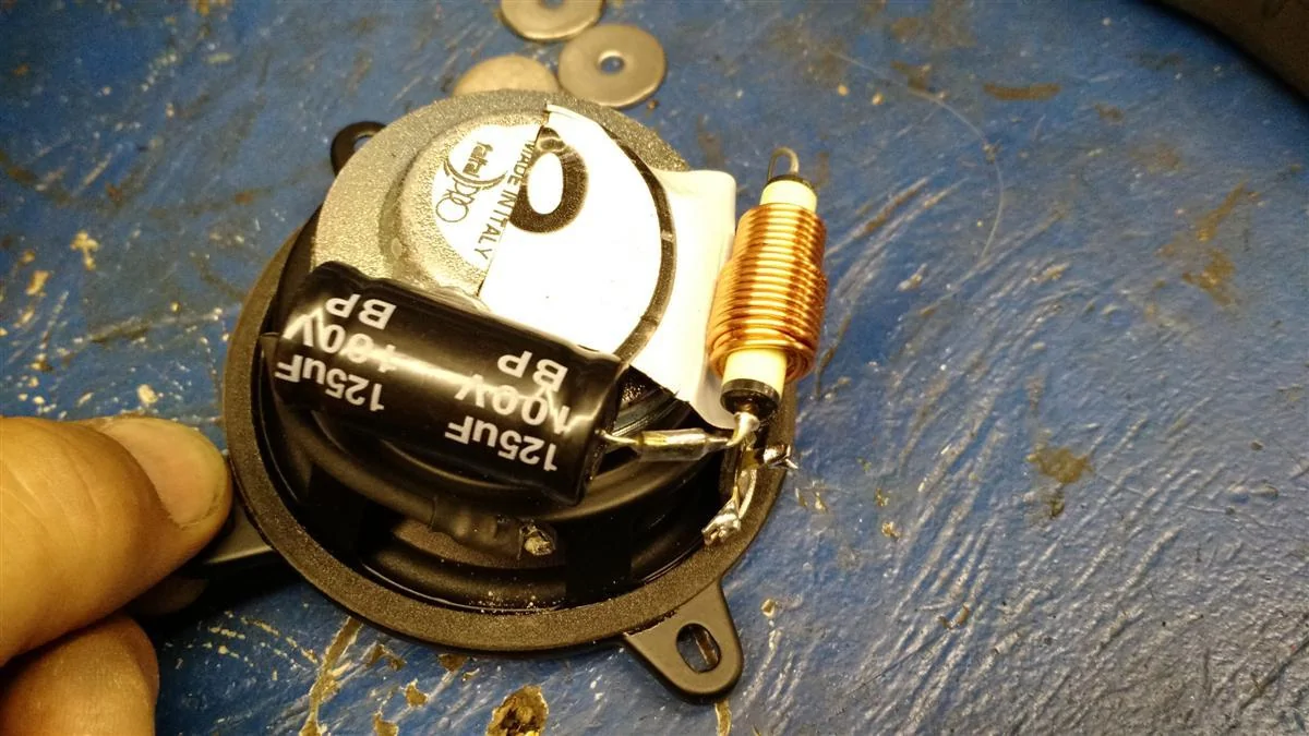

I band-passed them with a simple cap and coil to give them a range of 400hz-6000hz if I remember.
They sounded pretty good,but then I swapped out to a full Hertz Mille set.

Just curious, are those "parts-express" speakers any good for having such low prices??
They arent Scanspeak great, but they are pretty darn good for our purposes.
