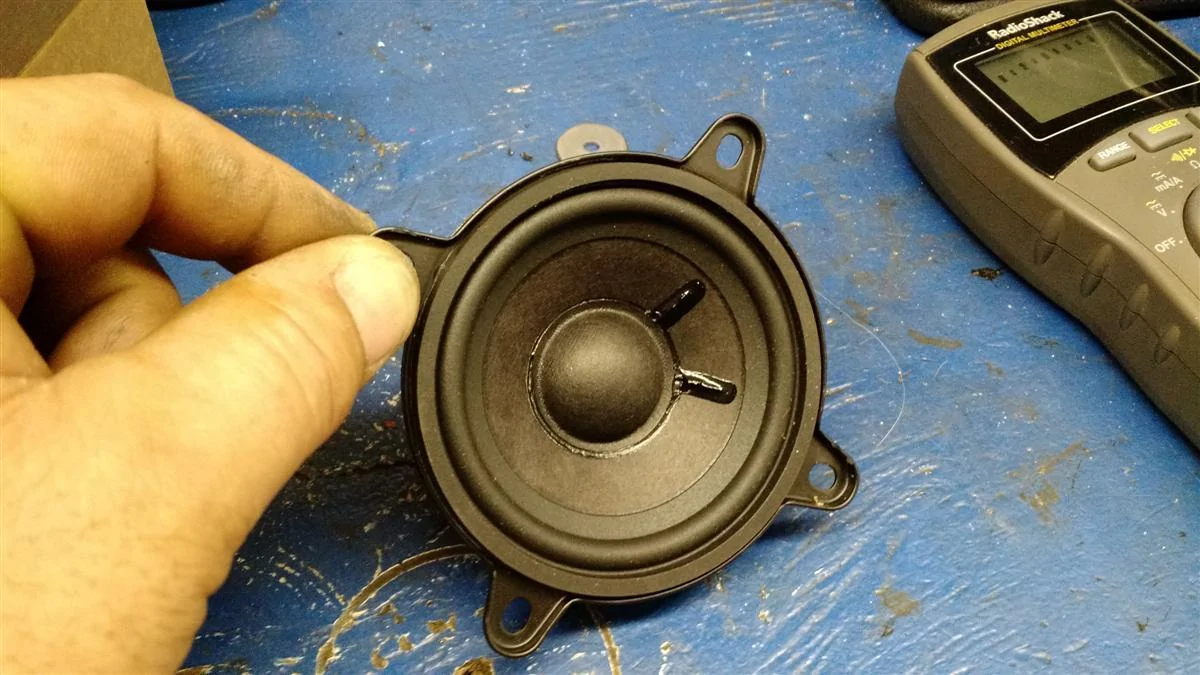

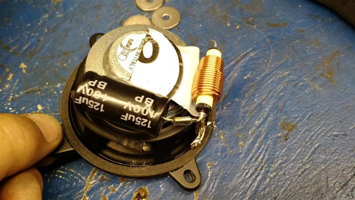

Before I put the Hertz Mille in,I was using these faital pro's from parts express.
I bandpassed them from 350hz to 5000hz if I remember.
They sound pretty good for a $35 speaker.

Often you can see the wire going to the tweeter and you can cut it but you'll probably change the ohm rating of the coaxial then. Buy a dedicated midrange from parts express.

The Faital Pro mentioned above by Racemaster would be a good choice. Other good choices are Tang Band, Peerless/Tymphany and Dayton. Check out this link to Parts Express;
http://www.parts-express.com/cat/mi...eca:matches(.,"P_Searchable","1")]&PortalID=1
The factory midranges are 1.5" deep and there isn't much room between their surround and the door card, so try to find something that is close to that depth.
