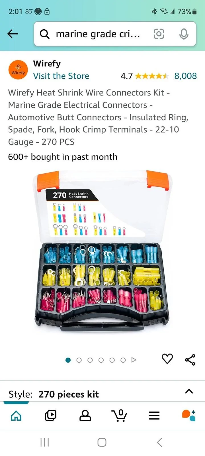

Luca1290 linked an example of the Ford replacement connector.
Here's a screen shot of a connector kit from Amazon. There are many on Amazon, just type in "marine grade crimp connectors" and be sure they have the adhesive lined heat shrink insulation.
Oh, and be sure to have the correct crimp tool. Bare connectors use a different tool from insulated ones.

Thank you, much appreciated.

Would you say these that I bought previously are trash?
https://www.amazon.com/dp/B073RMRCC3?psc=1&ref=ppx_yo2ov_dt_b_product_details
