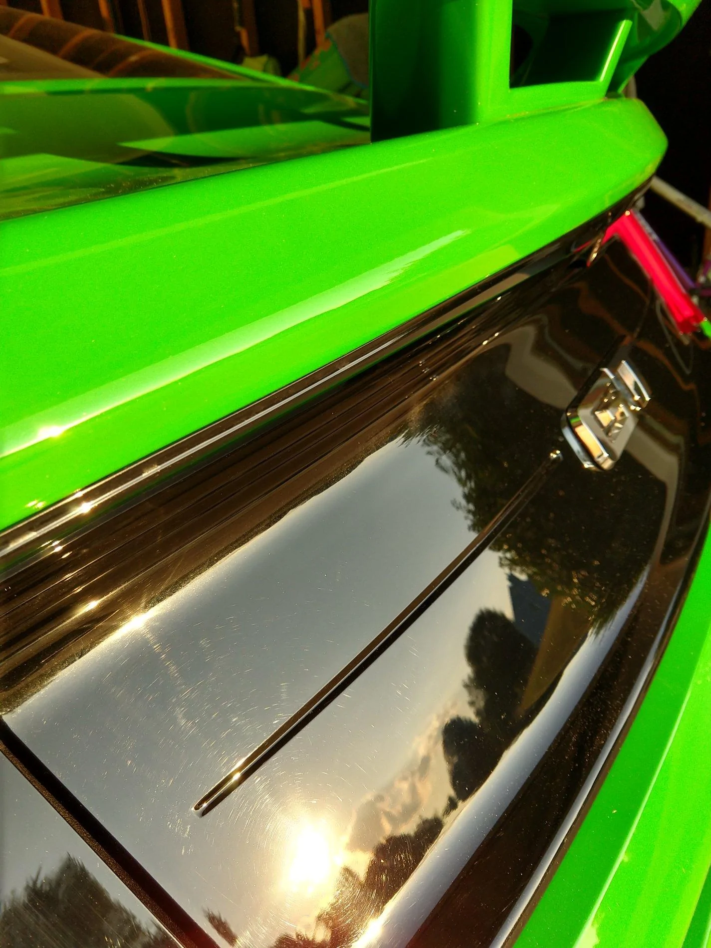

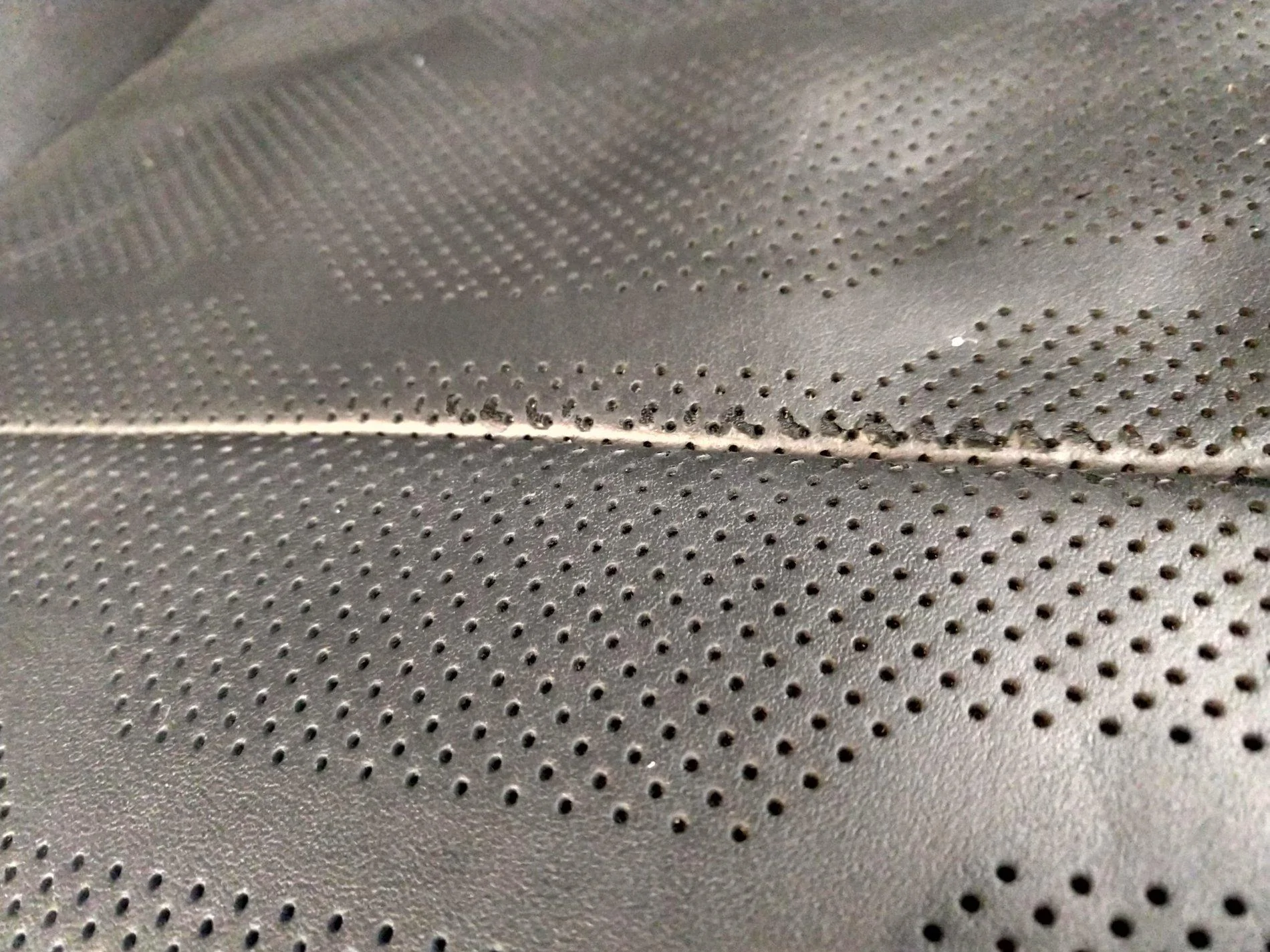

I have had my 2019 GT premium PP1 for a little over 9 months now, and I couldn't be happier with it. I have however noticed two issues though that I would like to see if Ford will fix since the car is this new. The first is a place on the drivers seat about 3 inches long where the perforation seems to be coming apart. I feel there is no way this should be happening this soon when the car hasn't quite reached 13,000 miles yet. I have owned 7 Mustangs prior to this, and I have never seen a seat show wear this early. The second is the good ole piano black rear deck panel. It has some normal spider webbing even though I try and be careful knowing how finicky this piece is. The problem though is at the top where it looks like it has changed colors or faded in several spots. Again, this shouldn't be happening on a new car in my opinion. I plan to carry it in tomorrow to see what they will do.What do you guys think my chances are of getting these items replaced?

Bring it in and ask them to change the seat under your bumper to bumper warranty. Rather do it now then wish you did it later.

Go to the source and ask. Take the car in and tell them to look at it.

Here you go, there is a Ford TSB regarding the 2018 rear decklid panel. They’ll buff it out, but it’s going to reoccur.
https://www.mustang6g.com/forums/th...550-scratches-on-black-trunklid-panel.112229/
As for the seats, here is the Ford GSB G0000129 concerning what is warrantable and not for Leather seats. From your pic it’s hard to say if it is like anything in the GSB; take it to the Dealer have them look at it and tell them to take very good pics for when they submit the warranty claim to Ford.
