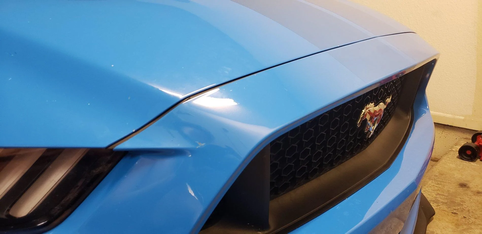

Bumping this too. My car was in for service and they didn't really do much. The gap between the top of the bumper cover and hood is much too large. May try this.

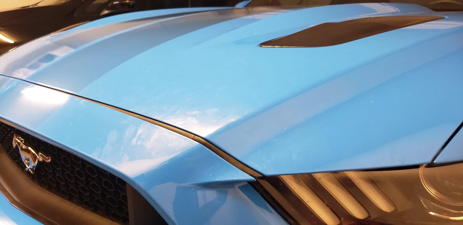

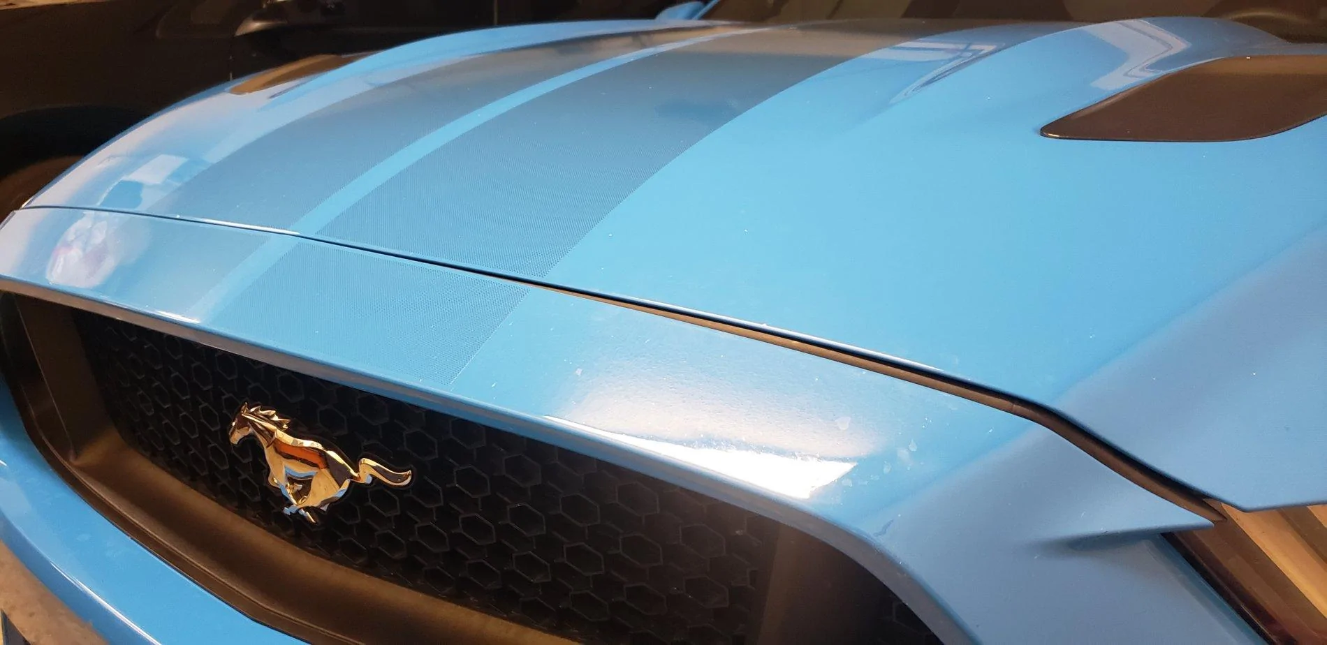

Thus, the outside 5.5mm-head screws took .235" of shimming, the second inboard set took .180", and the third inboard set .060". I'm very happy with the results.
Looks a lot better.
