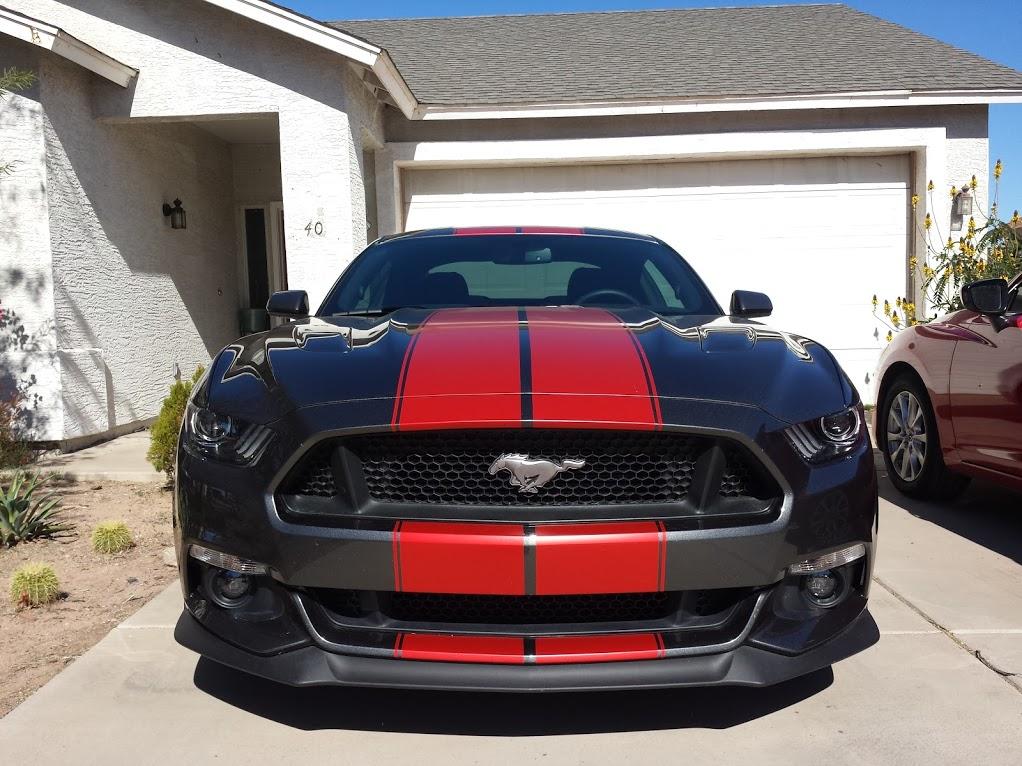

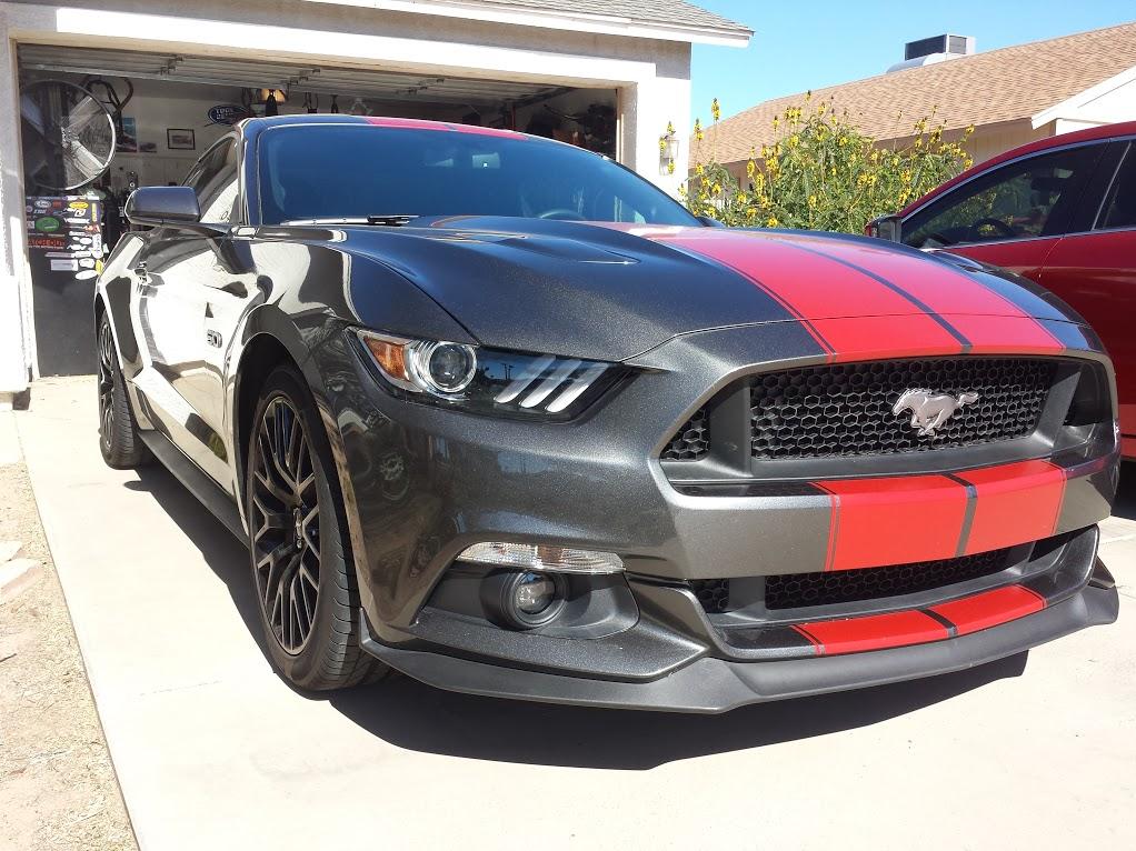

Okay, here are some better photos.
Before:
After:
After:
[MENTION=16819]Roh92cp[/MENTION]:
Thanks for the write-up. This took about half an hour to do, moving slowly and deliberately in the dark.
Absolutely worth it. The front of the car no longer looks shameful.
If anyone's interested, when I refer to "thick" washers I mean .060" and when I say "thin" washers I mean .035".
Thus, the outside 5.5mm-head screws took .235" of shimming, the second inboard set took .180", and the third inboard set .060". I'm very happy with the results.

Thanks for the updated picture. Wow it really looks great now, mine to was way of like your before photo. Everytime I looked at the car which was many, that hood gap haunted me. Now it's gone.
The front hood side gaps are the most visible and annoying of all the misaligned parts on the car. Great job man:thumbsup:
