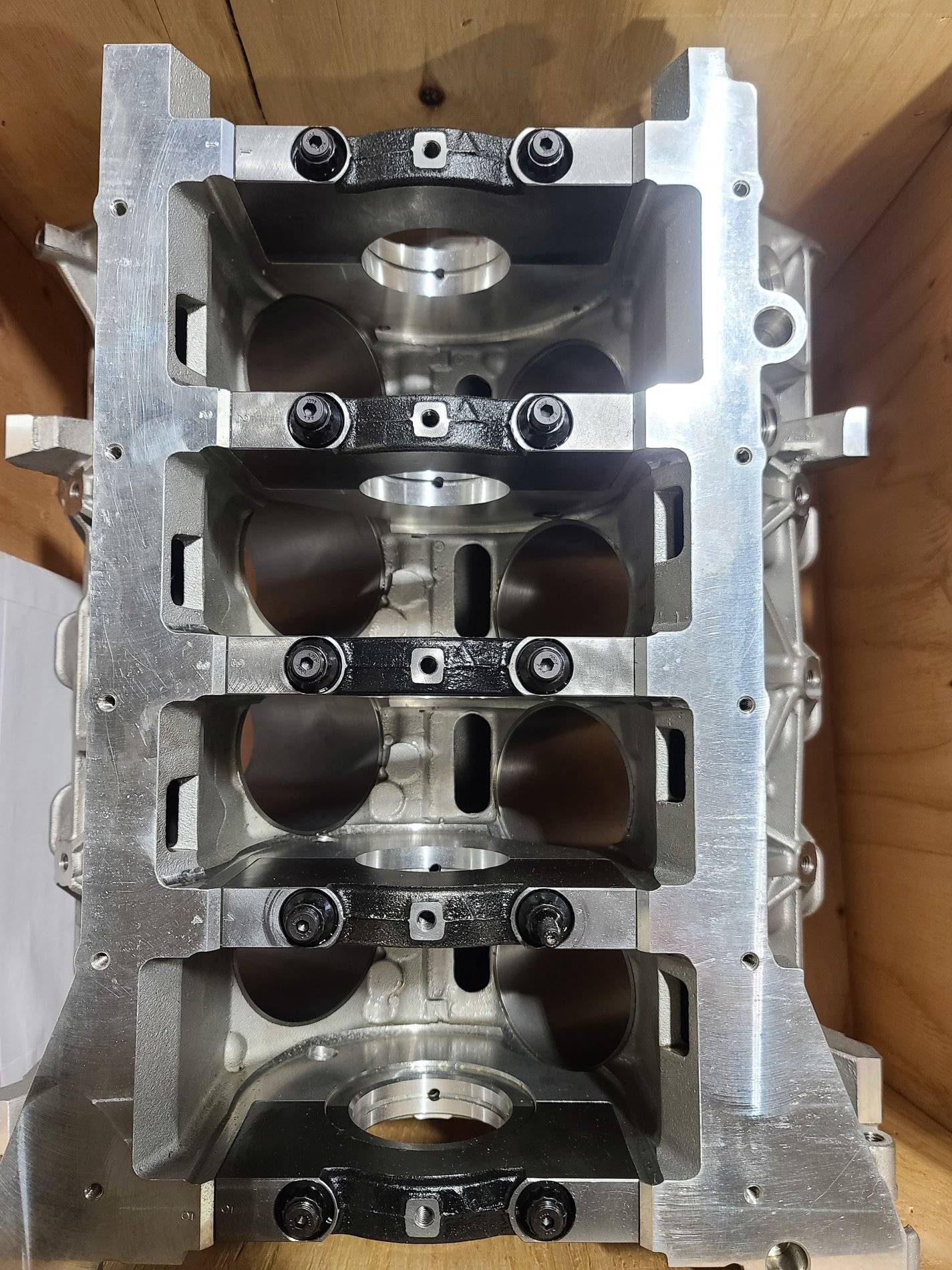

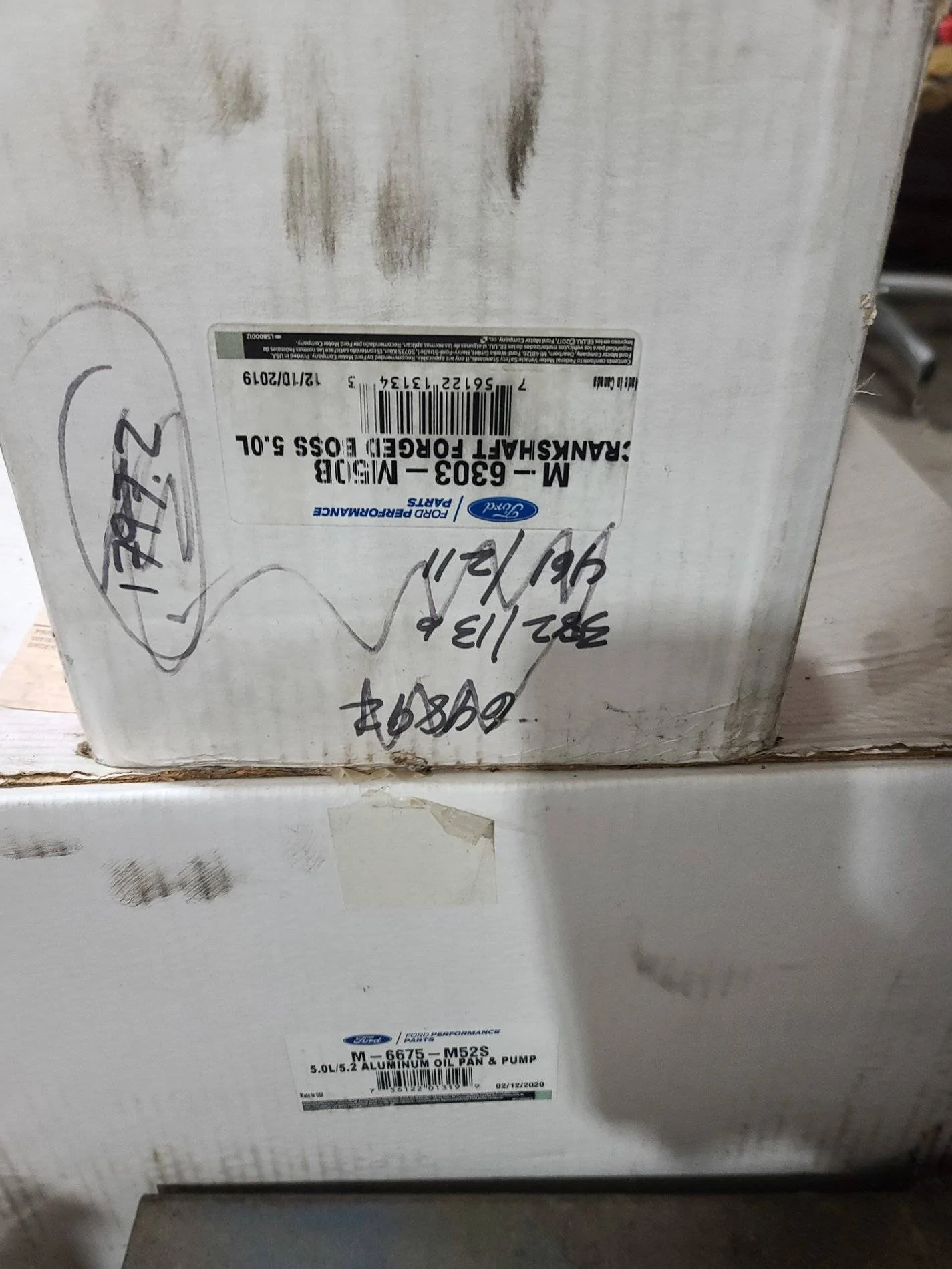

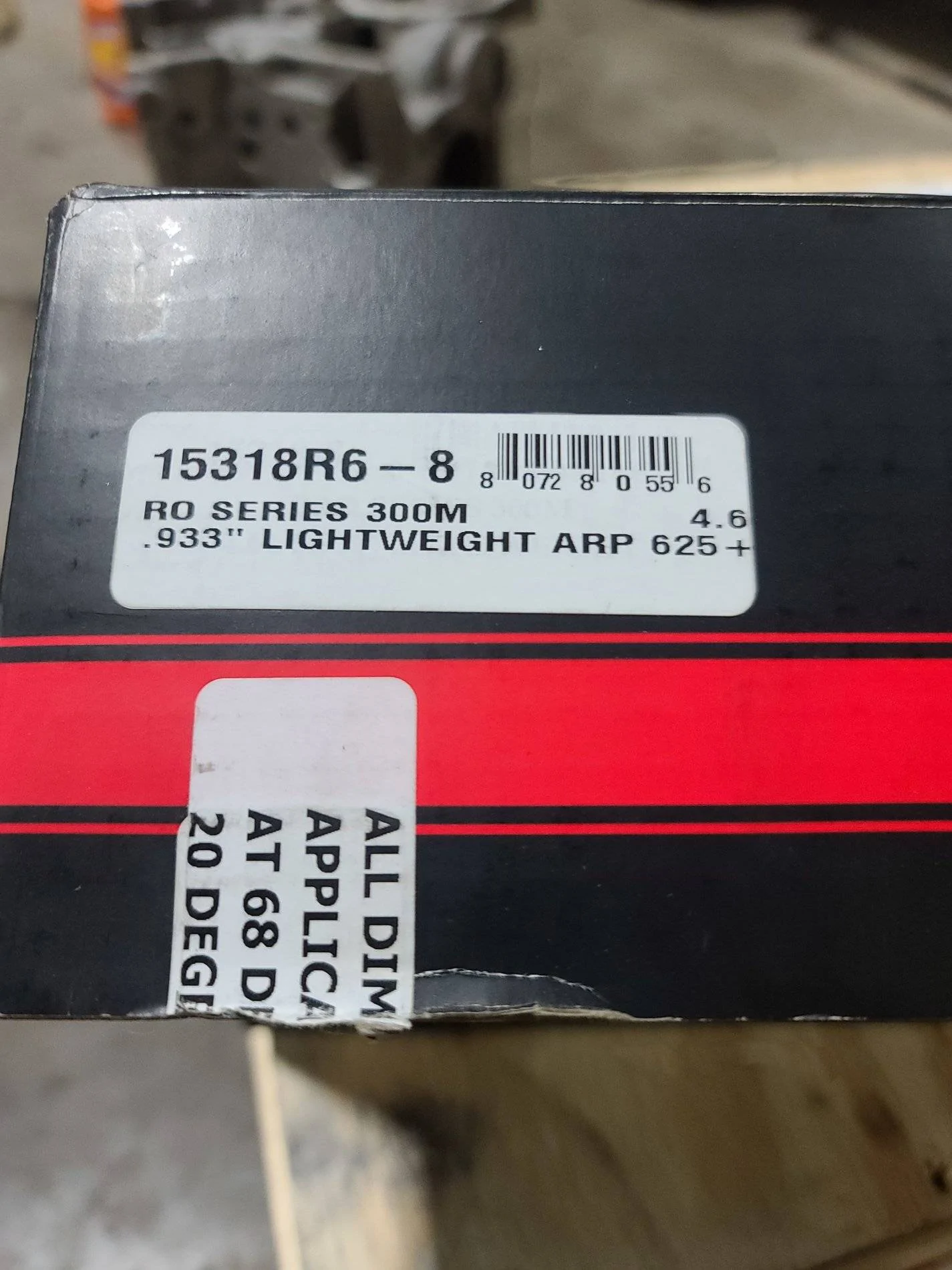

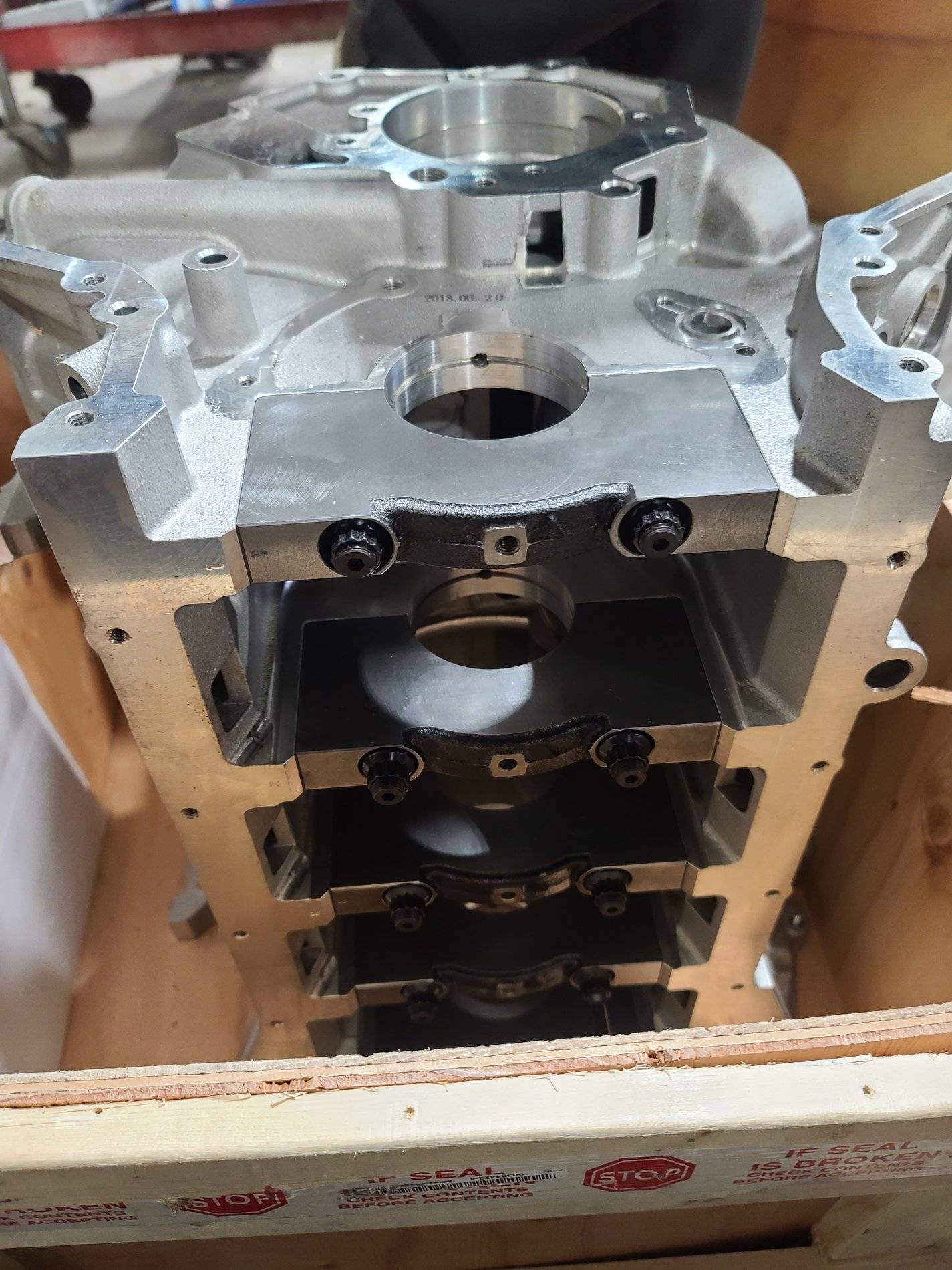

slowly getting parts together for a twin 64/66 build
got my block in today already have a crank and a set of rods am looking for the best piston to go into it either a manley or diamond what are you guys running or recommend
block is a bear block motors 5.0 ultra mmr race prepped crank manley billet I beams with +625 bolts will be running gen 2 gt500 heads
