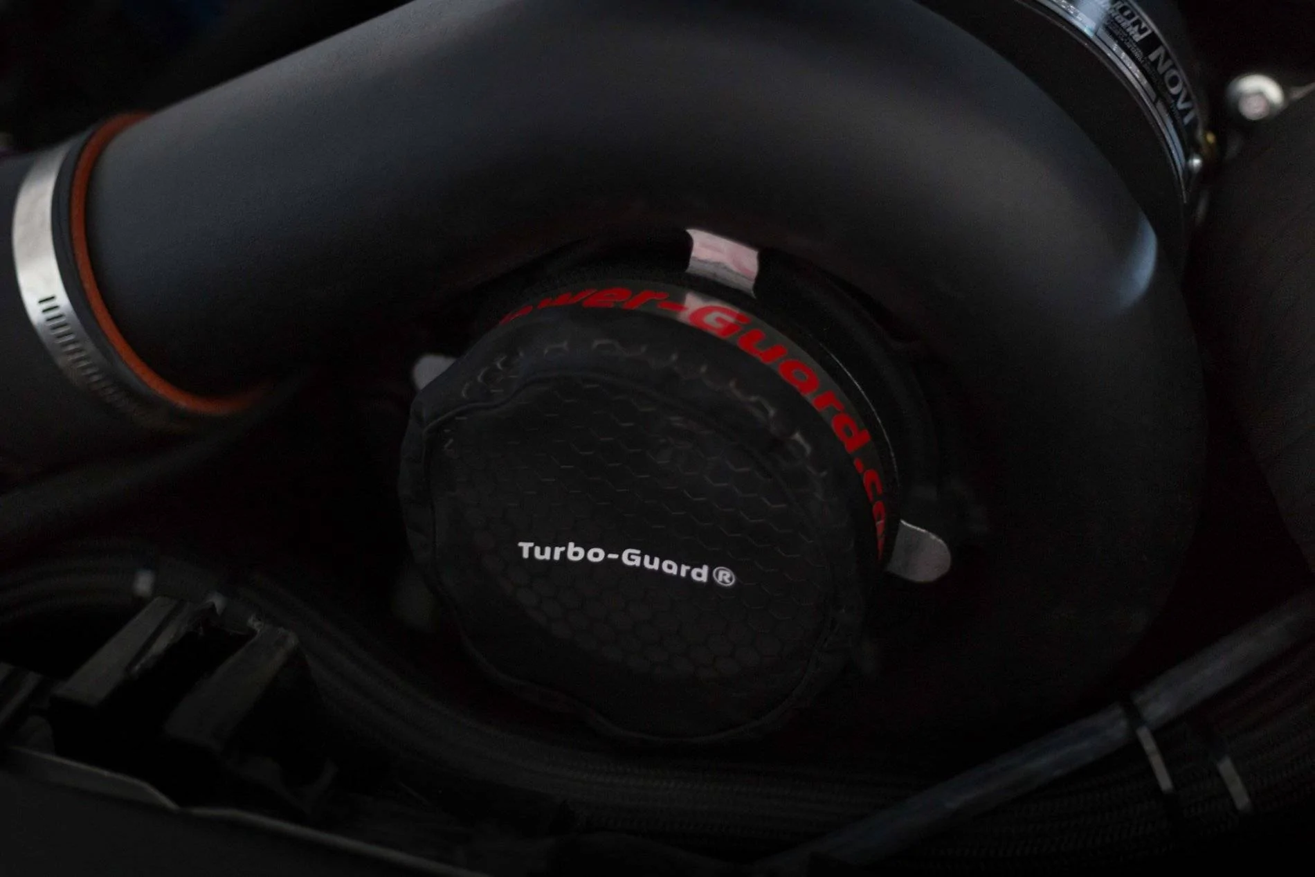

Was chasing a boost leak or belt slip for a couple weeks after installing the transmission back because I was only getting 6 pounds of boost vs 12. After pressure and smoke test a couple different ways, and changing through various belt set ups, we found the issue to be the Turbo Guard PRE-FILTER (photo below) tested with two different Paxton set ups and we both were missing half the boost. As soon as we took the filter off BOOM! Full boost.
Turbo Guard Pre-Filter
