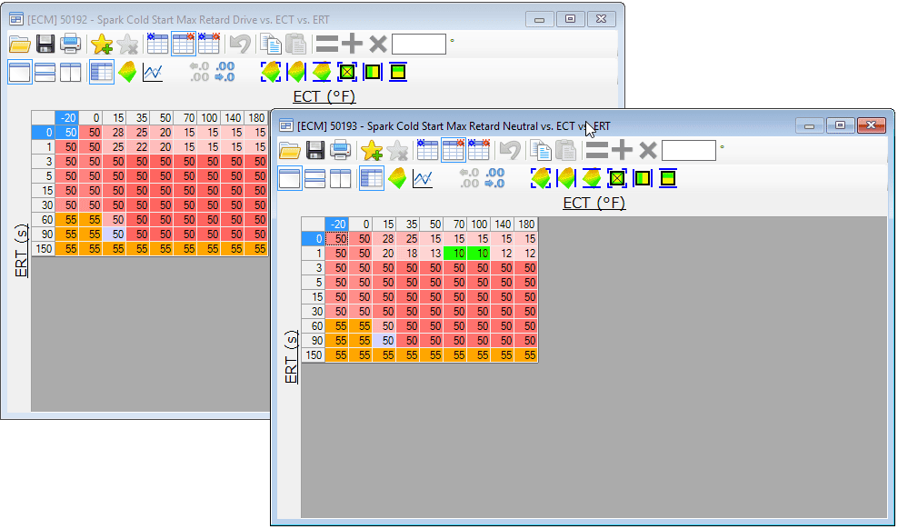

What you want to do is modify your Cold start retard. On a normal tune it's usually going to retard you to 0* of spark advance until after 60 seconds of run time.
Change these value to what I attached below and the car will no longer retard the timing, it will instead run whatever you normal idle spark advance is. In my case it's 17* of advance. For you it's whatever you set your idle advance to be.
Unfortunately we don't have base idle spark on the 15 and up at least my 16 doesn't have base idle spark so I cannot change it. I had those modified similar to that and it was great on 93 but ever since full E-85 it would slightly stumble 2-3 seconds after cold start because it was commanding way too much spark (30* or so in fact) I had to retard it back to stock there which is around 15* to get it smooth again.
Yeah I did notice that table was missing, that screen shot is from a 15 file I had around. The 50 is only the ceiling for start up.
To the OP, if you do have this issue on start up, you can set the retrard to 15* for the first 60 seconds and then set it to 50 for the rest of the table
