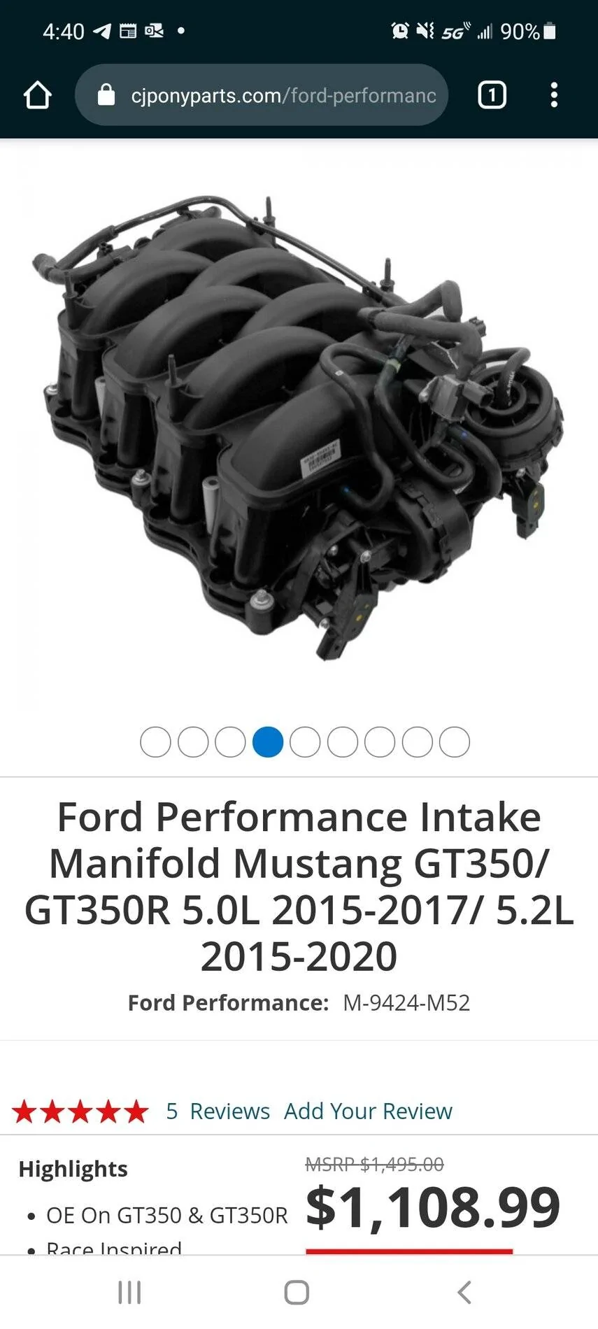

I happen to have the gt350 intake on my Gen 2 and it in fact ships from Ford with imrc pre installed and vac lines routed and they plug right in to the oem harness. See my attached pic

When did they change it? When it first came out and sold over the counter, it didn't have them.
BTW I just looked and the price has come down drastically, LMR lists it for 629, where as American Muscle still wants over 1K for it.

I dunno if or when they changed it. As far as cost if you go to your local Ford dealer and get the oem version which is the exact same as the Ford racing version you can get a great deal. I got mine for $520 directly from my local Ford dealer

This is great info Mdtaylorjr, much appreciated. Do you happen to know the part number for the OEM version? And does it come with the throttle body?

It doesn't come with the throttle body but it did come complete with all gaskets and imrcs installed. I already had the TB and Cai from a used pp2 I bought on ebay. The oem part # is gr3z-9424-c I believe
